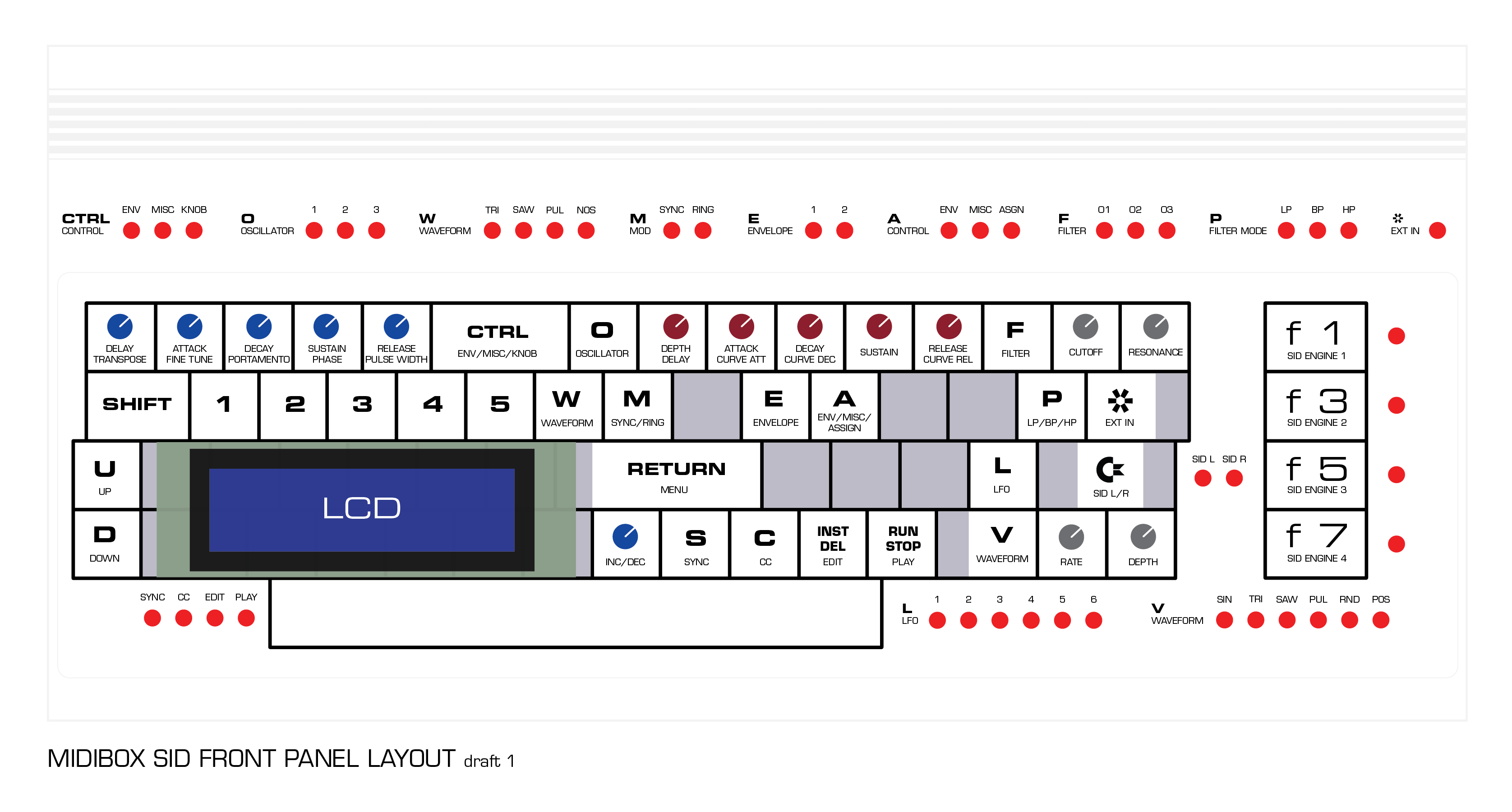

My MIDIBOX SID build is using the MB-6582 main board and a custom control surface. I’m building it inside a VIC-20 case and the control surface is built on a modified keyboard using the keys as buttons. The encoders I got push up through the holes in the keyboard tray. Due to a lack of room I’m not including the matrix. LEDs are placed around the keyboard area and my attached layout shows where I’m thinking of putting them.
I went through a bunch of different layout ideas and ultimately went with whats attached. I tried to keep knobs near the edges so i can put labels right next to them. My goal is to have the chosen keycaps represent the button functions, but I’m limited by the fact that I only have a single keycap set. I’m using the old PET style keys so its hard to get extras without paying an arm and leg. Hence I’d love to have two CTRL keys, but I only have one so I’m using A for Osc knobs ENV/MISC/ASSIGN selector.
While I think I tried to place everything as optimally as possible, I lack the experience of using these devices so I thought I’d see if any of you seasoned MIDIBOXers might have any thoughts, suggestions, or see any obvious pitfalls I might be missing with what I choose to do.
