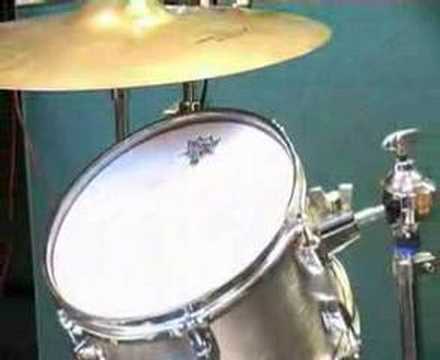

Solenoid driven acoustic drums
I’m not sure if any of you have seen this before but this is sick.
<object width=“425” height=“344”><param name=“movie” value="
name=“allowFullScreen” value=“true”></param><embed src="
type=“application/x-shockwave-flash” allowfullscreen=“true” width=“425” height=“344”></embed></object>
Any idea as to what type of solenoids these are?  I have got to have one of these setups at least for an 8 piece kit.
Direct striking of the drums by the solenoid.  I like this approach better:
This uses some sort of rotary actuator (solenoid).
