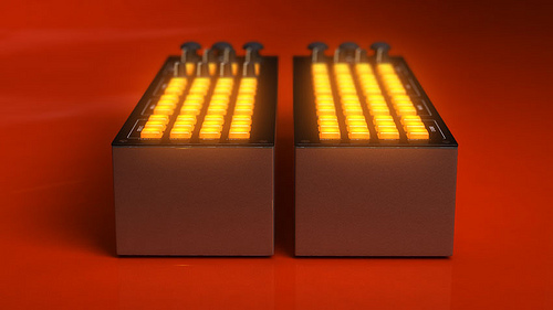

I can’t believe you can’t power everything off the gm5! I did my research and people were saying that as long as you weren’t using LCD’s etc it would be fine. Take a look at the attached image to see what I’m building, there is a CORE, 2xDOUT, 2xDIN and 1xAIN in each one + the GM5.
I guess it’s not really a massive issue having to use an external power source (there’s no room to build one inside), but is this definate that what I’m trying to do with the GM5 is completly misguided and not going to work?

Well… I see (among other things) 9 * 4 = 36 LEDs. With the default 220 Ohm resistors you’re looking at roughly 15mA per LED. 36 * 15 = 540mA. To bring the total current consumption of the the LEDs to a reasonable level of say 72mA you’d need 1.5k resistors, which will dim the LEDs to the point of them barely being visible (if they work at all @ 2mA)…
As nILS said, you’re just pulling too much of the “go go juice” Amps… There are two ways to tackle this problem.
As we both said to you, pulling the power from the USB on the GM5 is risking a lot of things. You could very easily damage your computer motherboard that way.
separate power supply to the core is the answer… or if you really have a very stable clean 5V DC supply then you could also power the DOUT boards directly and sever the power connection between the DOUT and the CORE while leaving the data lines in place. BUT either way, you still need a separate power supply, and the easiest way is to power the core properly via its normal power input and let the voltage regulator circuit on the core take care of the power being clean.
