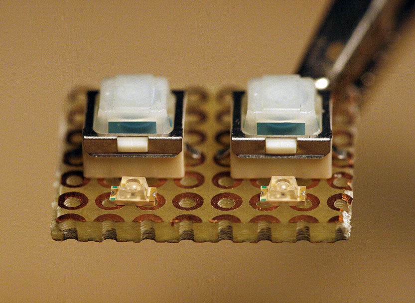

The shown switches are very nice, have a “soft feeling” and the button distance of ca 1cm (5mm switch button cap, 5mm space) should be good for quick changes in the pattern or “live playing”.

Me was unsure too, at first - but if you have one of these fabulous “casio” school calculators used for higher-level maths, you can try it…
They have the exact same spacing (1cm horizontally and vertically) and tactile feel (soft) for the upper scientific button matrix (usually 6x4) - it would be super smooth for pattern programming without too much hand travel!

I can confirm how nice those buttons are. Soft feel, quiet. And easier to solder than the 4 pin through hole types.

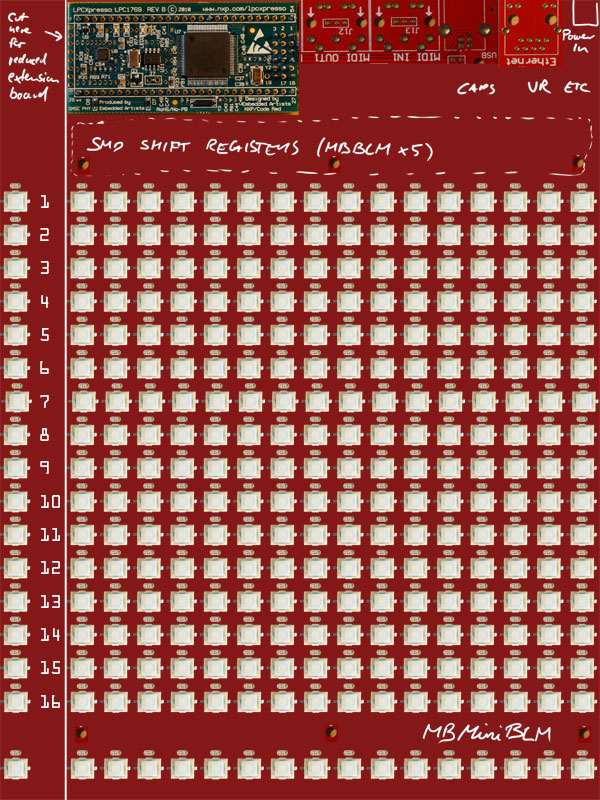

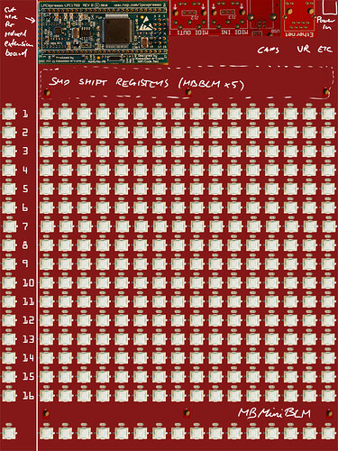

Roughly sketched, I could imagine it to look like the attachment - as there was a little bit space for more connectors, I´ve drawn in optionally populatable MIDI sockets as requested, they sure may come in handy for any other kind of app or BLM extension running on it… There is only one MIDI pair due to space limitations, but please bear in mind, that you could have a few of these stacked Mini-BLMs forwarding MIDI to OSC and vice versa.
The smd diodes for the tactile switches are still missing in the image, but all component sizes have been measured and are roughly right.
The board size would be 18x24cm for the leftmost BLM, and 16x24cm for any further (cutted) module.
I am just not sure if all traces would fit, and there is enough space for it to be primarily single-sided, or if some SMD components would have to be soldered to the backside - any feedback is welcome, even destructive one :slight_smile:

The button spacing on my BLM and Seq PCBs is 19mm horizontal, 14mm vertical. I haven’t spent much time using it yet but so far I’m happy with the spacing on the Seq.
You may find it very difficult to route the traces from the Scalar sections to the matrix with a 2 layer board.
Also, you need to factor in possible front panels + button caps, and maybe check whether the vertical separation between each row is sufficient (visually with the LEDs.) And anchoring the whole thing to a case.
I hope to have initial testing done on my BLM PCBs done in the next few days and will be happy to share - hopefully no mystery problems like with my Seq PCB.

Me just had an idea, how the above design can be improved - consider the shown PCB as the frontpanel of the unit, all switches and LEDs are quite flat and SMD-soldered to it, no real need for plexiglass (but you could have something cut by ponoko, probably).
But then, the LPCXpresso and all ports would be exposed, which would not be very nice visually…
So, consider just flipping the upper section of the image to the backside. You would therefore only see the solder points for the LPCXpresso, the solder points for the MIDI, USB, ethernet and power sockets and the vias.
The BLM_Scalar modules would then be realized with smd components on the backside, just like TKs original design - and would connect to the switches and LEDs with vias. With this method, another two centimeters of vertical PCB space (18x22cm final size) could be saved - and the original 17x4 (x5) horizontal segmentation could be used.

Hmm, this is very disco! An interesting side-effect is that it’s probably cheaper to use the LPCXPRESSO than the older BLM which was using a special connector…

oh, the LEDs don’t got under the buttons, monome style? that’s a pity. :frowning:
You don’t want a MB core module at all, but want to design one yourself? Wouldn’t it be smarter to make the blm pcb attach to the core via ribbon cable? then you have a production-ready and proven core with all the connectors you need, and could design different version of your blm (4x4 to 16x16) which could easily swapped.
I don’t imagine you will lose much space with this (even gain some because now you can sink/lower the expresso pcb without problems), but have huge gains in modularity and reduced complexity.
@jojjelito: yes, 2-color “only” is fully intentional, because of the design goal of minimum price per BLM - but it will be fully sufficient for pattern programming.
@bilderbuchi: yes, the cheapest tactile switches with integrated LED illumination, that I found were around 1 US$, so I thought, that 5+9 cents per switch/led are very sensible cost-wise.
Also, as the button cap push area is only 5x5mm, it makes sense to have the LED above the area you pushed, for visual confirmation, that you really enabled the step (otherwise only your finger is illuminated :-)).
Regarding the integration of the Core… The LPC itself is carried as a “removable” shield on the backside - as there needs to be lots of PCB routing done anyways, it makes sense to integrate it for this module. It is already very specific, anyways.
I just measured the space above my Moog LP - and four of these units (18 + 16 + 16 +16 cm) would fit perfectly for a compact 64x16 BLM ;-). So I guess, I have to bribe someone to help with the PCB routing :slight_smile:
