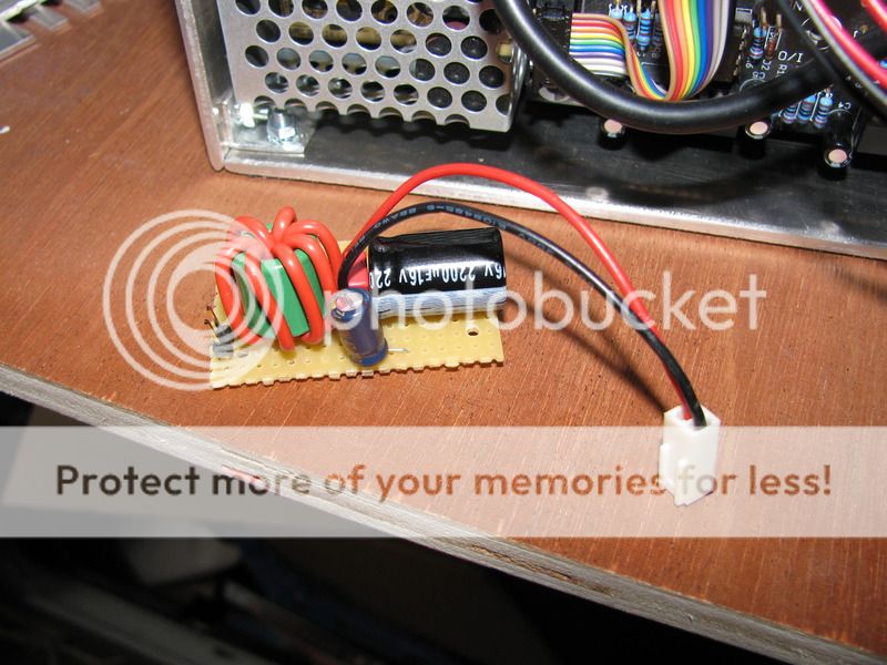

Can you insert a cheap LC filter at the core end? Things necessary to build it:
one big cap (2200uF)
one small cap (100nF - 47uF)
one ferrite core with at least three windings of the plus side of the cable through it.
This should filter out the worst stuff - here is a DIY instruction:
http://blog.oscarliang.net/lc-filter-fpv/
just add the small cap in parallel to the big cap, this further improves filtering performance. These filters have helped me a lot in other (non-music) applications, they really work and only cost a few cents and half an hour to try out. If you are interested, you can re-measure with your scope after installing the filter - should be lots better! :slight_smile:

Peter your filter rocks!
attenuation of 30mV ripple to 5mV (10 mV P-P) and good sleekage. with the scope and filter it’s ok!
but without the scope and with the filter the CS crash immediatly after power on!
i see the real benefit of the filter and hazard made the filter permit me to “force” bug! (extra cap of 2200uF will act as reserve of power)
