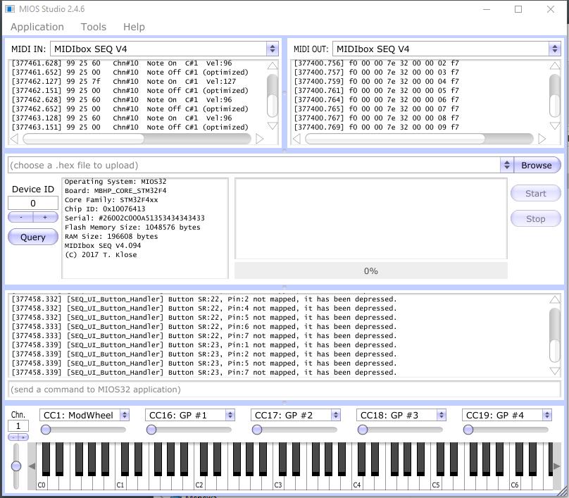

and in result have crazy seq.(screenshot) and MC3486, MC3487 seems warm.

Solved. Short under the IC socket. Thank you for attention.
