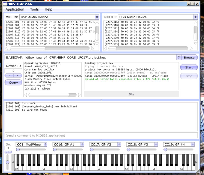

I have uploaded seq_v4_079 and it seems to have taken as there were no error read outs in MIOS but I am not seeing any characters on my LCD’s even though they are lit up… Also all iI have connected is the core and the LCD’s no SD card or control surface…
