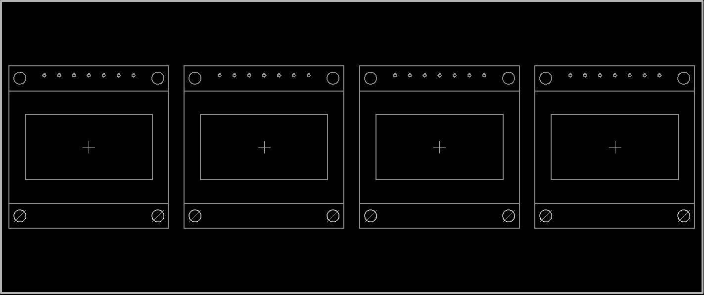

I have some PCBs arranged like this and displays in white if you need, let me know.
i need 16 for my
mb lre8x2cs
placed like in programma.
if you have that many. i would take 20 + 1xpcb
