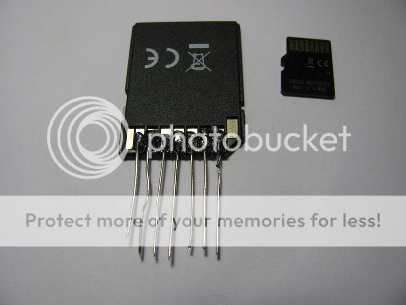

you could use micro SD card and the ADAPTATOR will be the socket like:http://www.ucapps.de/mbhp_sdcard.html
first solder unused component legs to the adaptator:

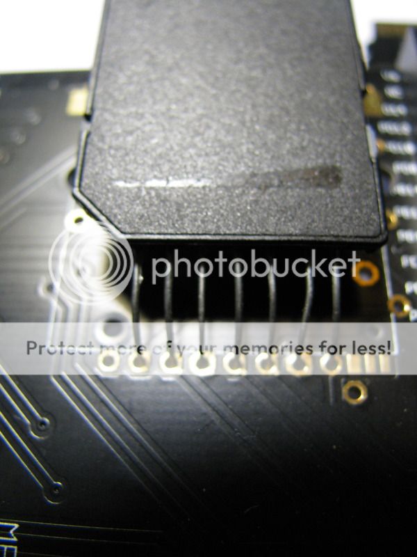

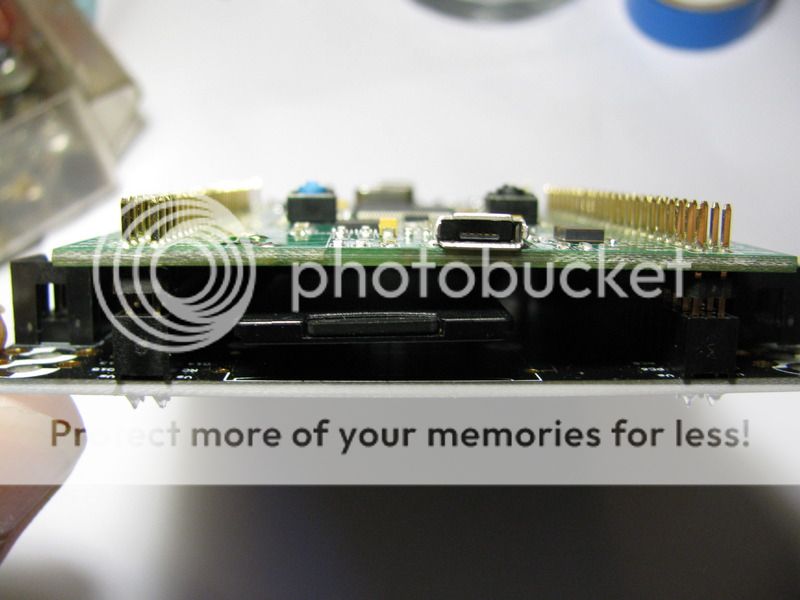

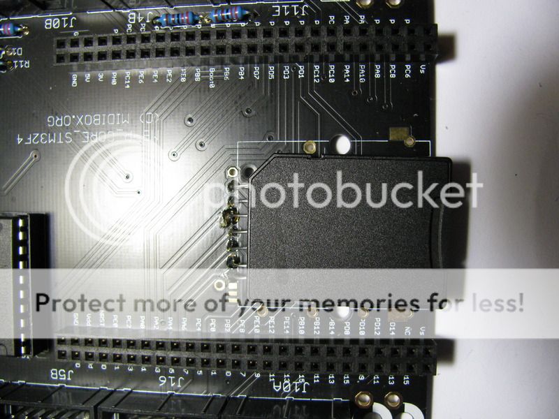

solder to the core but leave some space to the board for avoid short (be carefull pinning):
you could fix it (glue) if you want (not done for me legs are sufficiant)

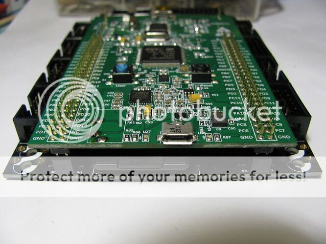

et voila!
Thanks for the tip! I just did the same, but I used soft wire and double sided tape to fasten the adapter to the PCB.
