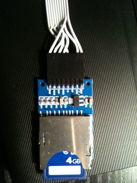

here’s an attempt of an ASCII art of the connections as well as the cable itself. Please note that as mentioned earlier I replaced the DIL by an (angled) SIL so the numbers are 1 to 8, not 1 to 16 (as it’s on your’s), consider these more a ‘row number’ than the actual pin number:
LPC17 J16 SD Card
 header SIL
 (top) (top)
  1 2 1 (Vss) - 1 (GND) 1
  ---- 2 (Vss) - 8 (GND) o-o- (GND)
 |o o| 3 (Vdd) - 2 (3.3V) o-o- (3.3V)
 |o o| 4 (Vdd) - NC o-o- (5V)
[ o o| 5 (SI) - 7 (MISO) o-o- (CS)
 |o o| 6 (SO) - 5 (MOSI) o-o- (MOSI)
 |o o| 7 (SC) - NC o-o- (SCK)
  ---- 8 (SC) - 6 (SCK) o-o- (MISO)
  9 10 9 (RC2) - NC o-o- (GND)
           10 (RC1) - 4 (CS) 8
For clarification please take a look at the following (crappy iPhone) image of the SD adapter cable. The top-most cable (red-striped, actually) is pin 1 on J16.
As for the resistor(s) I guess that these act (in accordance with TK’s note on the SDC schematics) as voltage dividers in case you’re using 5V instead of 3.3V, so unless it causes short it shouldn’t really matter. But that’s just my guess, not confirmed and definitely not to be taken for granted.
Hope you get it working soon!
Adrien

D’akujem moc! Now it works like a charm. In my first try, I connected RC2 instead of RC1. And i had figured out the links between DO/DI & MISO & MOSI incorrectly. Thank you for helping me out! Have you posted on your projects? I’d love to see them.
And for all the other newbs around: the config in the post above is correct!
