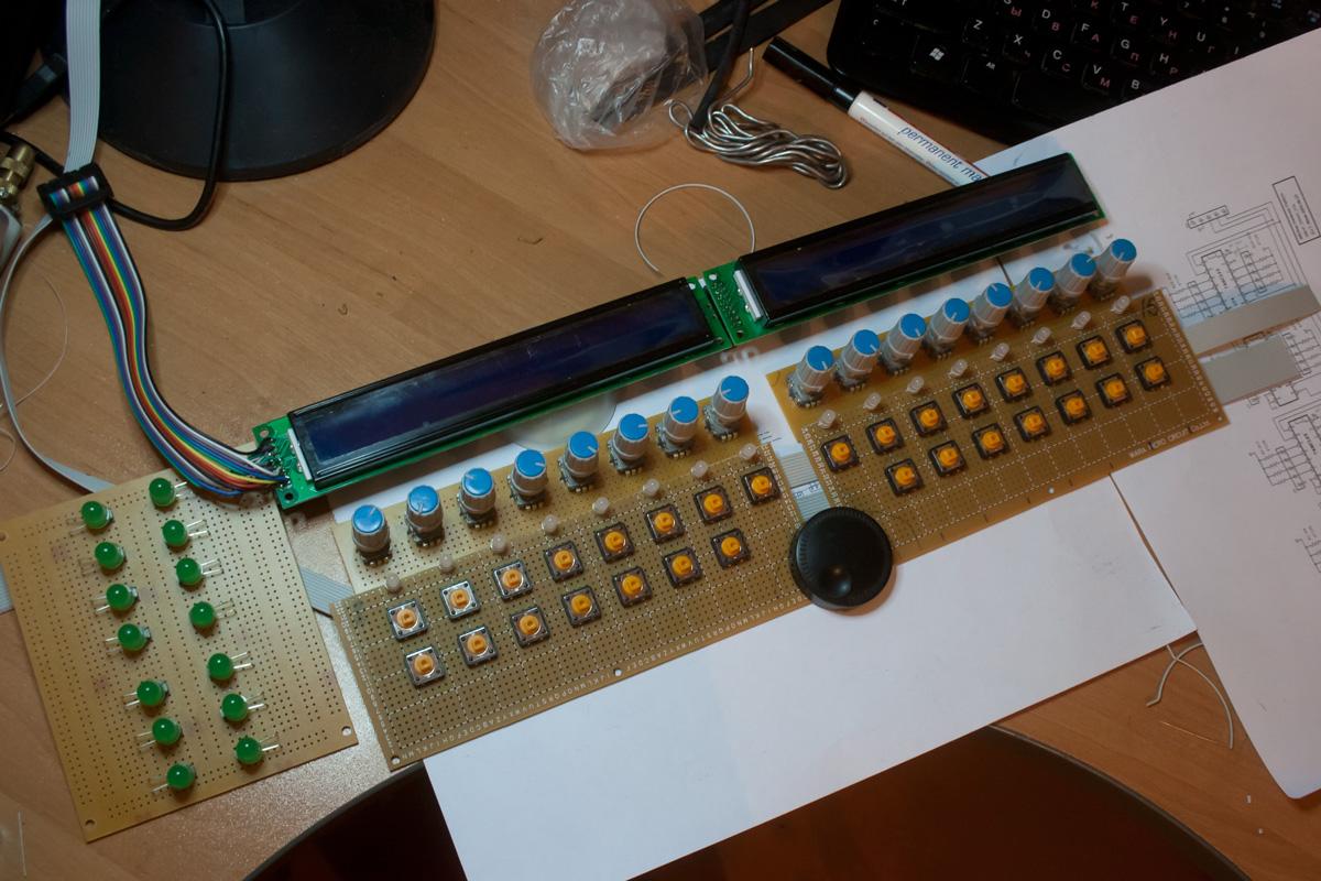

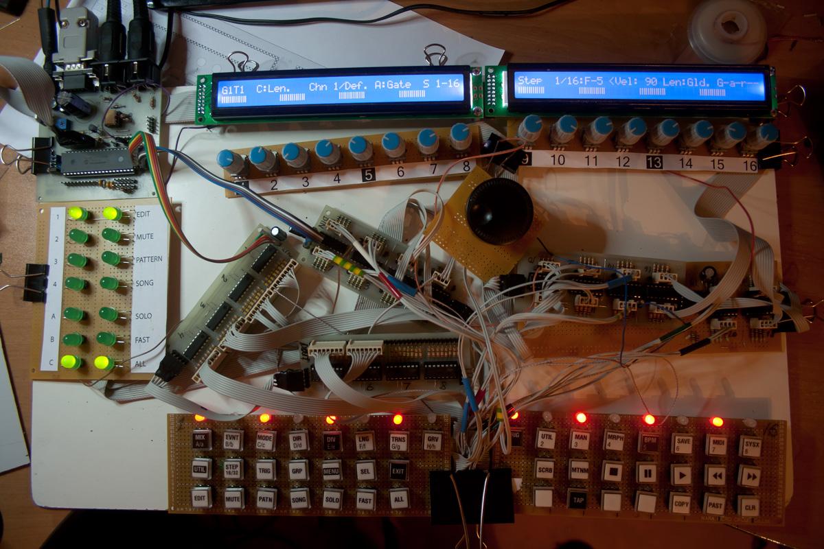

Building process of my mbseq and mbfm

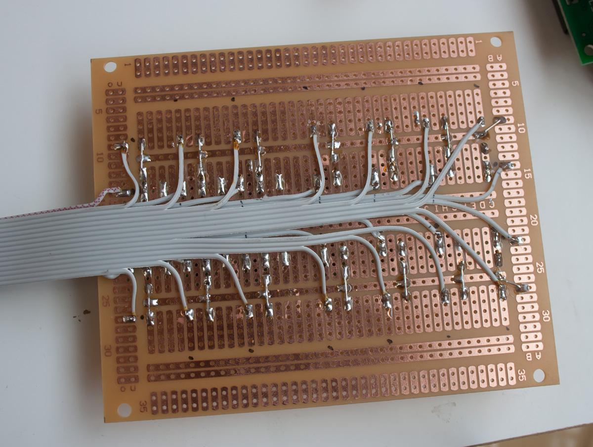

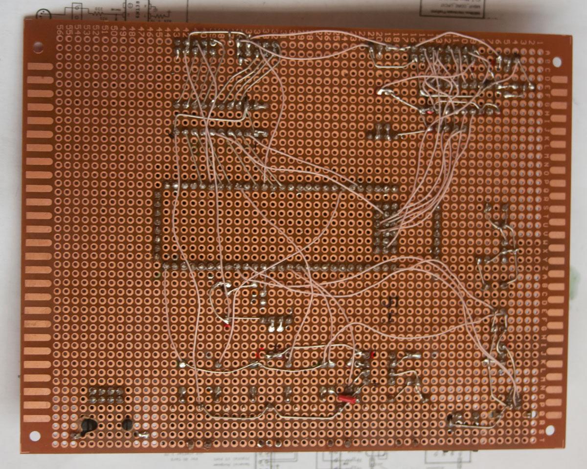

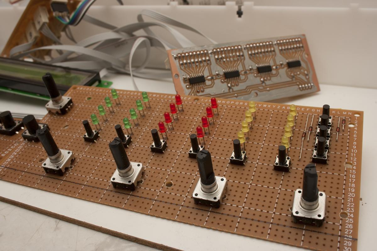

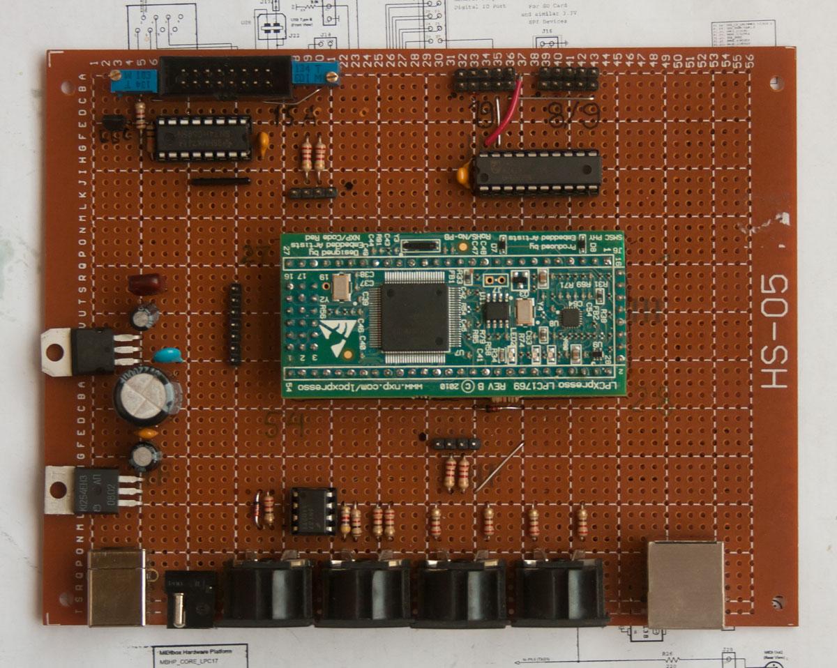

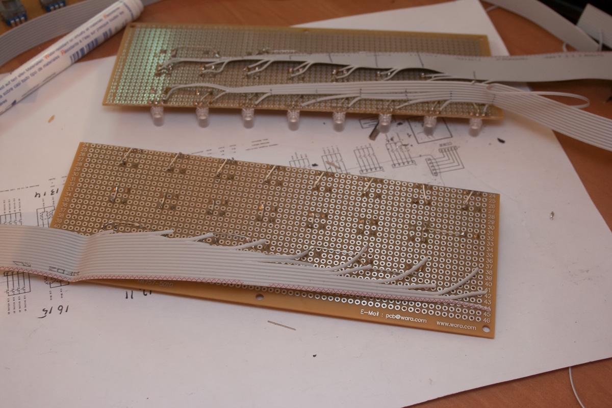

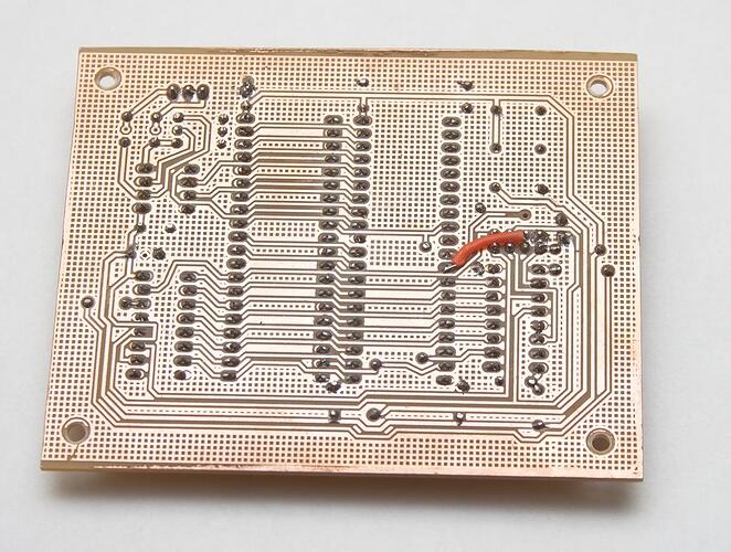

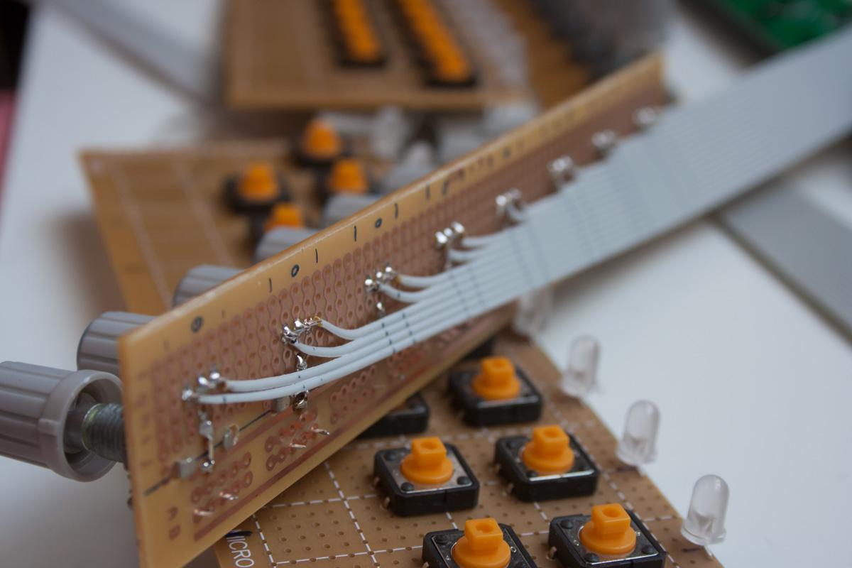

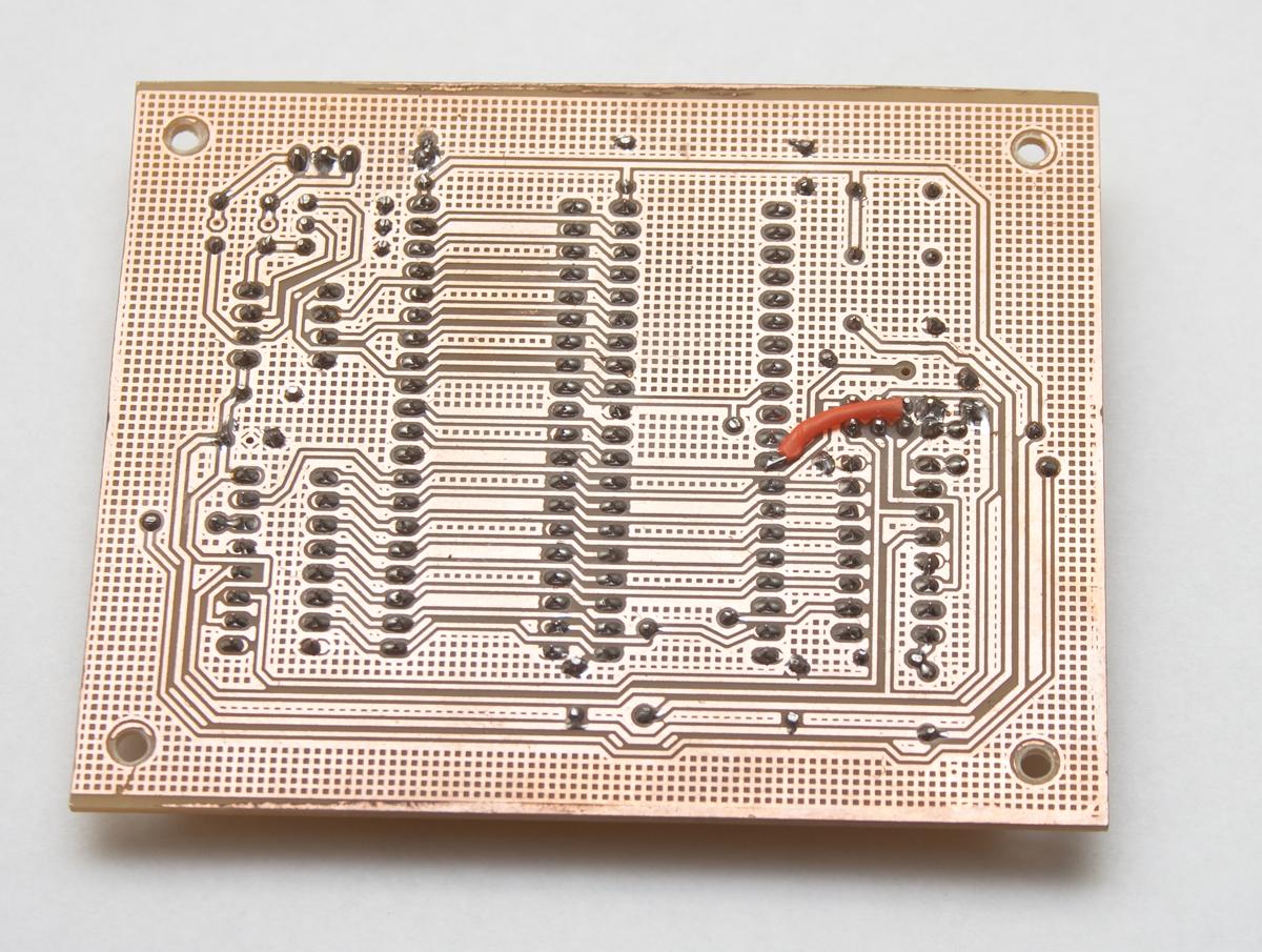

Seq V4 vero bottom
Seq V4 vero Top

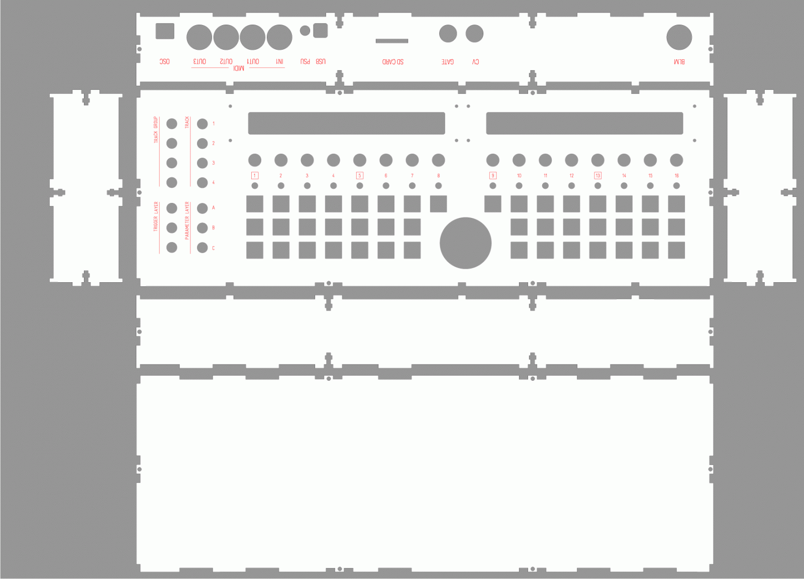

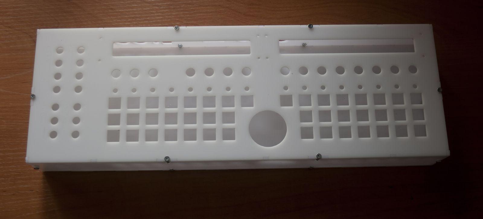

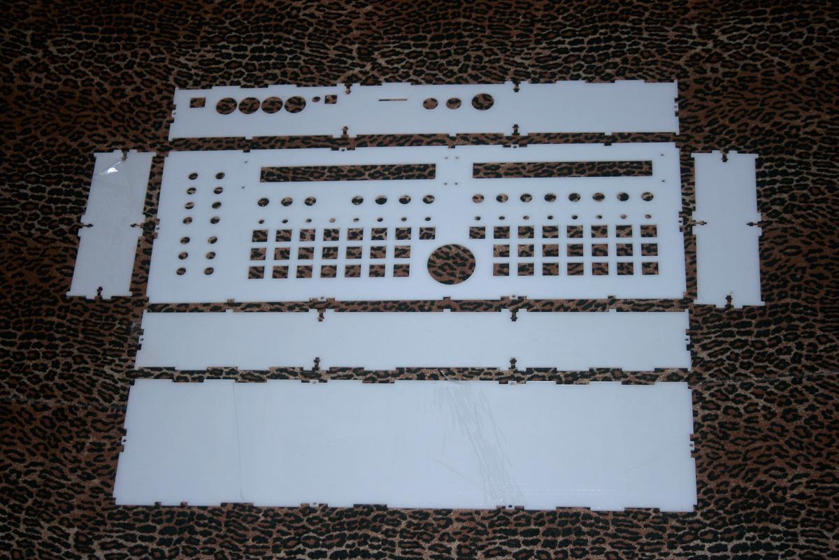

Acryllic case CNC
http://nekaka.com/files/get/1v7nYMjmqR/mbseq-case-fix-october.pdf<br /><br />http://nekaka.com/files/get/ltDrvttF4F/mbseq-case-glue.pdf
laser cutted case
Yeah!

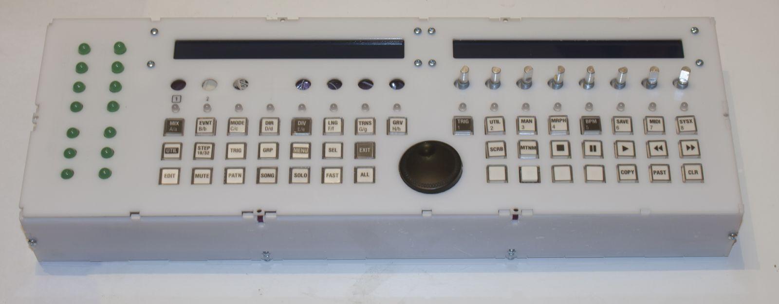

assembled case
All parts fits fine
top panel engraving
Single line engraving a little bit dirty but much accurate than double line.
assembled case
mbseq case test assembly
Found cutting error - no hole for 4-th encoder =)

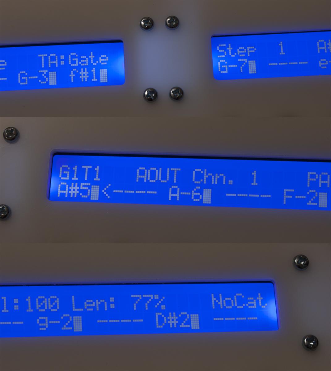

LCD windows
here fits fine too

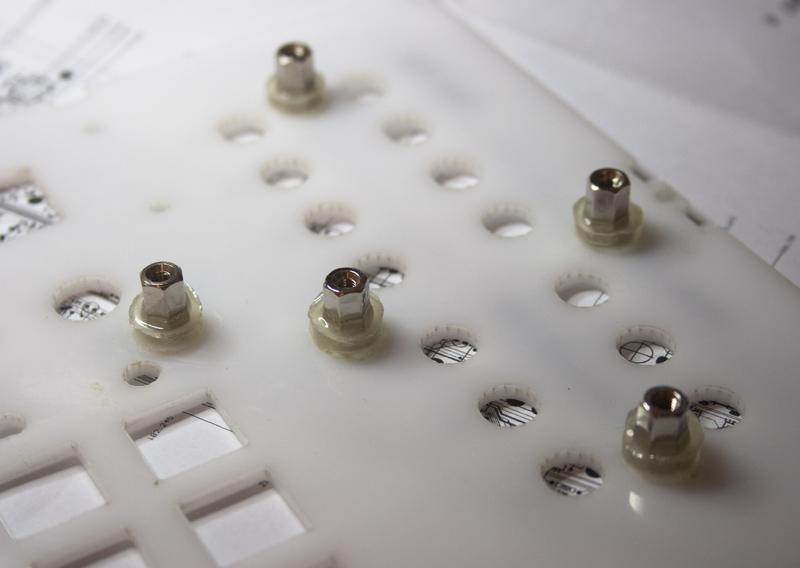

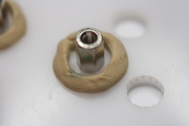

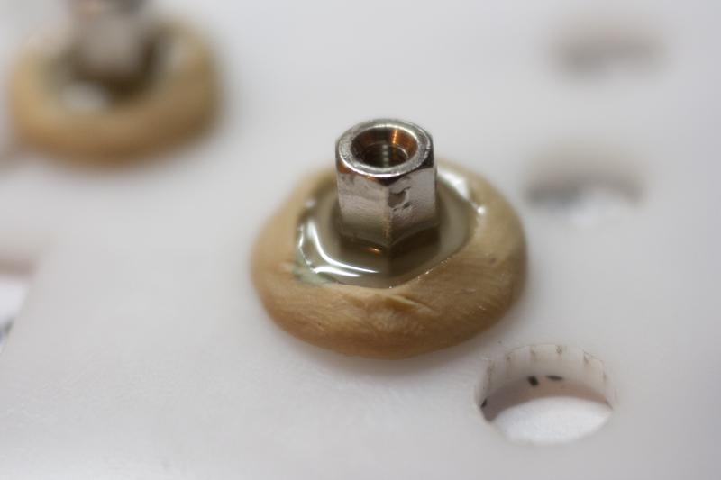

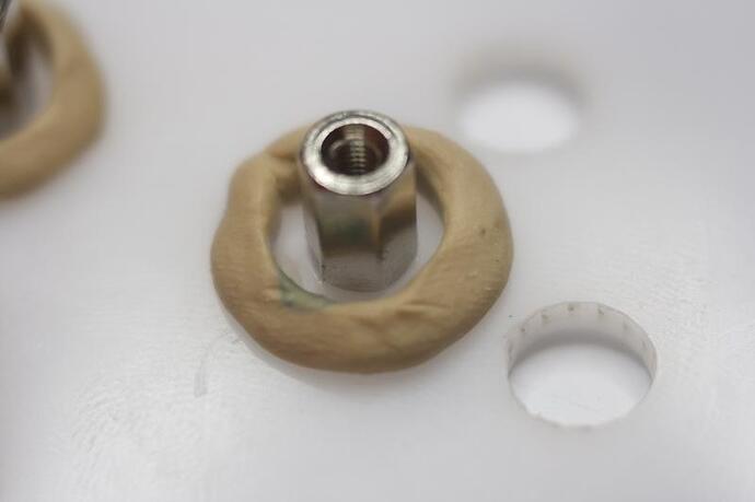

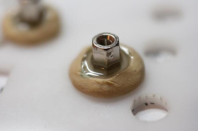

standoff with plasticine mold
standoff is glued with cyanoacrylate
plasticine mold filled with epoxy
fastened stand-offs
20 hours later

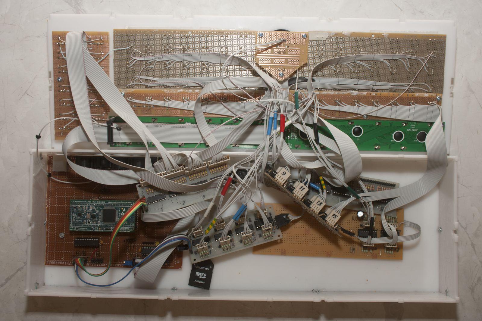

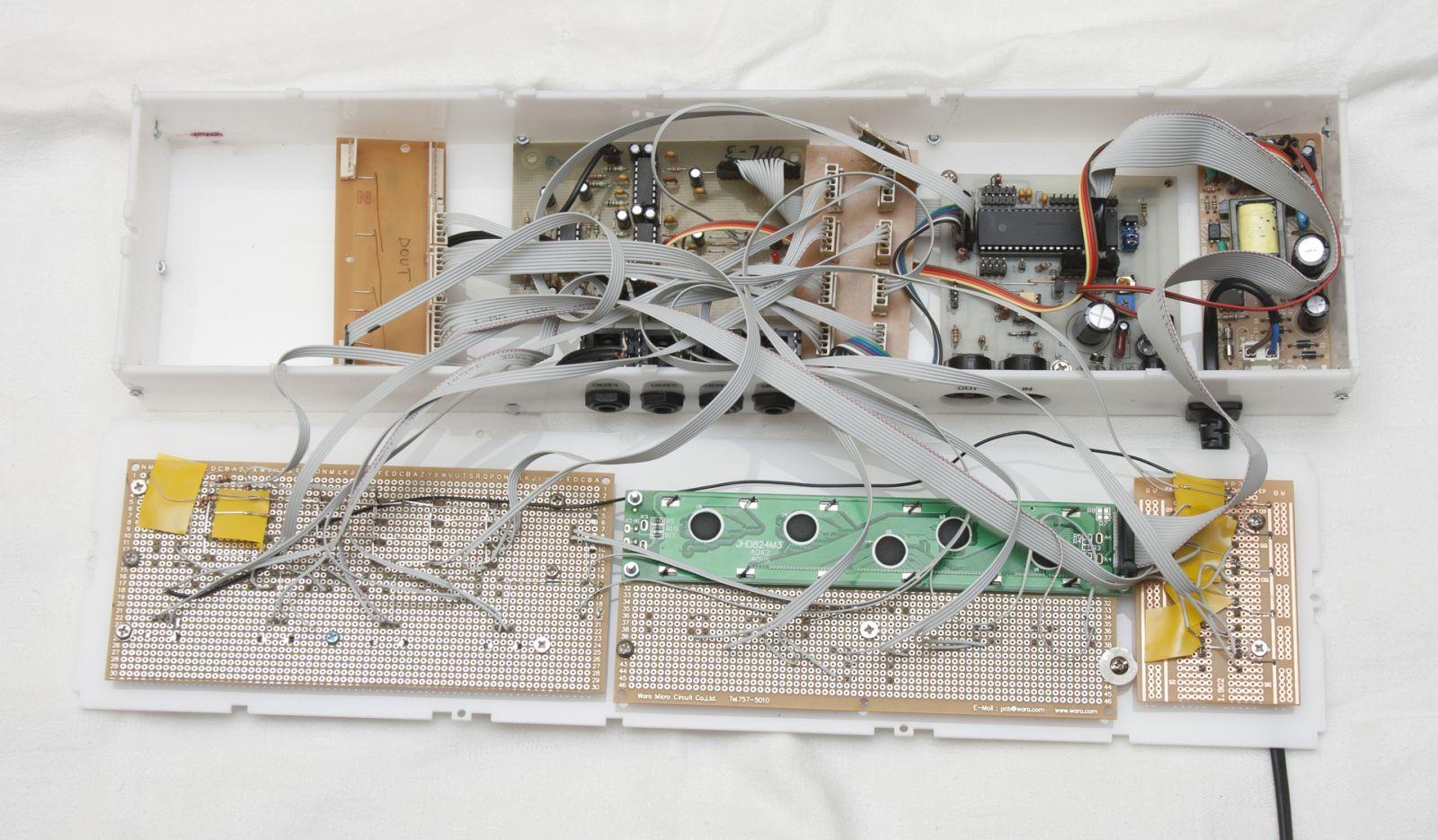

mbseq guts
mbseq assembled

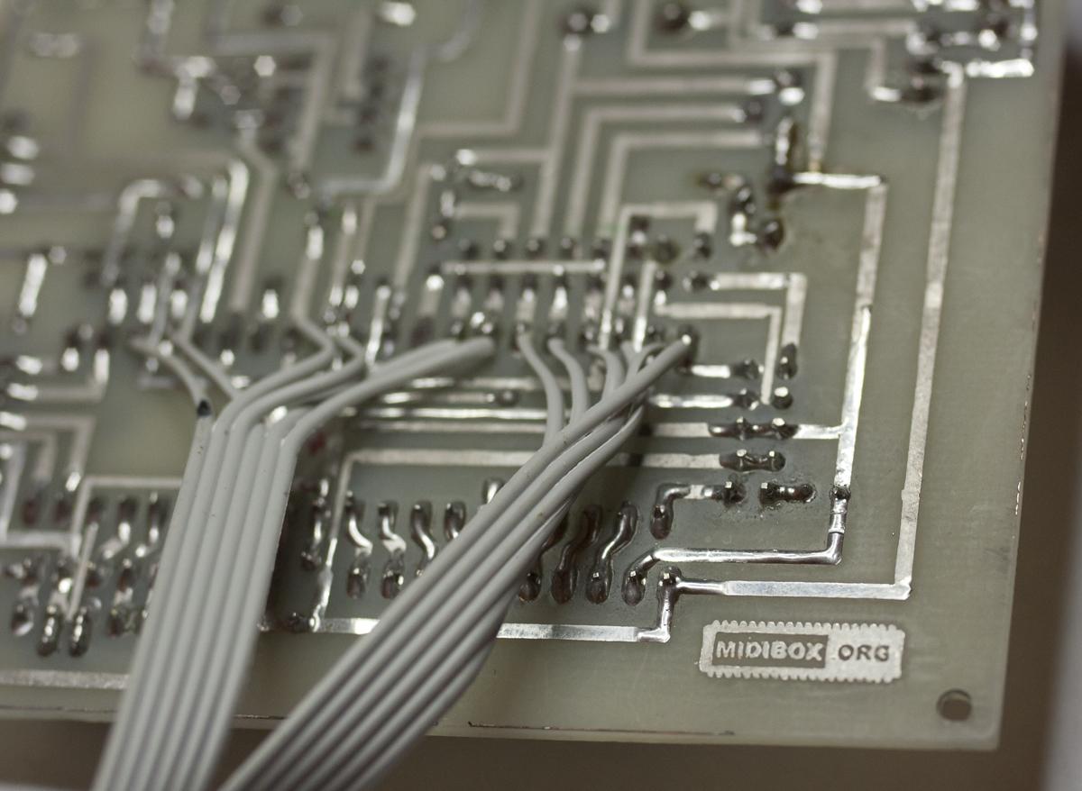

The final step is to make matrix wiring like in Wilba`s MBSEQ for control surface and leds. Now the bottom line of buttons not used.<br />Vacant DOUT and DIN modules will be used in MBFM, which is next.

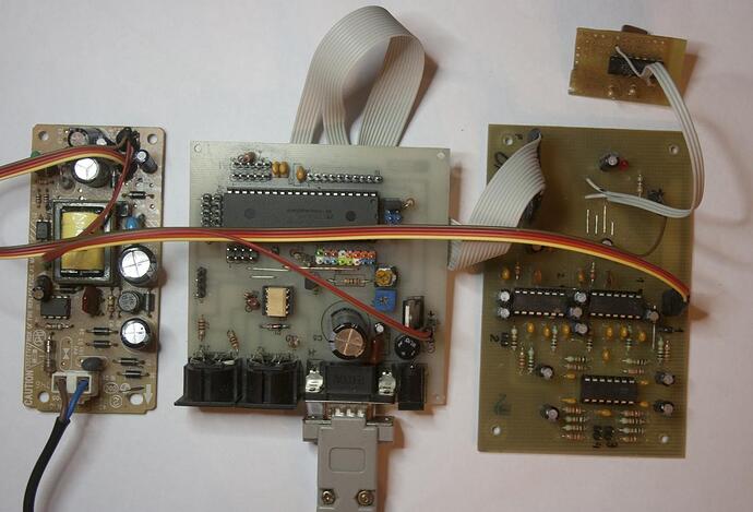

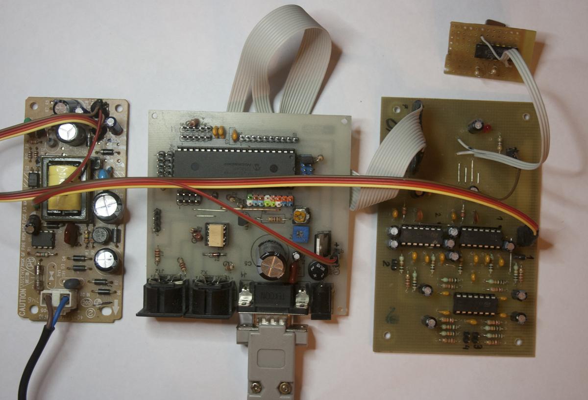

MBFM YFM262
CORE8
MBFM

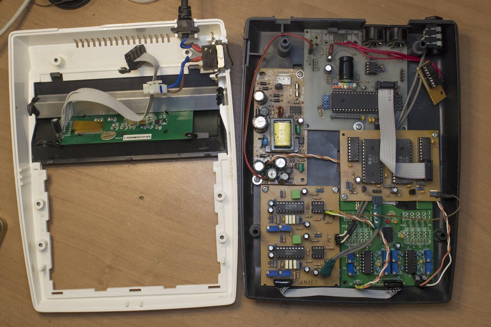

PSU taken from broken DVD player (bipolar 12v + 5v)

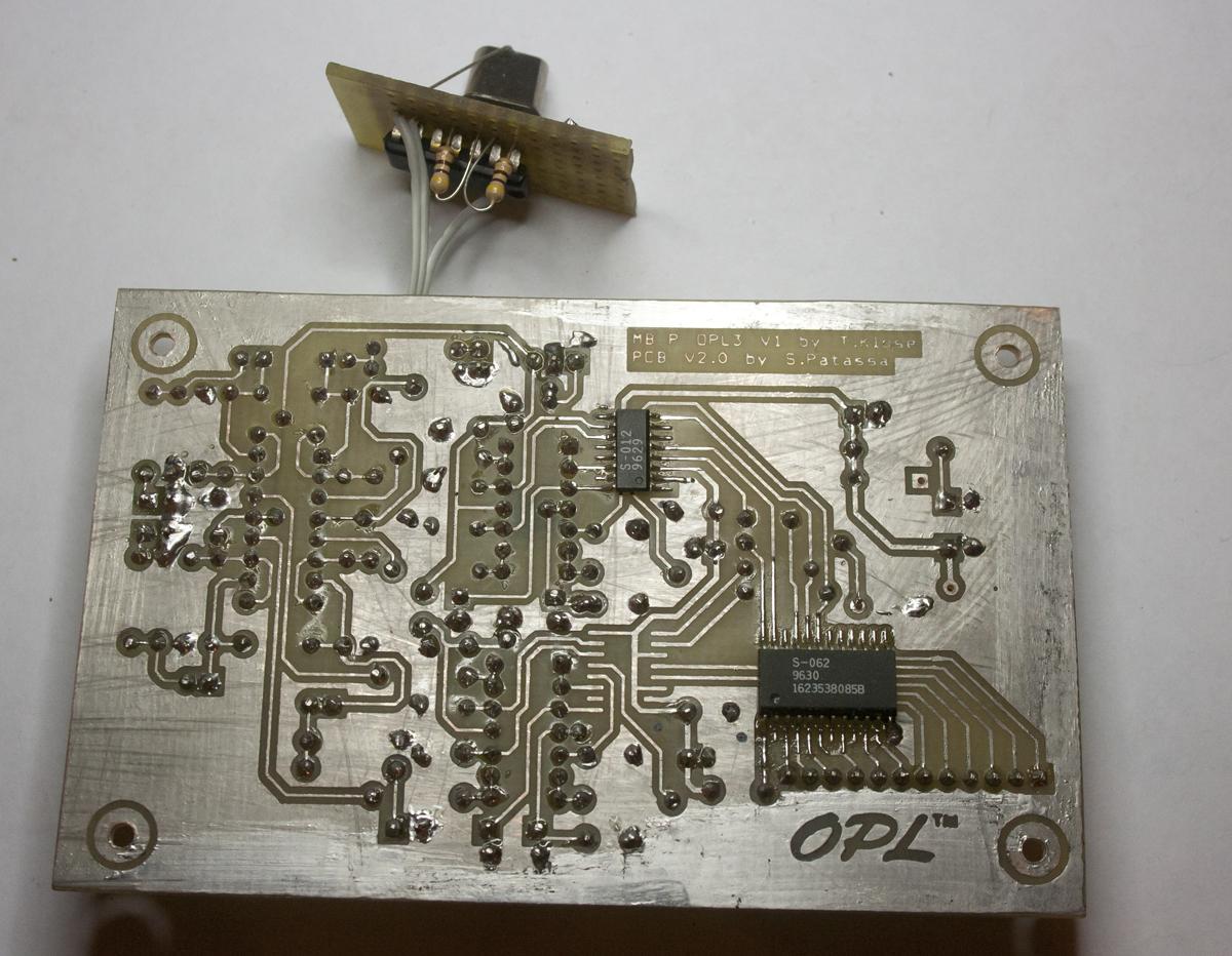

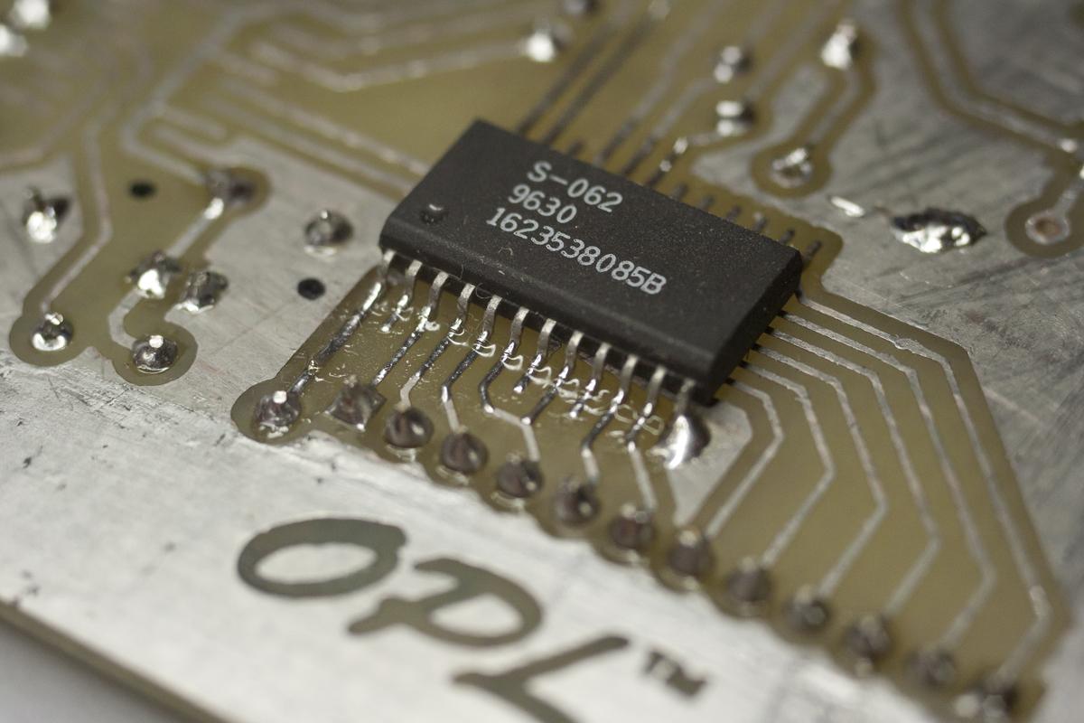

MBFM OPL3 board
MBFM YAC512

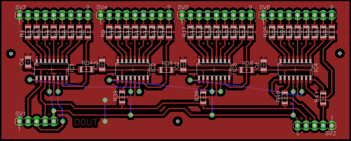

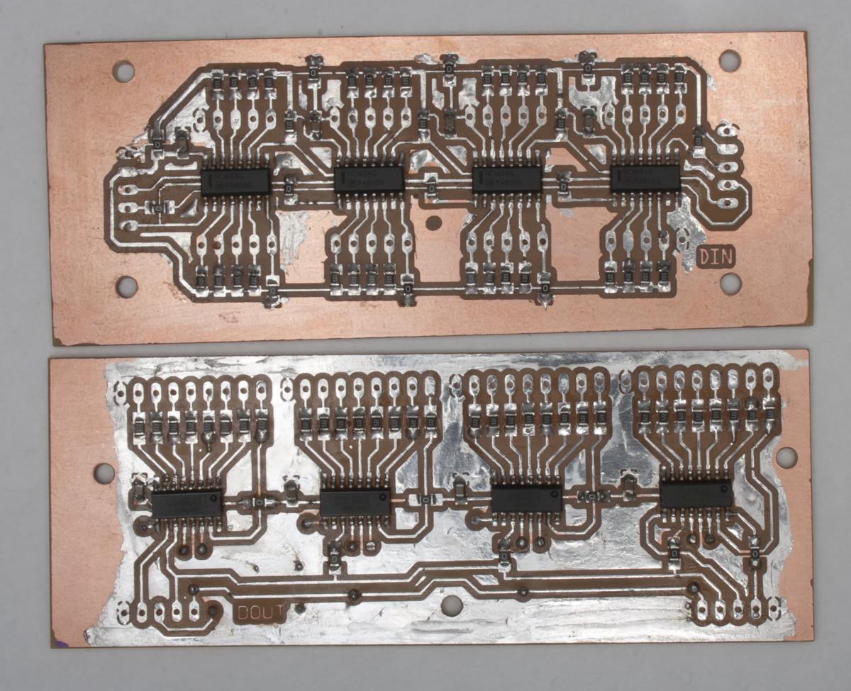

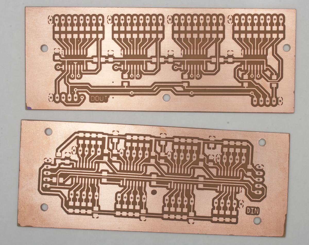

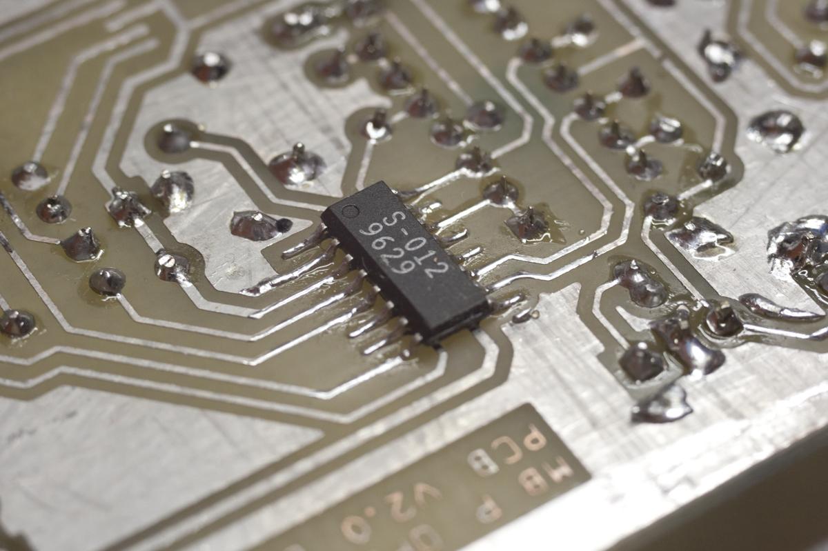

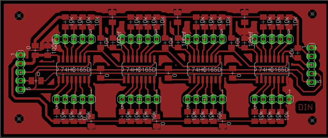

SMD DIN PCB<br />54 holes :whistle:
DOUT smd
SMD boards
Smd pcbs

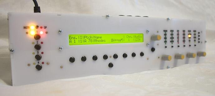

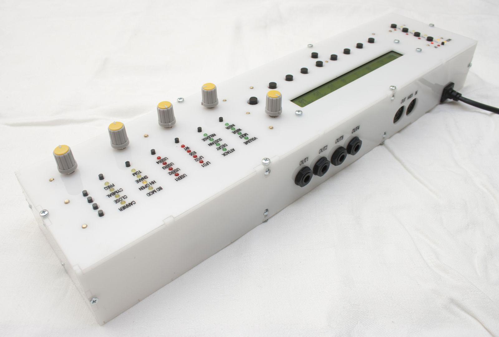

Midibox FM assembly
Midibox FM assembly
midibox fm assembled
midibox fm strange characters
Some of presets turned to this glitch Rhodes :whistle:

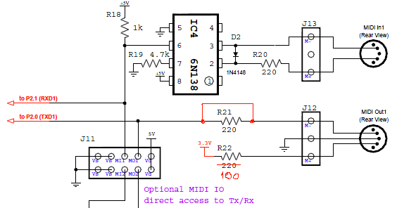

MBSEQ MIDIOUT Fix
like at 3.3 v midi devices.

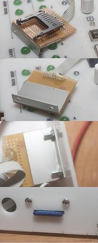

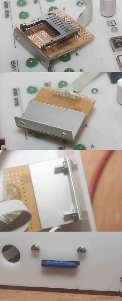

sdcard slot
SD slot desoldered from broken camera, piece of protoboard and aluminum profile.

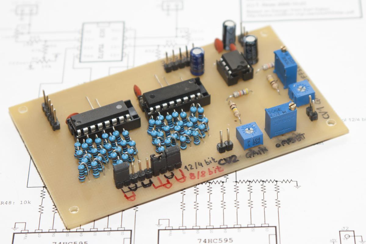

AOUT_LC
AOUT_LC DATA

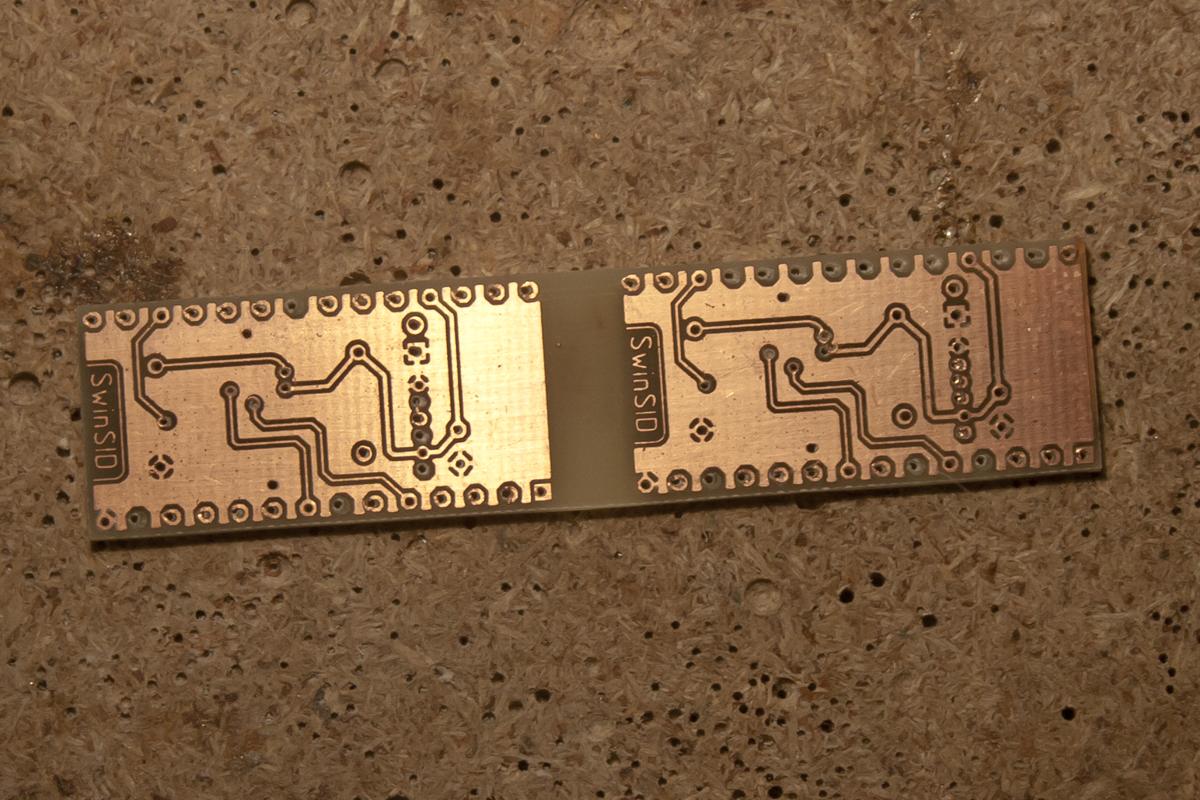

SwinSID pcb’s
twinswin

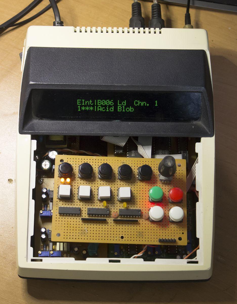

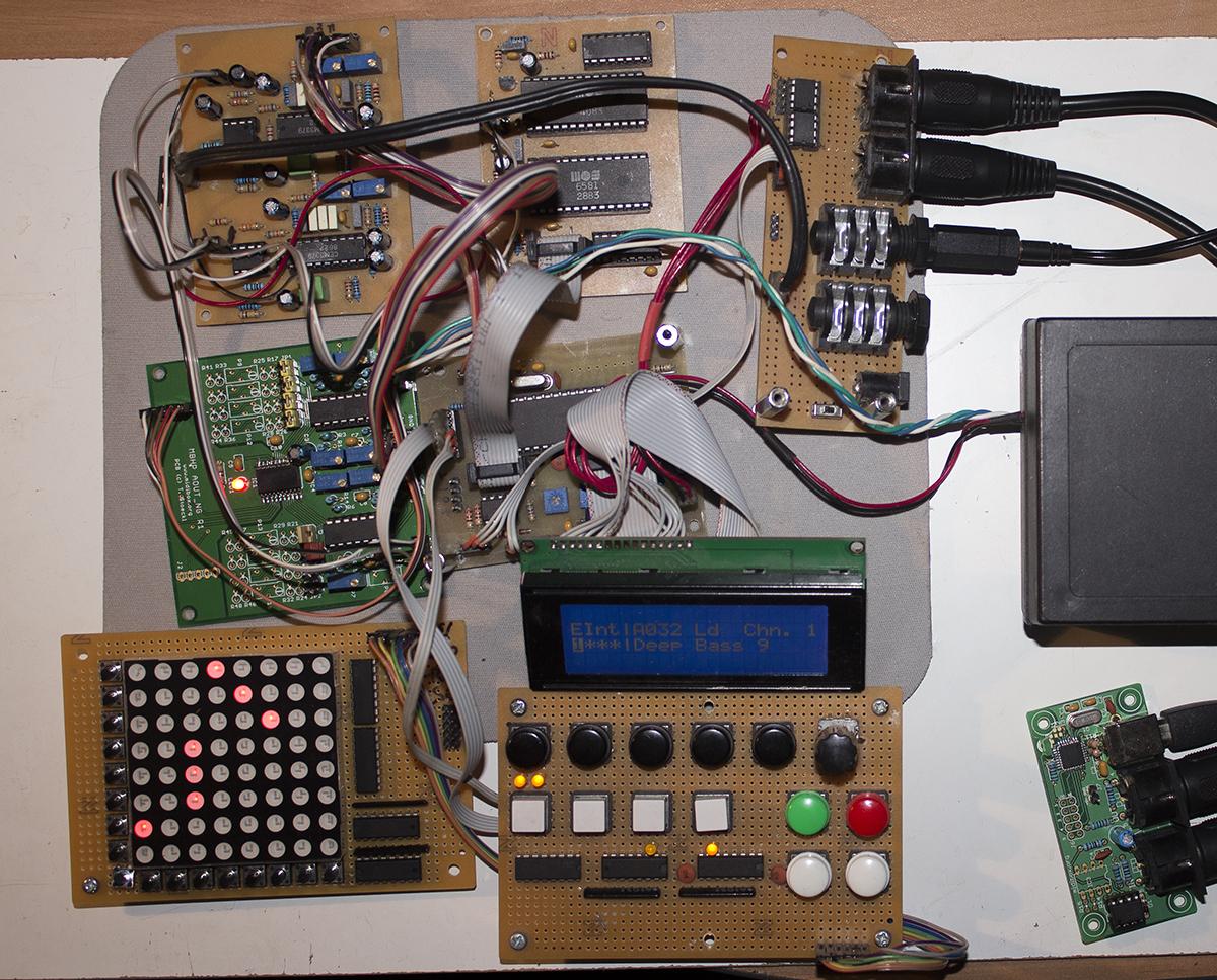

Made quick minimal surface, sammich-style: 13 buttons + encoder with button and 4 leds for L/R, PLAY and LFO. There’s 4 free leds, has no idea what i need more.

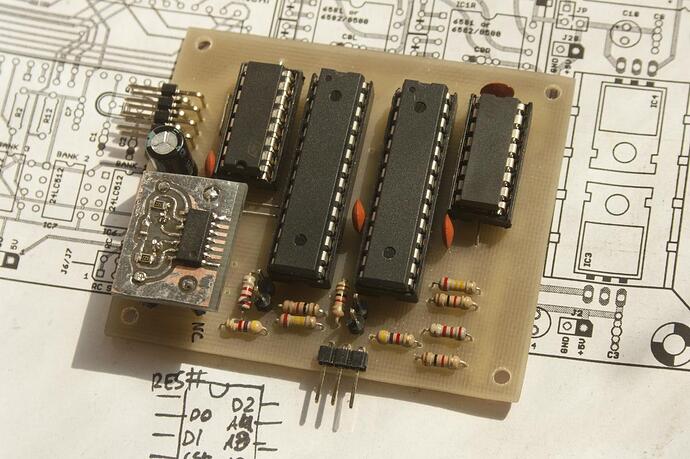

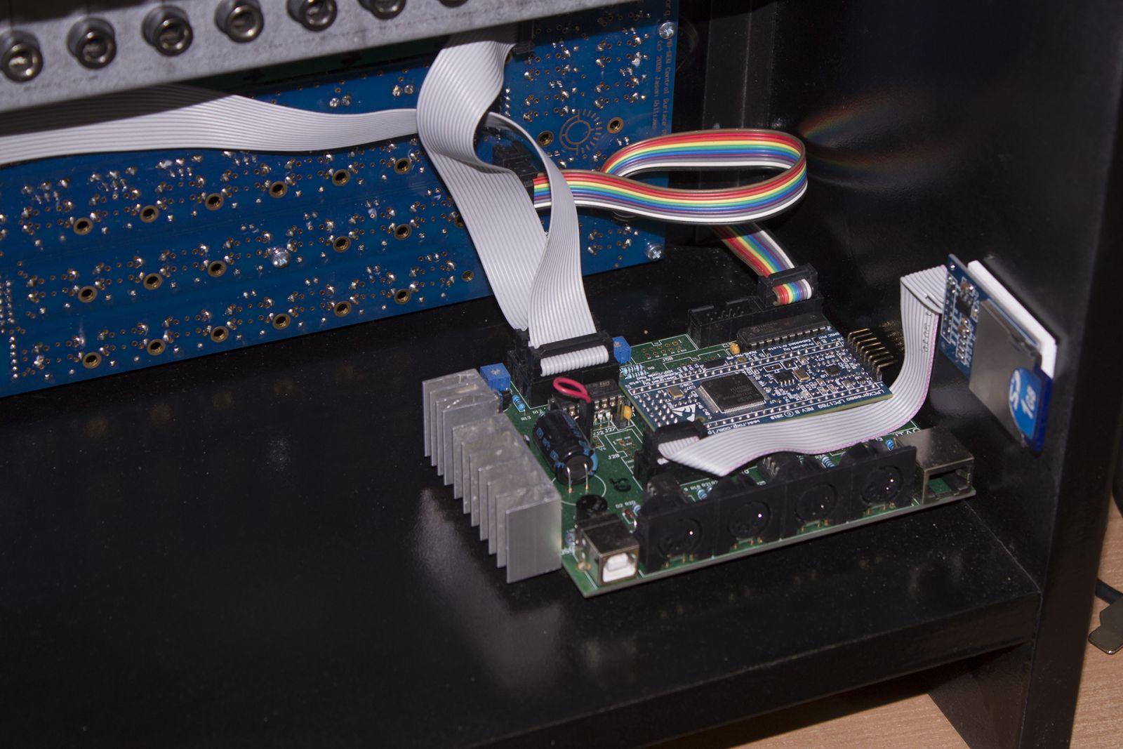

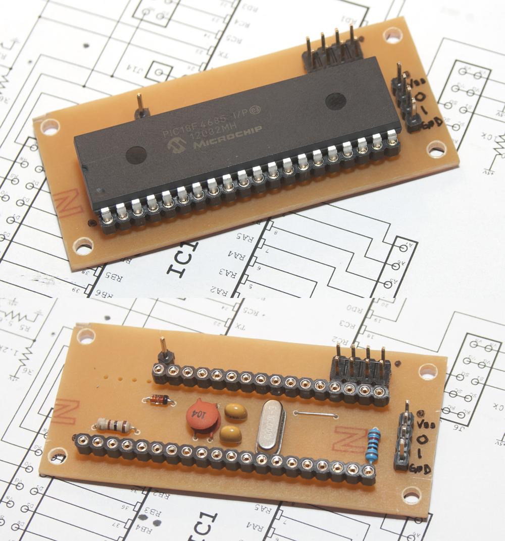

MBSID slave core
Nothing superfluous. 4pin Power+midi I/O from Core J11. One pin for CAN and 2x4 pin to Stereo SID module (J14 combined with unused pin)<br />Did i missed something? :whistle:

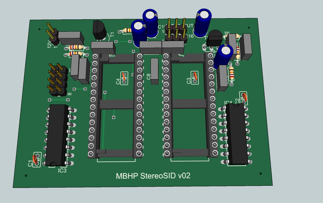

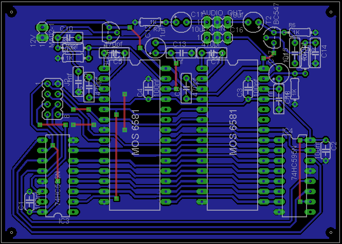

MBHP_StereoSID_v01
StereoSID module schematic
MBHP_stereoSID_v01_PCB
draft trace

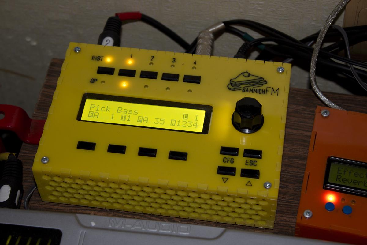

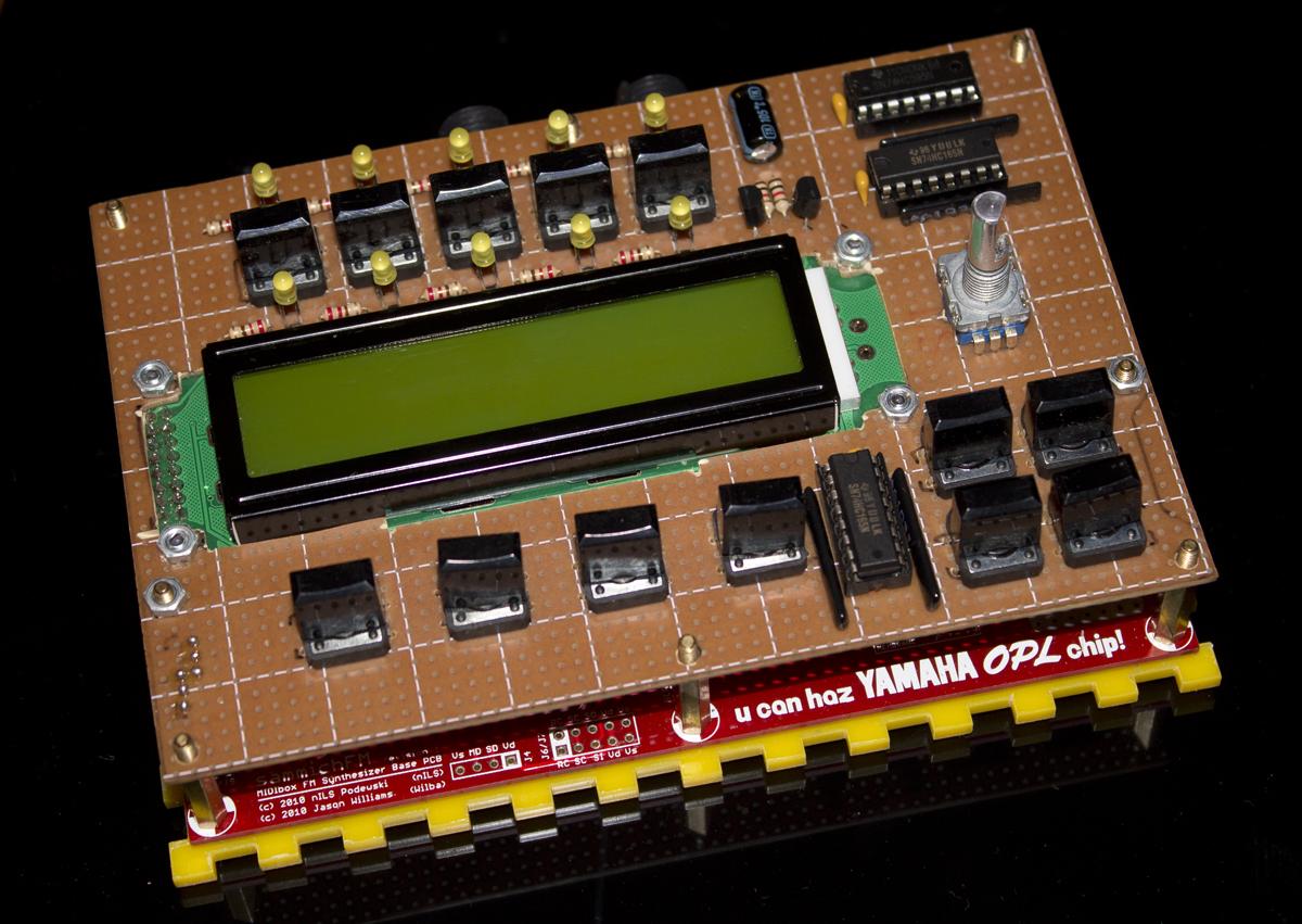

SammichFM
SammichFM perfoboard CS
SammichFM perfoboard CS wiring

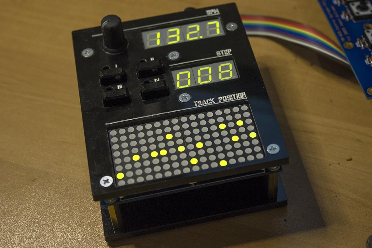

MBSeq TPD module

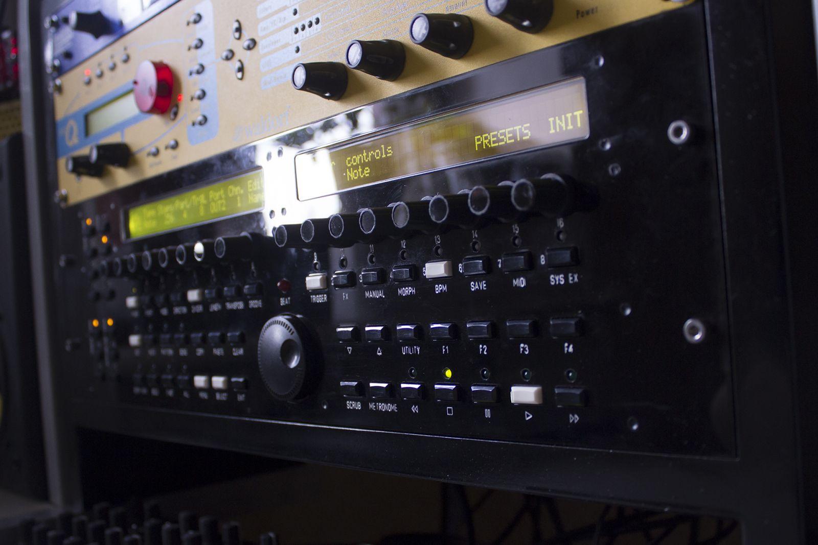

SEQ v4 lasercut rack
SEQ v4
SEQ v4

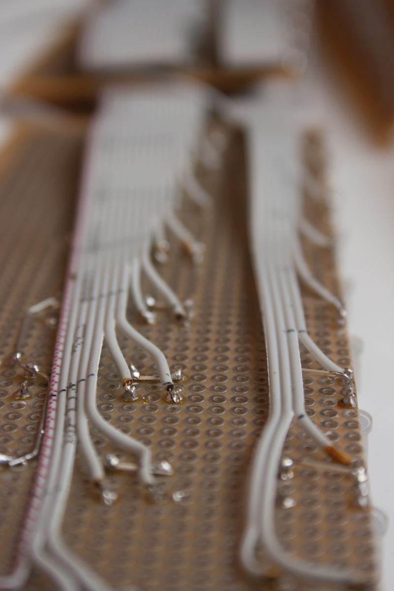

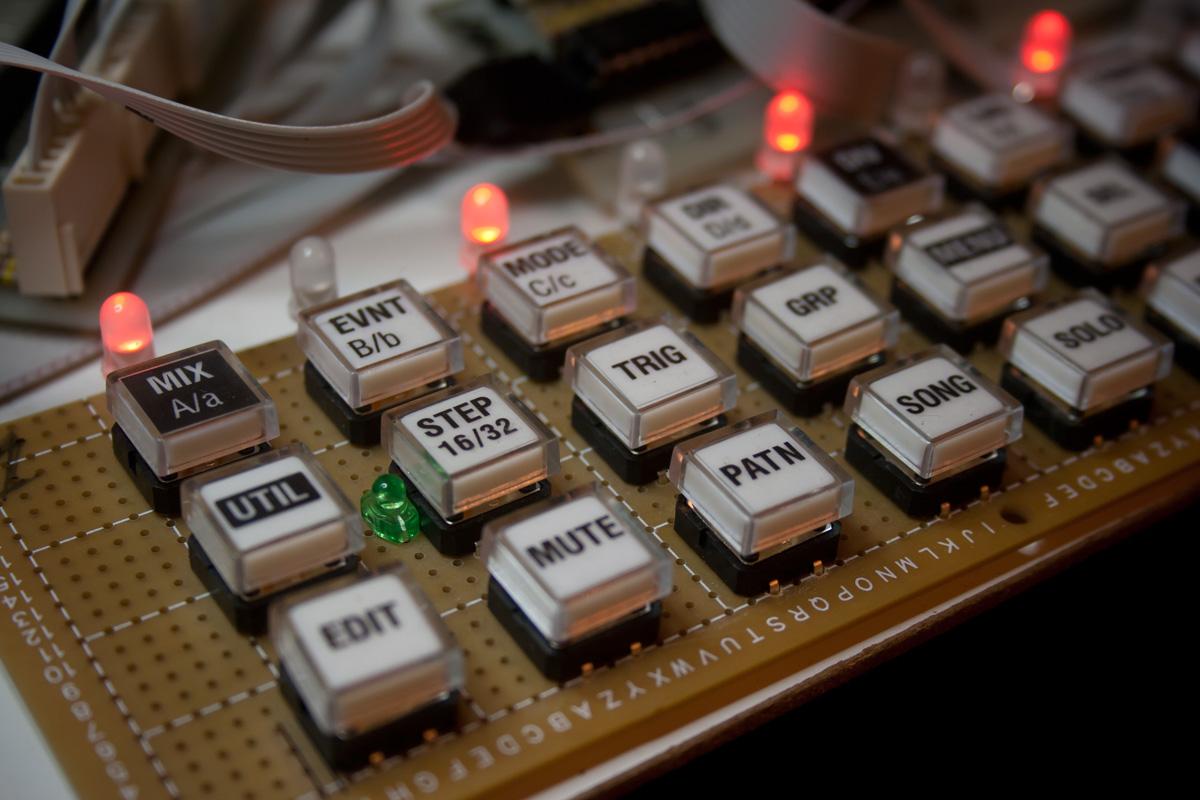

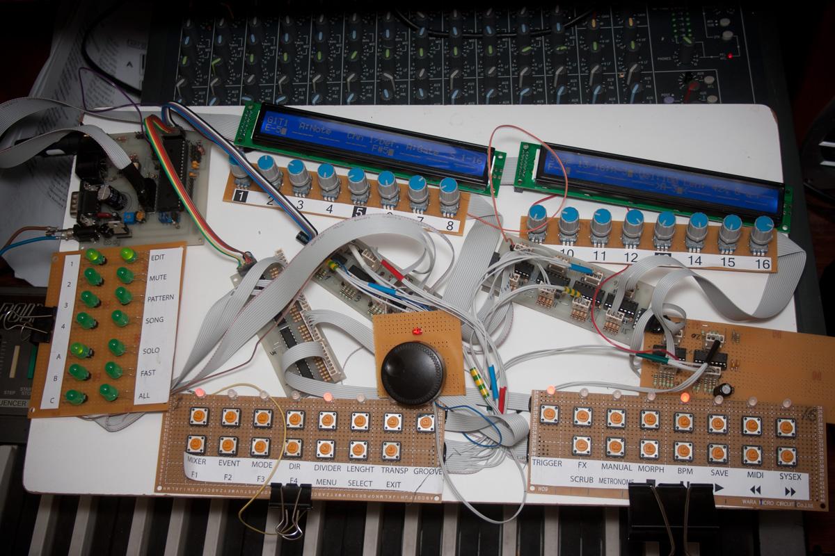

Re: MG 6934

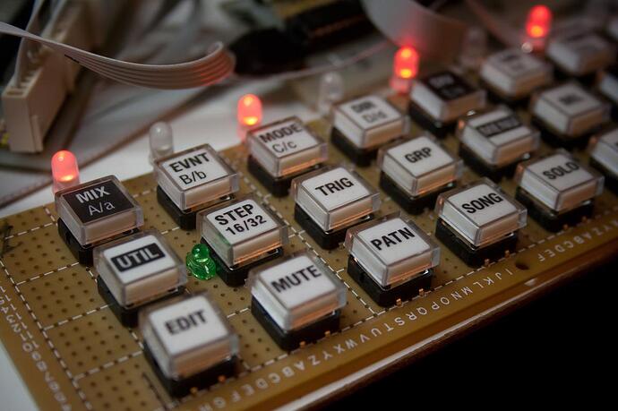

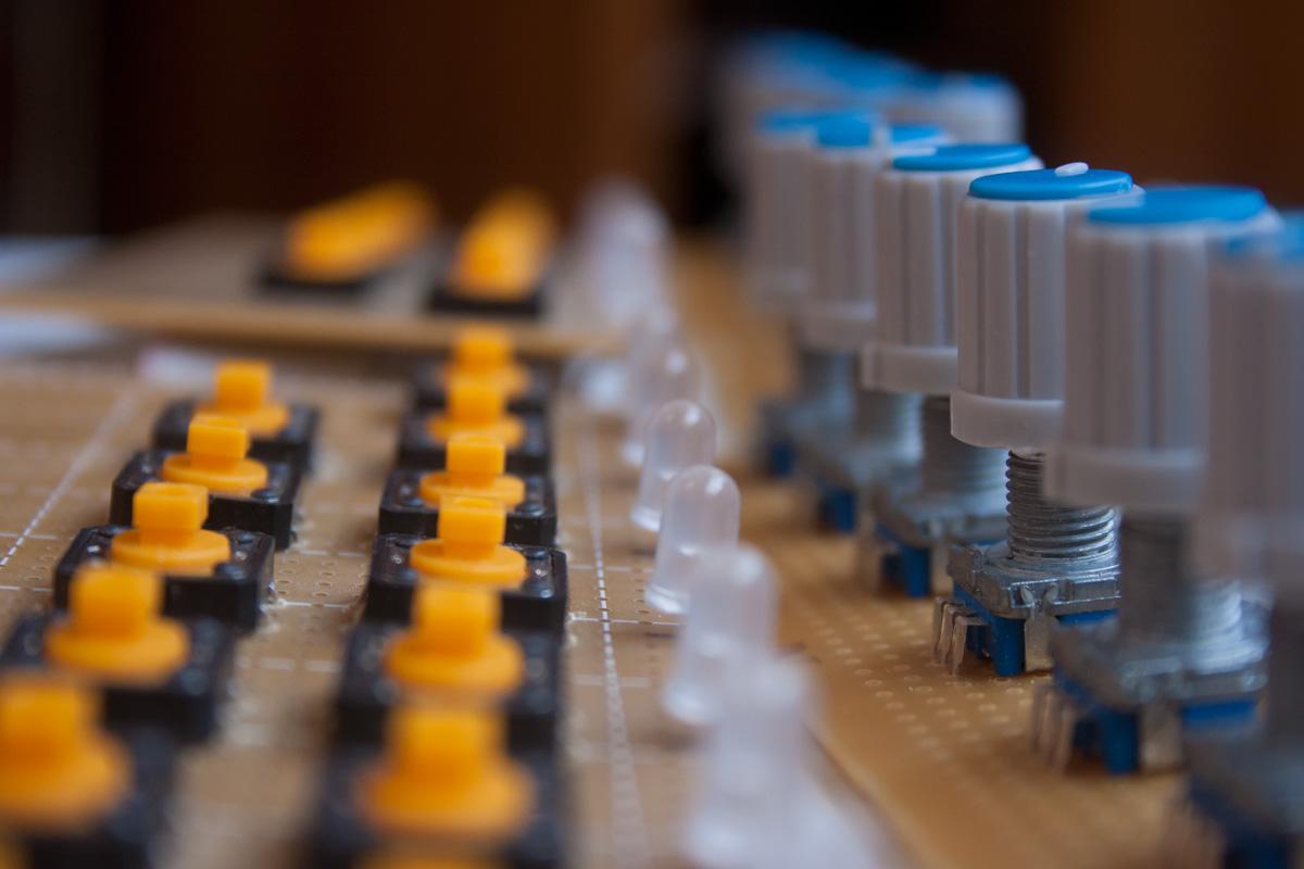

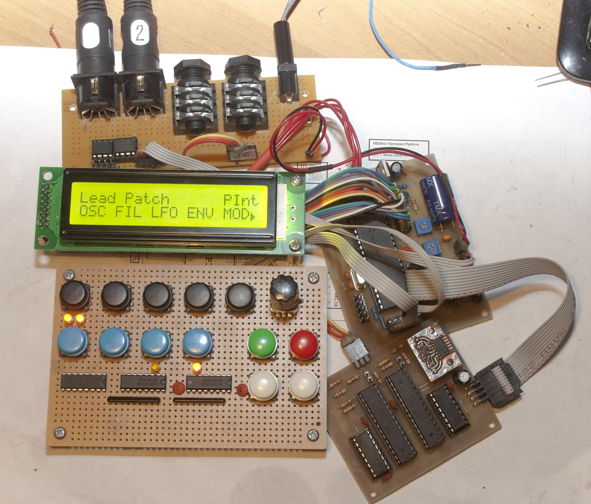

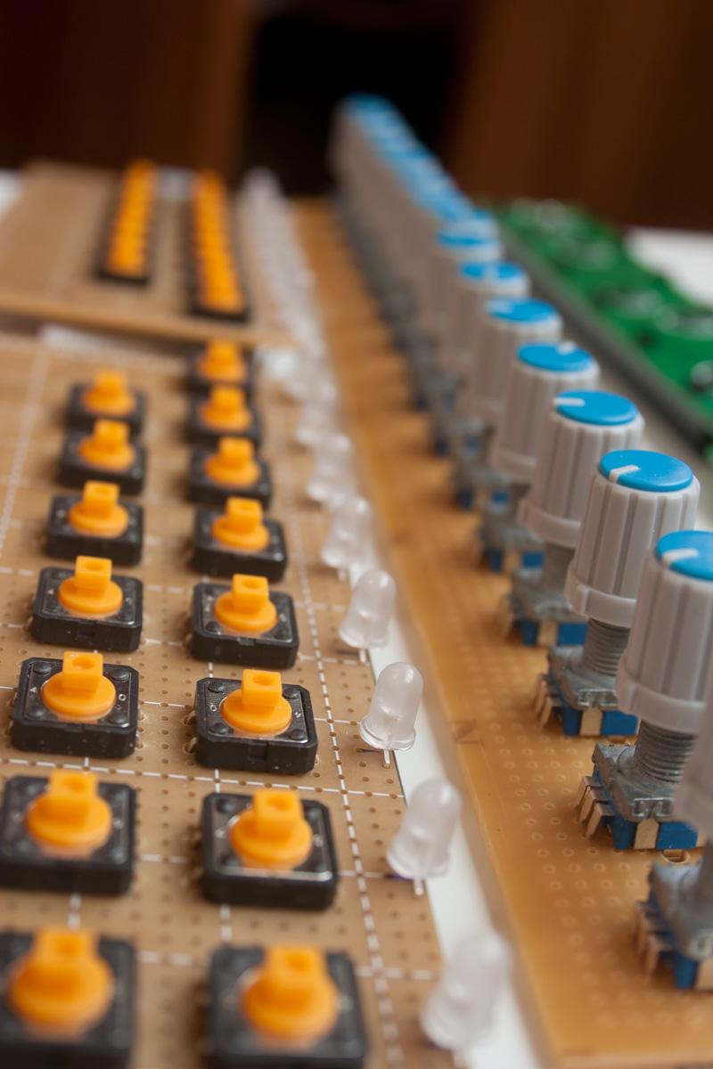

Hi Schrabikus,
Looks very nice (even on Veroboard)
What type of buttons and KeyCaps are you using?
Re: MG 6934
Hello, nlate
Buttons is futurlec.com $0.32 TACT006 Raised Tactile Switch, keycaps is $0.25 TACTWHT White Tactile Switch Button.
They saying about two versions of operating force: 160gf and 260gf
but shipping only 250gf, which is a little bit hard.
In future im planning to make buttons with CNC lasercut technology (like in Zvezda DJ controller)

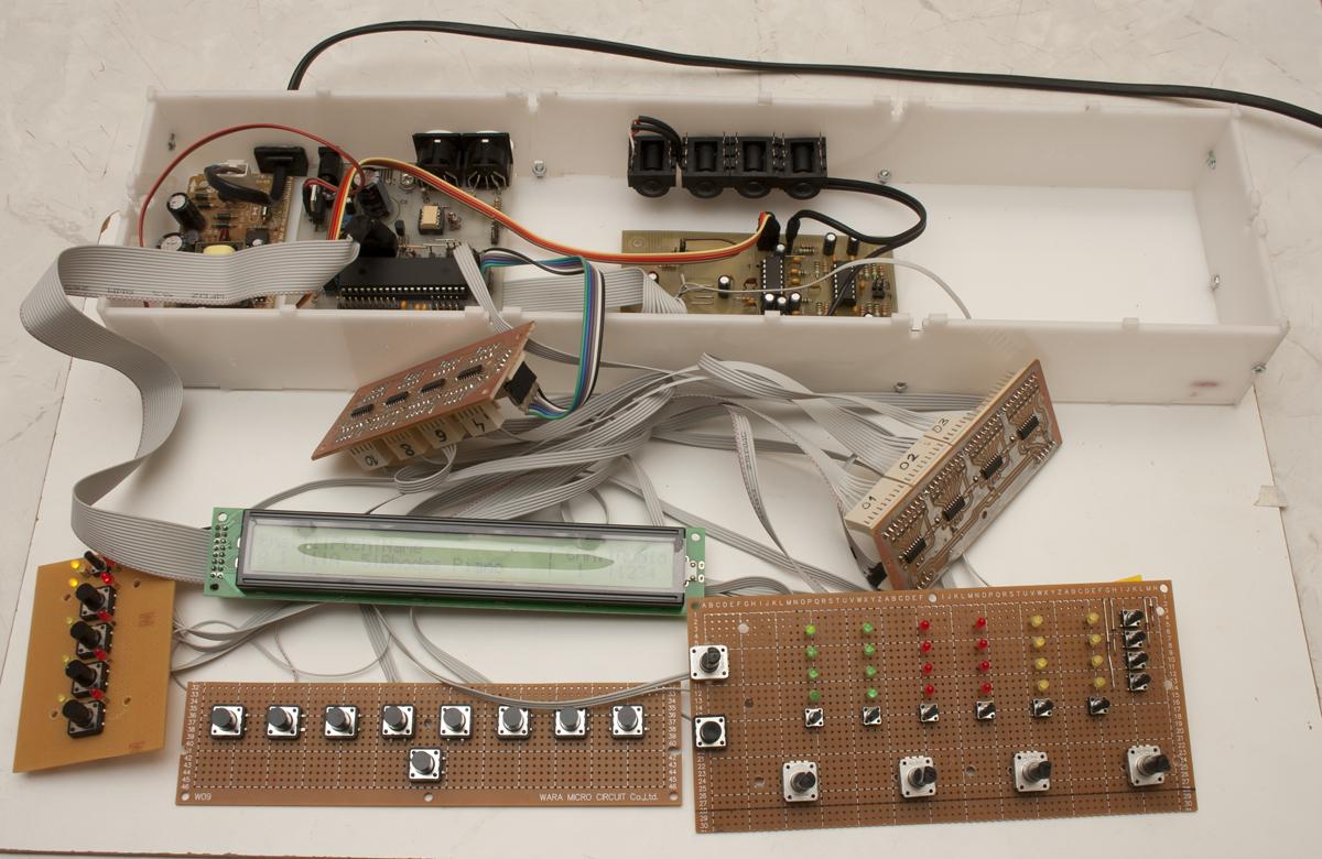

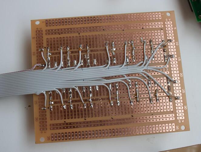

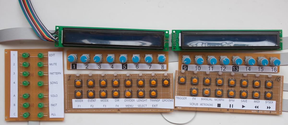

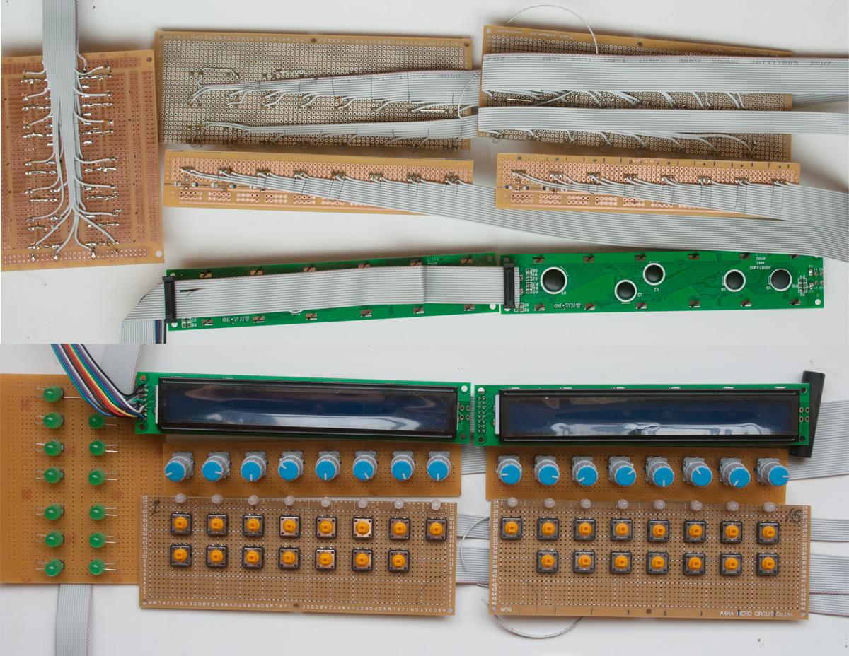

Re: Seq V4 vero Top
thats DIY! :thumbsup:

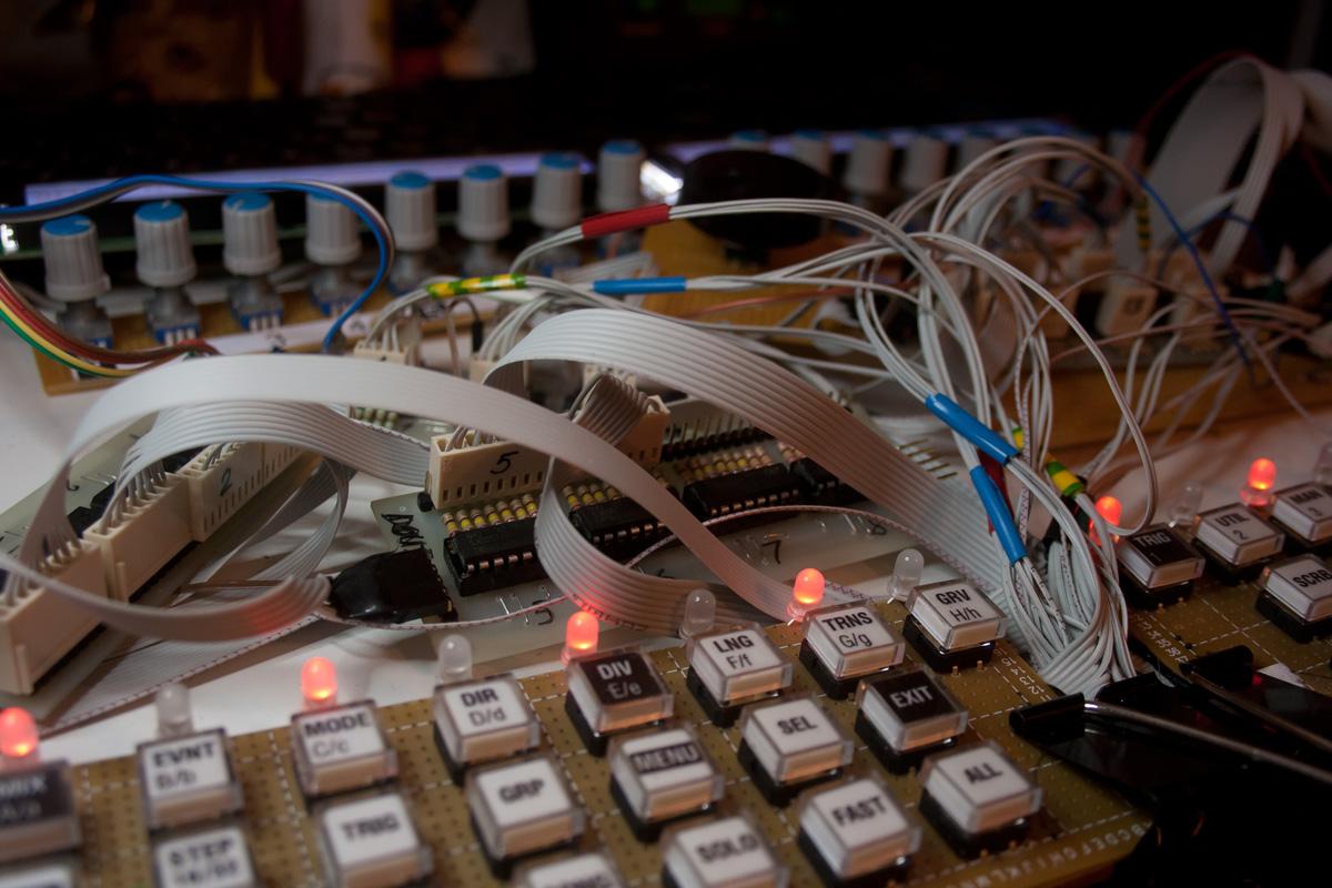

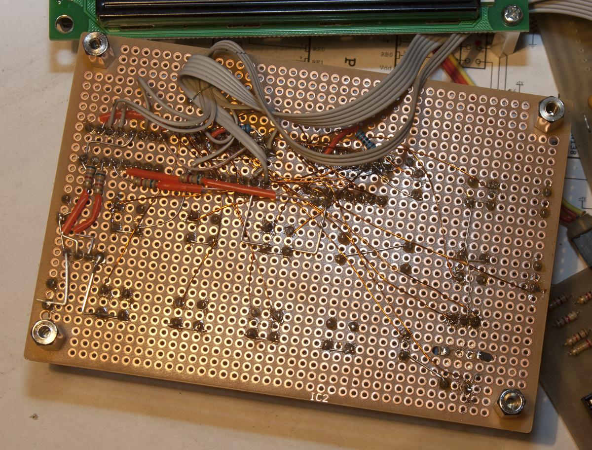

Re: Seq V4 vero Top
Lookin good! Did you test it?
Re: Seq V4 vero Top

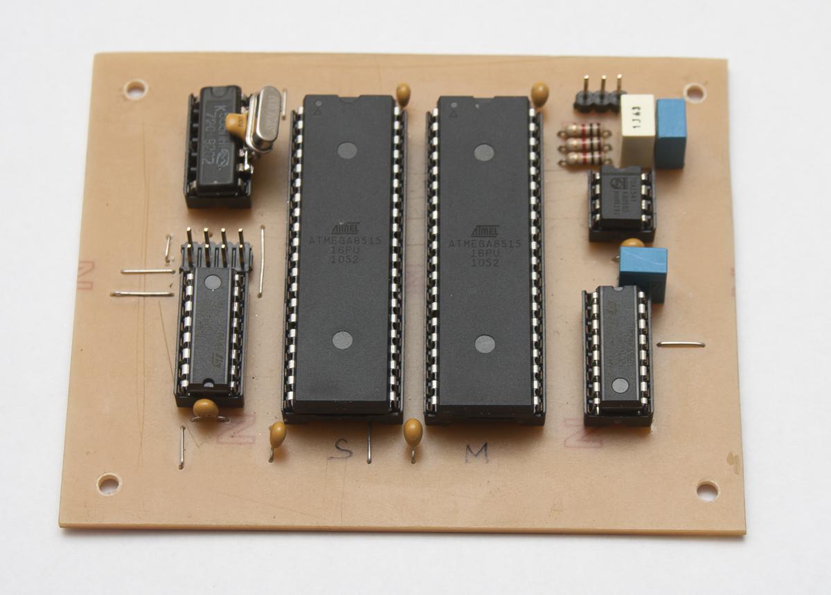

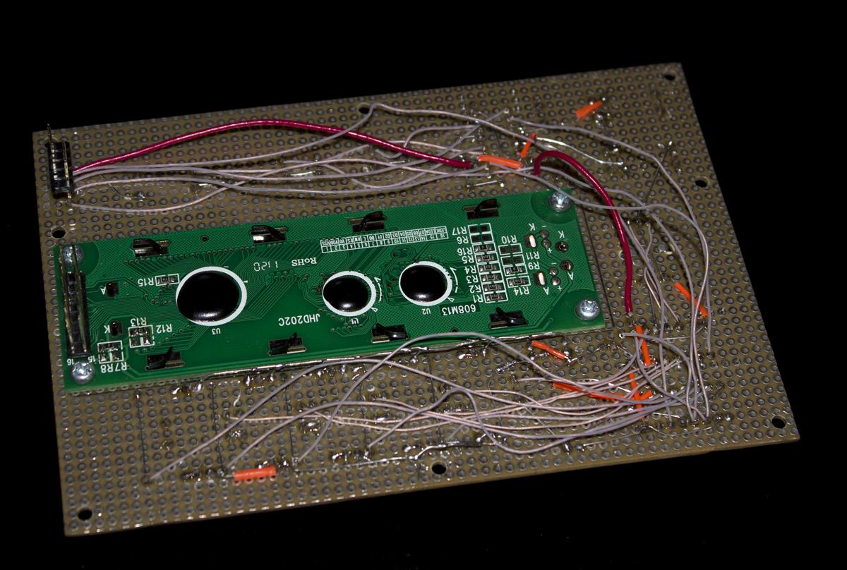

Yes, works perfectly. Veroboard is little bit thin, so i need additional fastening of sockets. But it is much faster and easier than home-etching of double-sided pcb. Ive understand that after making digital board for Shruthi =)
Now i am waiting for laser cutted case.

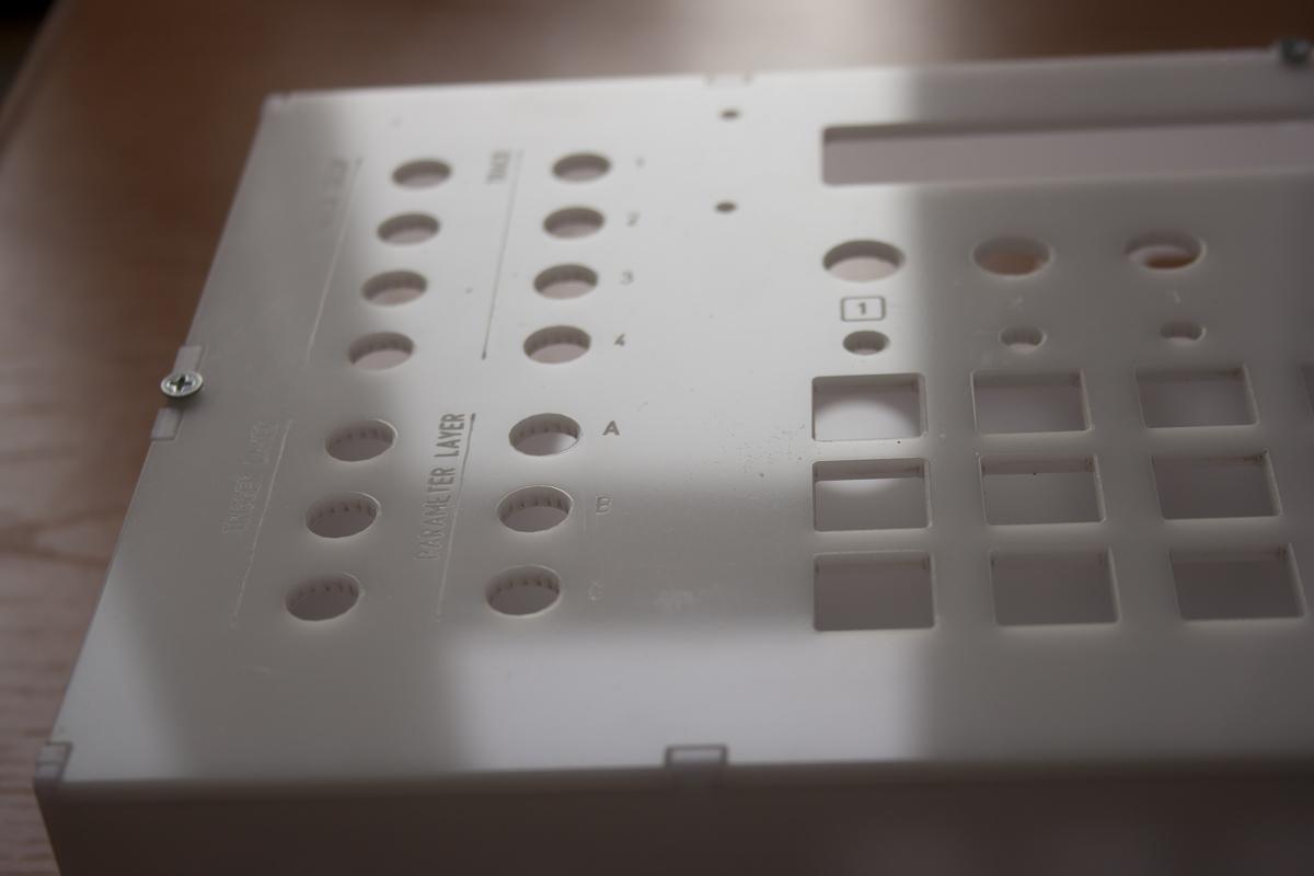

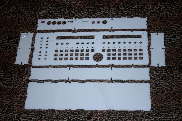

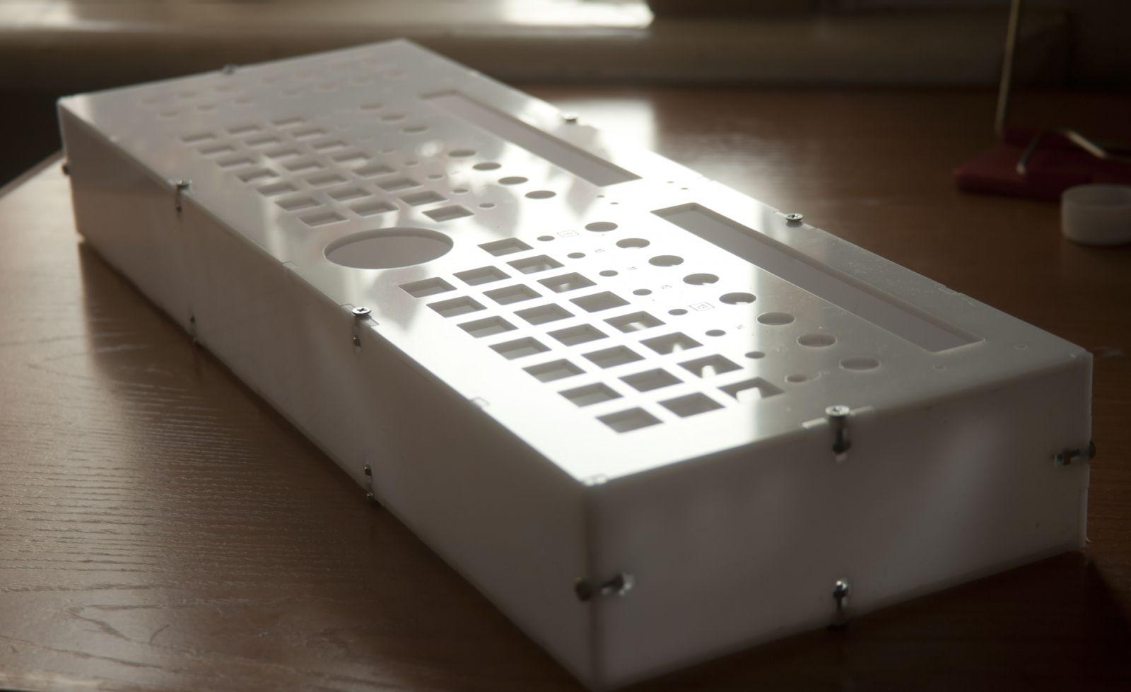

Re: Acryllic case CNC
Hey, that’s really cool. Could You plan to provide the CAD files of this to the public?
Definitely, but first i need to test it.
Oh I need this material for my mb6582 front panel :slight_smile: Looks nice!

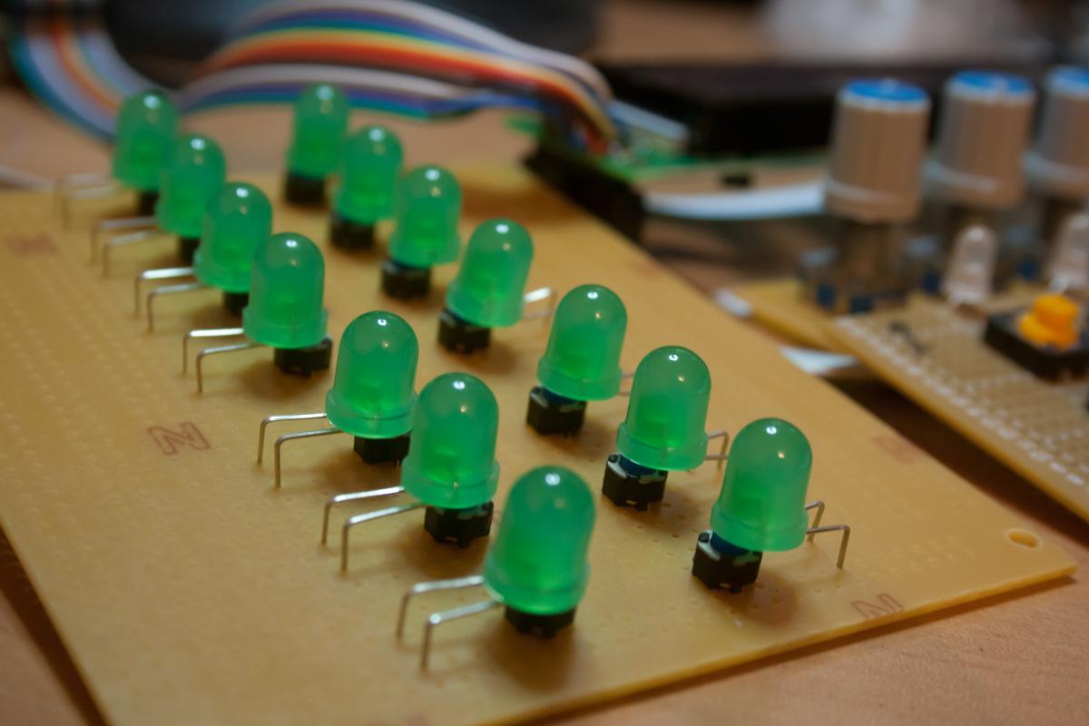

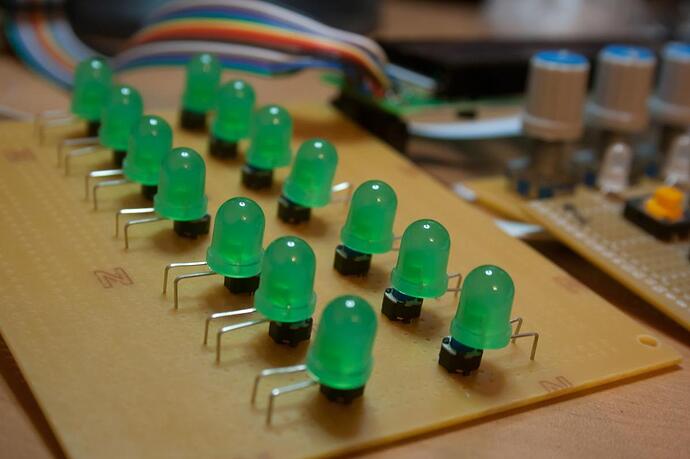

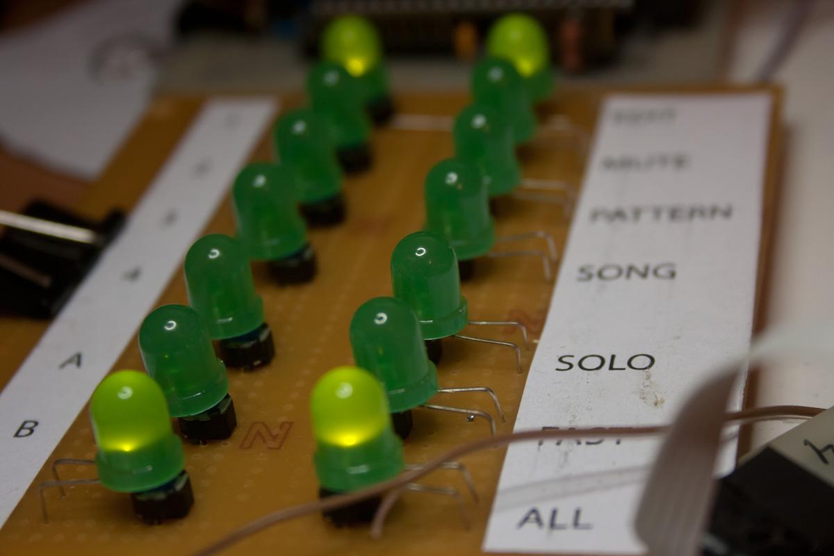

Re: MG 6880
very genial idea
led taster :slight_smile: nice
Re: MG 6880
Not mine
http://www.midibox.org/midibox_seq_blm_ext/
ИнтереÑный вариант Ñборки :thumbsup: Ð ÐºÐ°ÐºÐ°Ñ Ñ‚Ð¾Ð»ÑˆÐ¸Ð½Ð° акрила?
Re: MG 6880
LED like button - good idea. Thank you.
This is for 3 mm acryllic
Here is pdf for cnc laser cut. Red outlines is for engraving.
Edit it with Corel or Illustrator for your dimensions.
The idea has been taken from Shruthi`s case.
This for nuts and bolts joint, but you can glue it. Or i can make template for glue joint.
This one is for glue joint

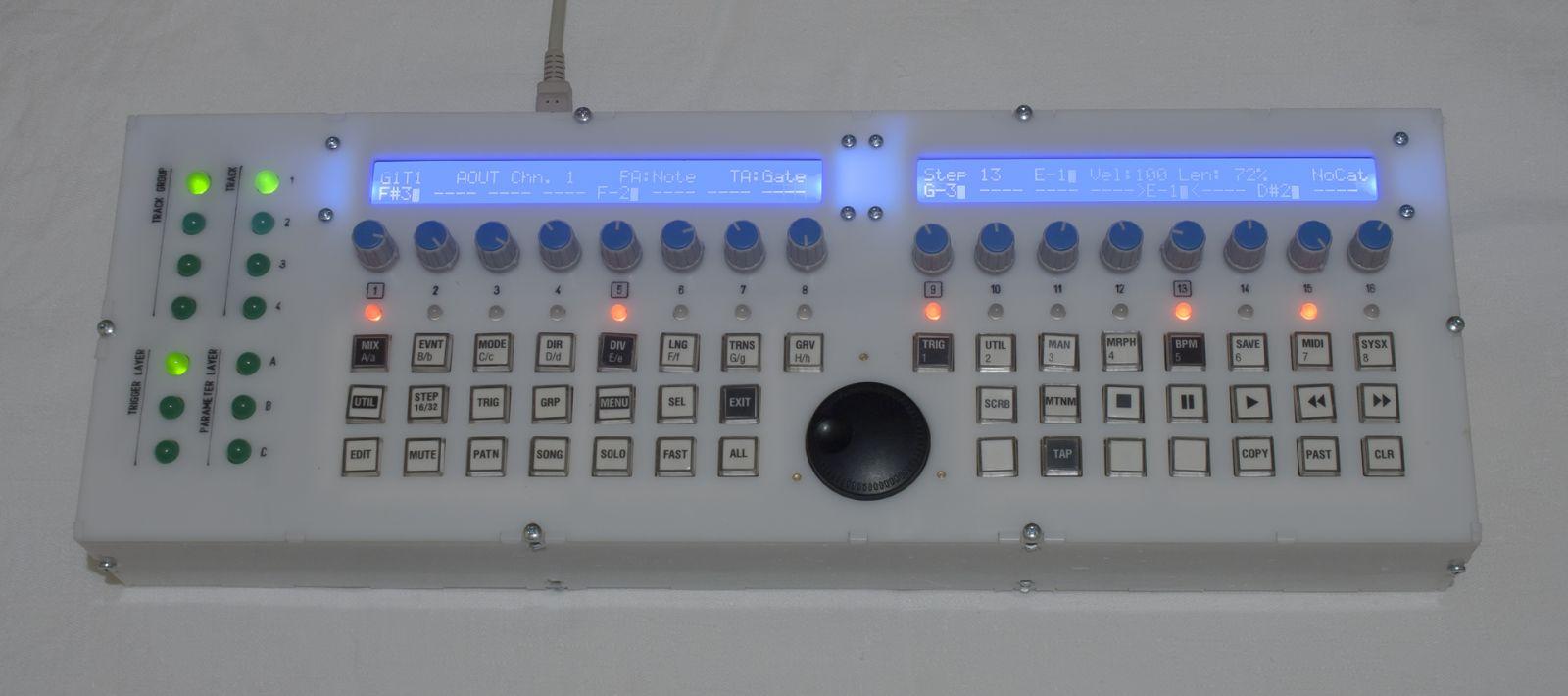

Re: mbseq case test assembly
Apart from that issue - its very cute! Well done!
Thanks.
Now i`m thinking about white or blue leds for track/layer selection - green are out of turn :logik:
