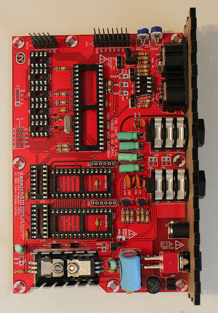

For those of us that haven’t seen your pics, what was the problem???
Cheers
Phil
Cheers
Phil
The pics are still there, but apparently flickr and our forum don’t always play nice… Here’s the pic again:
Ah yes an easy mistake to make (although not usually when mounted horizontally
Phil
Update: sammichSID is all up and running. This guy’s a 6581 to go with my MB-6582. Thanks gang - bring on the sammichFM!!!
Glad you got it working! Next time, stick to the build guide, okay? ![]()
Hi guys, I have a similar problem with my sammich. All the orange points (12V) are at +15.5V with no shaunts on JPB and at +16.9V with shaunts on JPB. All the other points are right.
My 7805 and 7809 are mounted correctly. Someone has any idea?
Points labelled “12V” won’t be 12V if you are using an unregulated power supply. Start a new thread and tell us what power supply you are using, the voltage, AC or DC, current rating, etc.
