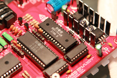

Desoldered and replaced the vregs. 9V rail now gives about 9.03V so that seems fine. 5V rail now gives 6.7V.
The new 7805 has 7.5V going into it, i.e., the Pin 1 to Pin 2 reading is 7.5V. The Pin 2 to Pin 3 reading is as before.
I will upload some pics in the next post in case that helps.
