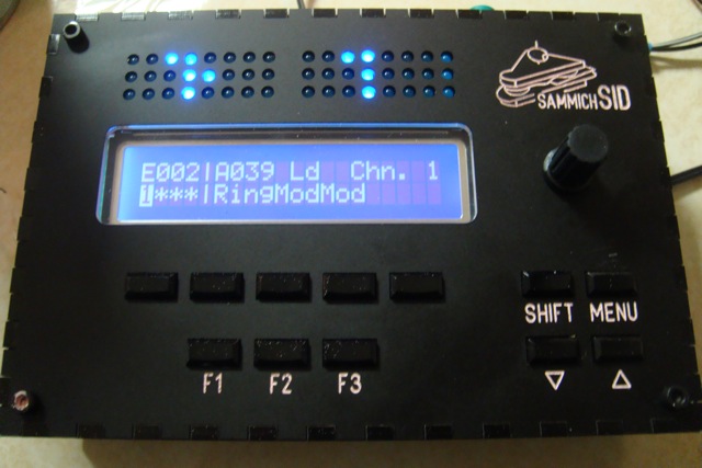

WOOT WOOT
Blue LEDs are evil! They will burn your retinae!
Having said that… your sammichSID looks really cool! Congratulations!
