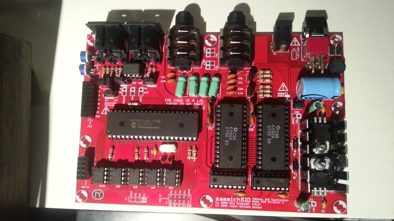

Hello! I ran into peculiar problem with my good old Sammich and can´t figure out what might be the problem. Any tips are more than welcome :slight_smile:
I built the thing myself about 6 years ago. It has worked fine for a long time but after a small break i noticed this:
Left output functions OK. RIght output is completely dead. I swapped the SID chips to see if it was the chip but the problem remained the same i.e. sound comes from left but not from right. So the SID chips seems OK.
Then i swapped the M74.. IC´s below the SIDs but no change in the issue. So I tried to probe-listen directly from the SID audio out pin and the left SID sounds ok and right one gives some quiet hiss/crackle (not completely dead as in the audio output though, but also not noticeable notes). In other words both SID chips works just correctly but not when installed to the right side/right output.

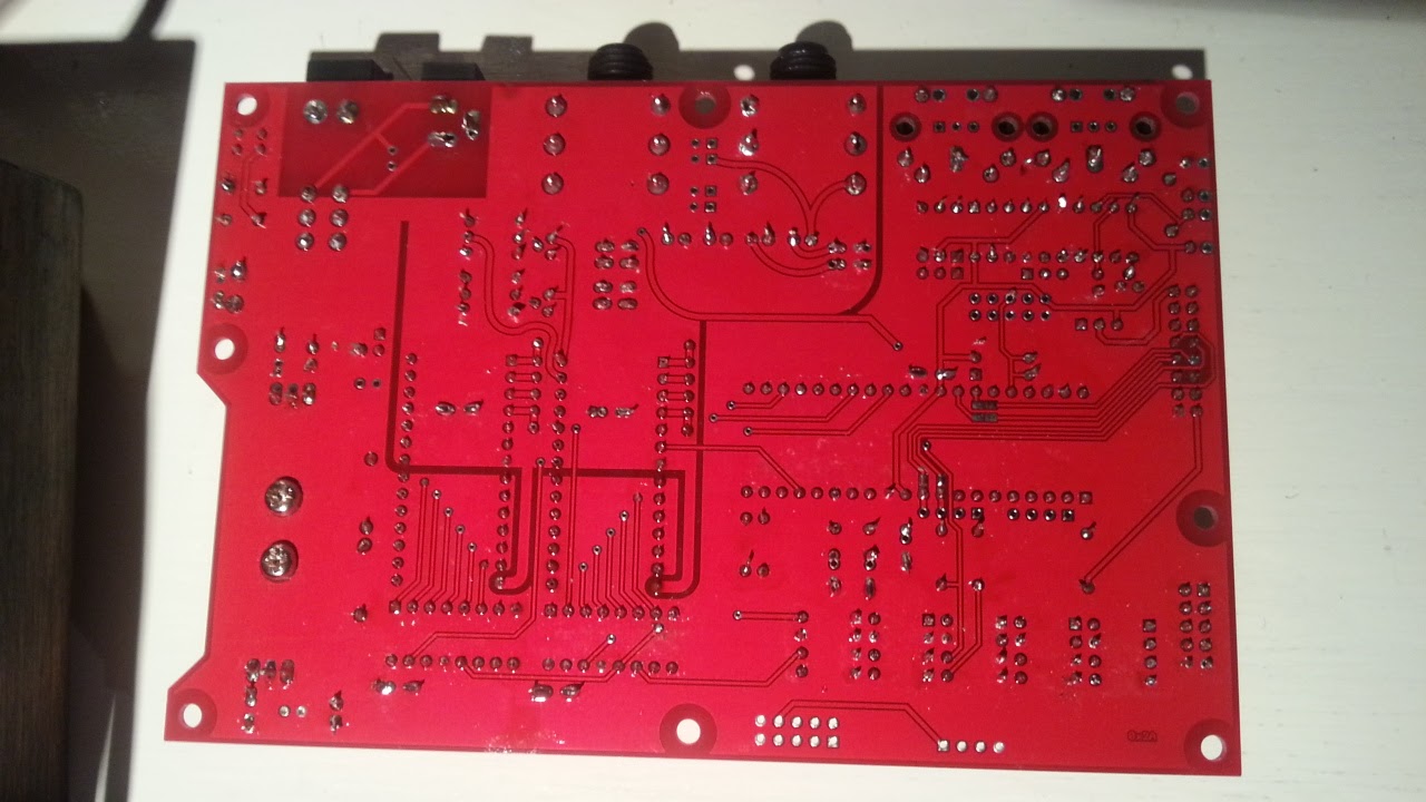

Been trying to search for bad soldering (well, i´m not too pro but still haven´t found any actualy mistakes or cold joints) but i´m wondering what the heck might cause this problem? I have a couple of different wallwarts with appropriate specs, and as I mentioned, this thing has worked before for some years…
Thanks!! :slight_smile:

recommendation: quickly resolder all solder points on the lower pcb, add a little bit of solder to each point after reheating. It might be a gone-bad solder connection, even if it looks good - i once had one on a core32 board - absolutely invisible, resoldering helped :). The process should not take more than 30 minutes, if it does not work, report back ;-).

thanks for your suggestion. actually i had, while looking for bad solders, gone thru the whole pcb with soldering iron just like you described. unfortunately that didn´t solve the problem though.
i was thinking about the transistor. but if the transistor was bad wouldn´t there be still a sound when listening directly to the SID audio out pin…?

ok so now changed the transistor and the 471 cap (which both i happened to have here ready) and they are ruled out not to be causing the problem. will be trying to figure this out somehow :stuck_out_tongue:

I have the same problem too but not with the sammichSID, I have build the stereo setup myself.
And my right channel is dead from the beginning.
I have burn the bootloader, mios and the application again, didn’t help.
I think there is something wrong with the pin 27 of the pic (J14).
When I replace connections between pin 27 and 24 of the pic the left one is not working but he right does work
I am going to buy another pic and try.
Ok, I have decided to buy a new pic. I have burned the bootloader, mios and sid app and now everything works. Looks like the problem was in the pic.
