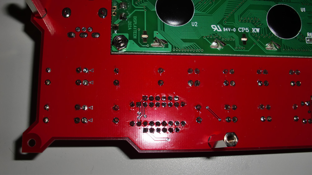

It all seems to look fine… I added 2 pictures. Maybe you can see anything strange…

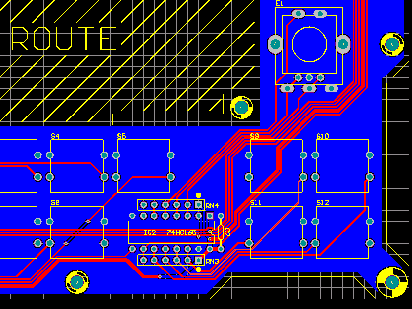

Can you check if RN3 is oriented correctly? (also check RN1, RN2 and RN4).
From this photo, I cannot see the label on RN3, which I expect to see on the side facing the IC. It is leaning away from the IC, and from that angle I can’t see any label.
The label should be •6A103G where • should be aligned with the white dot on the PCB.
Therefore, the label will be facing AWAY FROM the IC for RN2 and RN4, and facing TOWARDS the IC for RN1 and RN3.
This might explain the button problems… if RN3 is not placed correctly, then all the input pins will have a variable pull-up to 5V… if one switch closes, the other inputs drop from 5V to 2.5V… lots of weird stuff happens, I won’t bother with more explanation, but it would explain the multiple problems you have, and that one switch seems to be registered as other switch presses.
