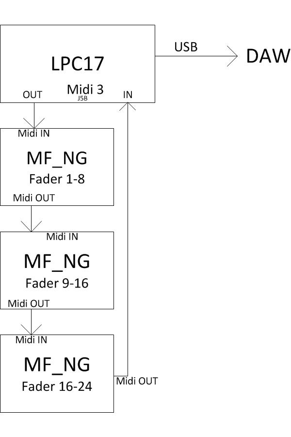

 So your Setup wold be a LPC32_Core connected to MF_NG over one of the 4 Midi Ports (i think TK. suggested Midi3 somewhere in this forum, i just can’t find it anymore…) anyhow its possible to connect over every Midi-port…
After chaining all the MF_NG, return to the Input of the same Midi-port…
I think to understand its easier with a schematic…

Novski: Picture explainet very well howto, thanks :slight_smile:

I just tested two HUI´s in protools.
running them in serial will not work.  1st HUI will control fader 1 and 9, 2 and 10 etc.  2nd HUI will only control fader 1 - 8
Running them on two interfaces works perfectly!!  In protools I can address 4 different HUI´s through MIDI,  they will show with different color in the mixer in PT.
Conclusion:  I must use novski´s plan.
3xMF_NG + 1xLPC17 over USB.

Alternatively you could just use a GM5x5x5 to collect the MIDI I/Os and convert that into a single USB cable. There was a bulk order recently, maybe someone has spares?
Edit: unless you do some programming, novski’s setup still only gives you 24 faders on the same MIDI port. For Protools that is in no way different from chaining the three MF modules and hooking them up via MIDI proper.

I’ll use 3xMF_NG + 1xLPC17 over USB and use 3 seperate midi io from LPC17, one to each of the MF_NG.  This will hopefully give me 3 seperate midi devices in OSX.
If someone can confirm this, it would be great. :rolleyes:
MBNG provides 4 separate USB Ports, which can be selected as dedicated interfaces in your DAW.
So, no need to use MIDI IN/OUTs (e.g. connected to a GM5x5x5) for this purpose :smile:
