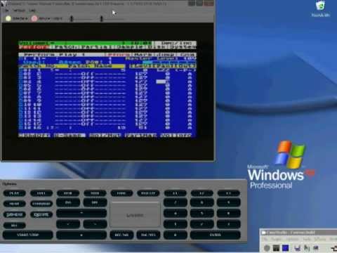

There’s these guys that developed some board that uses your computer mouse on some screen-in-screen  (not sure if that’s the correct term) view as a virtual sampler mouse:
http://rc100-usb.at.tt/
there’s a video here:
The thing is that you can’t really edit in depth with the screen / mouse while playing anyways, as once you leave the “Perform” mode, the MIDI channels get all routed to the Partial (1 sample assigned to a certain key span and its settings are called a Partial) that’s being edited, which ends up in a mess. There’s a workaround via the menus, but it’s quite slow (and I haven’t fully gotten it). Probably SYSEX editing would be possible somehow, but I have no clue how that kind of stuff works. It stops with CCs for me :slight_smile:

Yes I found this when I was looking for the protocol, it seems this guy has it but he sell his solution then he will not share the protocol, but we can ask him.
This solution is the opposite of what I was looking for, I don’t want mouse and CRT and I don’t want a laptop or a computer too. The goal is to get the 760 as a standalone machine, with a user interface which simplify the workflow.
For me it’s a lot of work for a machine I don’t use anymore.
