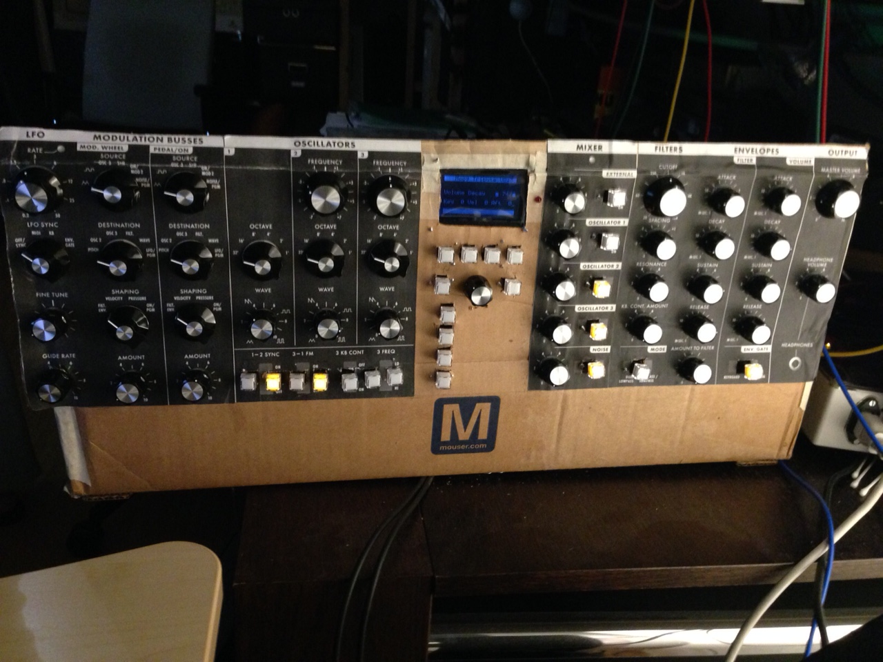

After over a year of development, I would like to start documenting my Midibox_NG project in this thread to collect as much information as possible for similar future projects. The idea is to keep all findings, questions and struggles concerning this projects in one thread to keep myself organised and to help future digital/analog synth developers.
As the title predicts, the goal of this project is to design and develop an all in one box digitised analog synth, similar to the MiniMoog Voyager. The synth will be controlled solely over midi. An LPC17 with Midibox_NG running acts as the main brain to read digital pots and switches of the control panel, save and recall presets as well as to drive the synth through multiple analog and digital outputs.
Analog synth hardware:
1x LFO
2x Modulation Bus
3x VCO incl. waveshapers as well as additional loops for other effects than the waveshapers (documented on: http://www.muffwiggler.com/forum/viewtopic.php?t=108794)
1x Noise generator
1x Ext_In
1x Mixer stage
1x 5Pulser (http://home.comcast.net/~ijfritz/sy_cir8.htm)
1x Ring modulator
1x Phaser effect
2x Moog ladder LP filter (to create a stereo effect through filter cutoff spacing)
1x Moog T904B HP filter (to create a band pass together with one of the LP filters (http://www.freeinfosociety.com/electronics/schemview.php?id=944)
2x ADSR (for filter and volume)
1x Stereo VCA
1x Headphone preamp
1x +/-15V & +5V switching power supply (I learned, that it is much easier to develop circuits with the additional “headroom” of +/-3V in comparison to a +/-12V supply)
1x Power board to generate +/-12V for the AOUT_NG modules as well as +10V clean reference voltage.

After a longer pause, the project is moving on. Find the documentation and schematics of my VCO, waveshaper & VCM design here:
https://www.muffwiggler.com/forum/viewtopic.php?p=1856429#1856429
The PCBs of the LP part of my VCF are ordered and the HP portion is in design.
Hey everybody. After some hot summerholidays it is time to work on my synth again.
Meanwhile, all the PCBs (except for the modbus/ DOUT board which still has to be designed) have arrived and are ready to be populated. [photos comming soon]
The 5Pulser and Ringmod board worked on the first try after the soldering was complete. It was still a lot of work cabling and tuning everything, but it all worked straight away which is seldom the case in my electronics experience.
I also just finished assembling, tuning and debugging the filter stage. This was a lot more work as the circuits are a lot more complex and have to work unisono. It is now possible to switch between using the two LP filters in parallel to generate a Stereo effect by phase shifting one filter or using one LP filter sequentially with the HP filter generating a bandpass and also phase shifting the HP filter to widen the band.
By using, switching and shifting I mean doing it manually, since these modules are not yet connected to the midibox controller. The analog part should be easy, as I configured everything already when I did the VCO stages. However, I haven’t tackled DOUT to switch relays as well as toggle LED buttons on the DIO MATRIX side yet. And since I haven’t done a lot of midibox programming/ configuration work lately, it will be a challenge again to get everythong hoocked up properly.
Next will be the ADSR and VCA circuits. The boards are populated and ready for testing.
The project is continuously growing. Thanks to TK, 4 AOUT_NG modules are working splendid now and he also helped by ironing out a software bug in the AINSER_NG module which caused problem in conjuncture with the DIO Matrix scan algorithm:
I finished all the front panel LED buttons, including the SCS:
Next up will be the LFO/Mod Bus/Noise Source circuit board on the hardware side and figuring out how to use a button to override a AINSER to AOUT value in order to mute a channel. No idea how this is being done. I guess it can be solved with SENDERs and RECEIVERs. In general, if someone knows how I can light an LED as well as set a separate DOUT pin with one button press, I would highly appreciate some help.
I am looking forward to post some audio samples or video of the synth working soon.
Regards,
Andy
