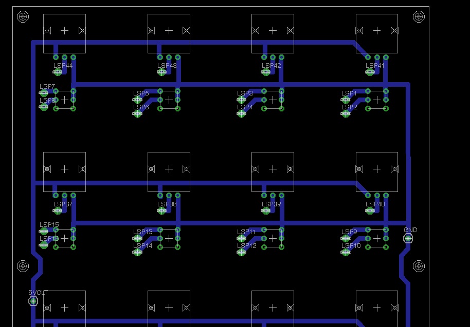

hmm I was quite surprised when I remeasured the potis with a multimeter and the values between the “wipe pin” (in the poti schematic the one in the middle) and the other two have changed drastically. Is this normal? I have additionally added a sketch of my setup. The four parts at the top are some potis. The middle pin is thought to be connected to the AIN.
Say your pot has three tags. The one in the middle is the ‘wiper’. If you set the knob to the middle of its travel, then measure between one tag and the middle one (the wiper) you will get a resistance. Now measure between the wiper and the other tag, you will get another resistance. If the pot is linear, both will be about the same. If the pot is a ‘log’ pot one will be much larger than the other. This is because log pots are often used for volume control, so that the apparent increase in sound level matches the response of the human ear.
