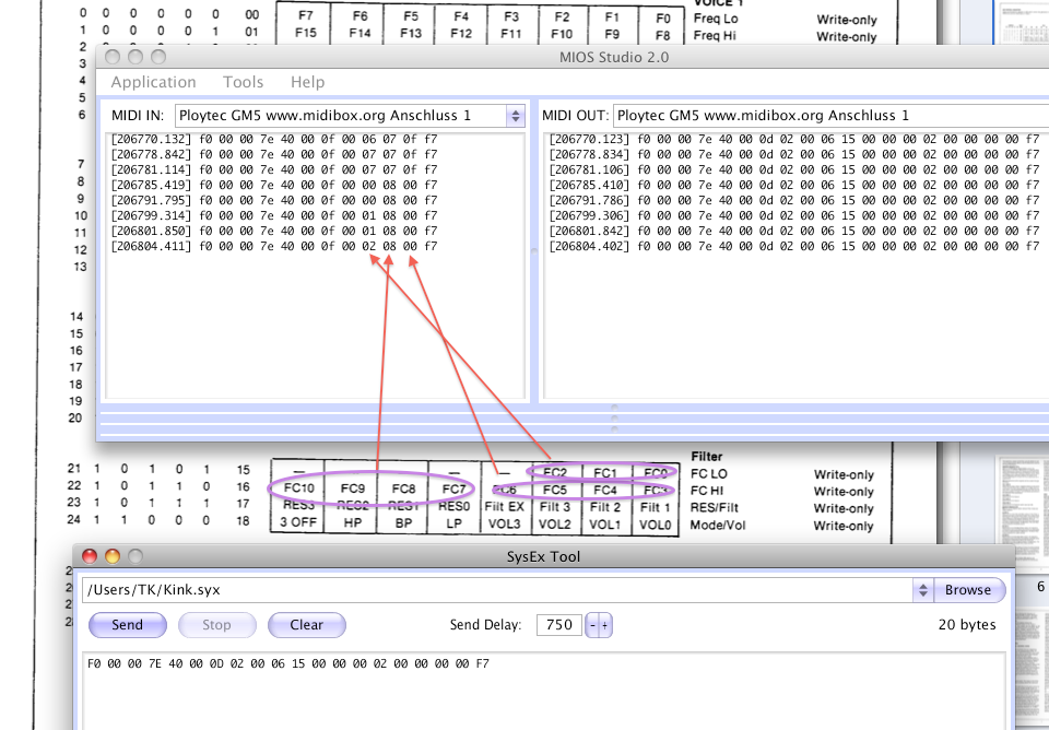

I also want to correct something from my previous post- I had it backwards about the 1 digit shift. With ensemble fil at FFF, the jump occurs between 800 / 801 and 400 / 401. In my tests setting the fil max at anything below 800 shifts the location of the jump down 1 digit, to 800 / 7FF and 400 / 3FF.

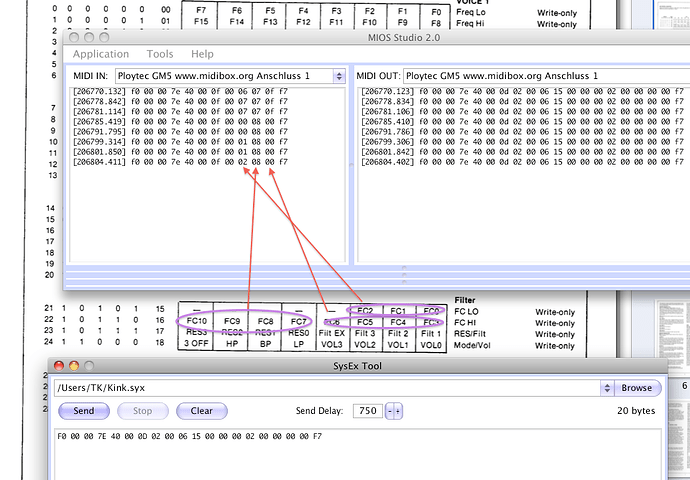

It also shows the corresponding assignments of the filter values with the register readout.
In this example, I changed cutoff from 7FE to 805 and requested the cutoff values after each step by sending the sysex string described above.
Note that the SID filter works at 11 bit only, but MBSID uses 12bit. Combined with the calibration routine the next MSB will be reached at 801 and not 800 - thats no bug (correct by construction), and under proper conditions it will never result into an audible effect (like on your MP3s)

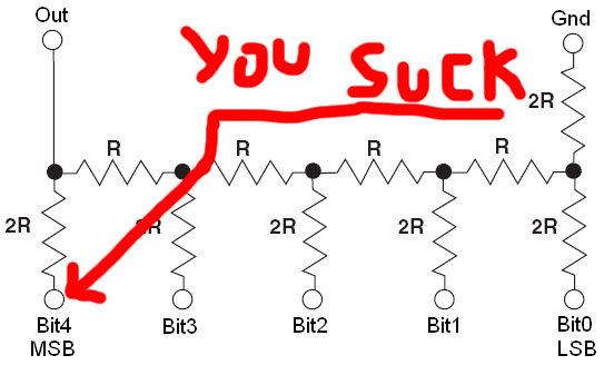

Resistors used with the more significant bits must be proportionally more accurate than those used with the lower significant bits ; for example, in the R-2R network shown above, inaccuracies in the Bit4 MSB resistors must be insignificant compared to R/32 (i.e., much better than 3%). Further, to avoid problems at the 10000 to 01111 transition, the sum of the inaccuracies in the lower bits must be significantly less than R/32. The required accuracy doubles with each additional bit—for 8 bits, the accuracy required will be better than 1/256 (0.4%). Within integrated circuits, high accuracy R-2R networks may be printed directly onto a single substrate using thin-film technology, ensuring the resistors share similar electrical characteristics Even so, they must often be laser trimmed to achieve the required precision.
I don’t think that the Rs were laser-trimmed in those years
So, how to solve this: I could add a fast accessible calibration table so that the “bad steps” can be excluded or smoothed out. It would consume 4k (not sure if so much is still available), but everybody would have to adapt it manually for his SID by editing the table and rebuilding the application.
Good work! 1980’s tolerances strike again. The wikipedia article is super informative.
