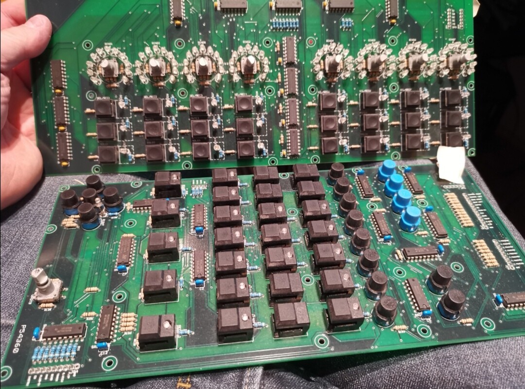

There are two professionally produced pcbs in this thing that i still have not found out any information about yet, i will put up some pics incase someone may be able to help, other than that im fine, it all came flooding back and im already working on the casework and upgrades.

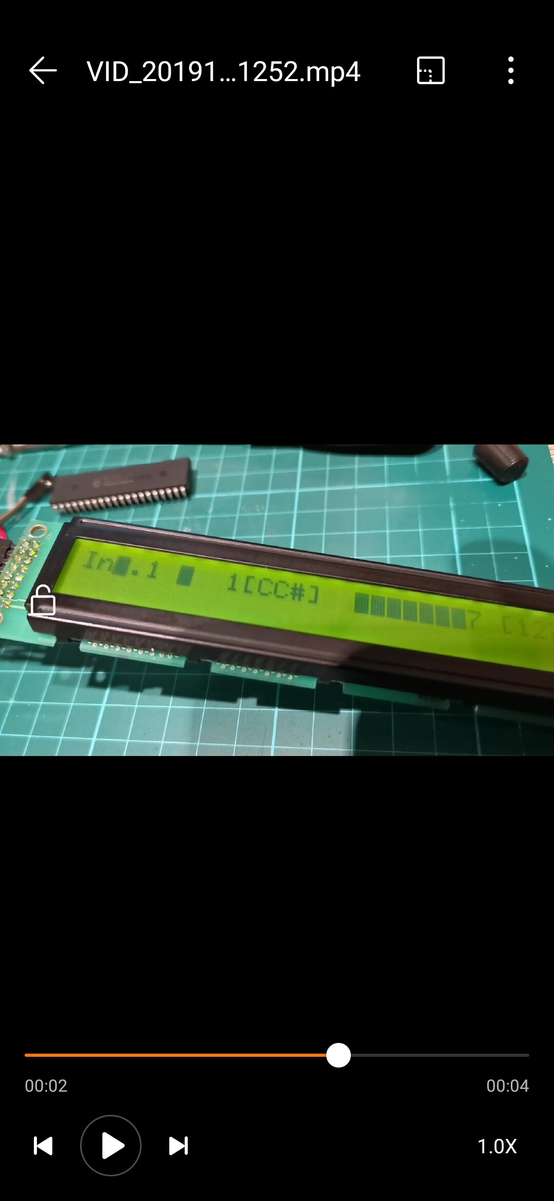

bit of a head pickle here,  i have one of the 40x2 lcds connected to a good core that i use for build tests.
With my usual lcd attached all is fine in backlight and contrast.
I have connected the 40x2 and the backlight is good however the lettering is very very faint, contrast seems to have no effect when i turn the pot other than it dissapears.
my core has the 7805 vreg on, i am just wondering if its not getting enough voltage, it displayed good on the old core board from the unit, but it was covered in really bad soldering.
there are new connection pins on the lcd and i have measured the voltage from both pots p1 and p2 and i get the correct voltages.
checked the link cables which are pushon with the multimeter and all is good.
bit strange this one.
The lcds are the TM402cd from tianma   https://www.beyondinfinite.com/lcd/Library/Tianma/TM402CBCWVBYA.pdf
connection is standard.
any ideas?
thanks
OK this is weird if I turn the core on and off I randomly get the display graphics come up for a fraction of a second then go back to being really faint. Contrast makes everything dissappear still.
Same core my test lcd
there is no datasheet for this model anywhere however, looking at close variants the v0 needs 0.3v negative feed.  Seeing as these are old lcds anyway I am going to change them out for a pair of new winstars
What LCD driver is set in the Core bootloader? Maybe check that?
I used the original core from the mblc it’s the v0 pin it wants a neg 0.3v link. This old lc had a separate power link board that gave it that. Had a dig around it last night. They are very old displays now, much better options are available now. Replacements arrive tomorrow I am just playing with this until my other parts arrive from modular addict. Making a newer controller with the new mf board etc. I just wanted to have a fudge with this old mblc
The new displays turned up today, all is good. Working first time, the old ones will be used for something else. I have a load of stuff on order from modular addict.  Need to build a few controller’s for the studio.

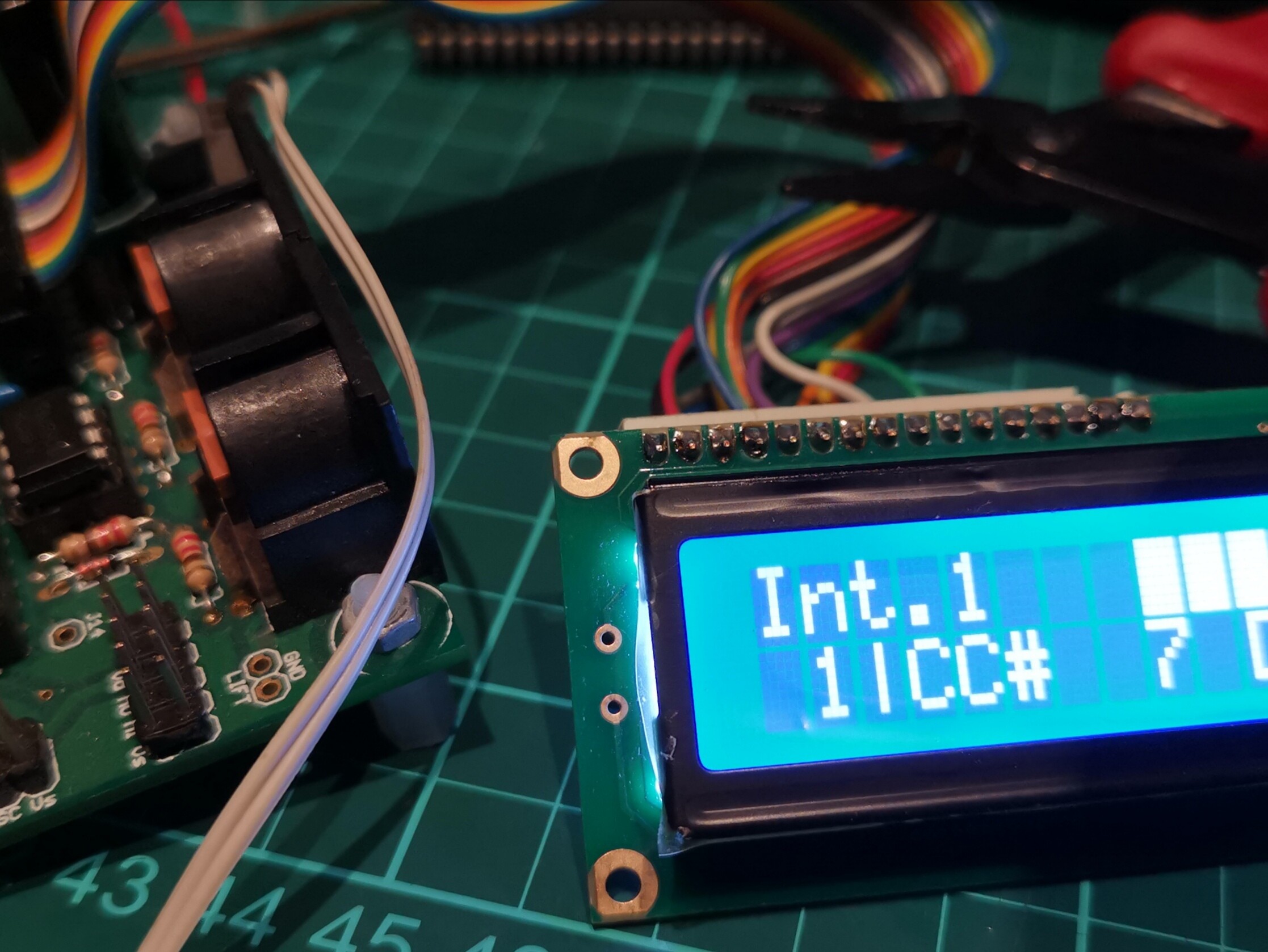

i picked up a pickit 3 programmer and made a pic socket link pcb in work. uploaded the bootloader to the pic then mios and all was good ;)  its been a while since i was here and its all coming back!! hurrah!
just have to wait for my bits to arrive from modular addict which is always the bit that is annoying, i remember waiting for kits from smashtv!!

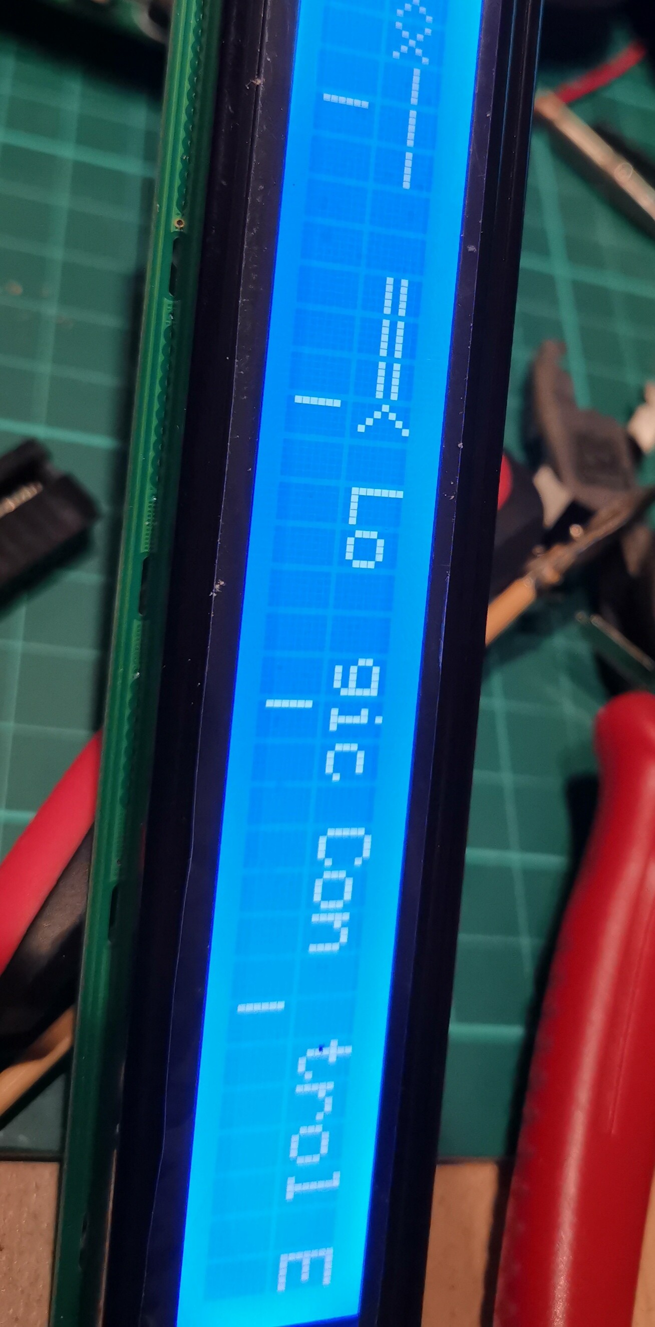

the picture above was from an old core and wasnt displaying properly on the new lcd, a quick bit of code and all is well again, no spaces etc.
I am trying to find out the details on the pcbs that were inside the unit and also details on the layout on the Holt case that it came in.
If anyone has any details on the boards let me know!.
Fancy! If these are custom PCBs they would’ve been very expensive back in the day!
the boards are well made, plenty of connection identifiers in the silkscreen, some led connections are missing and they are soldered to pads under the pcb and wired around it which i will sort out in work by adding some connect pins.
There is no info on these boards on the server, i did notice that Dan D2K used them in his mblc units but there is no info there in the forum thread, its old and any links are long gone, they are easy to understand the circuit paths etc but more info would be good as well as placement and position etc from a new front panel, I am hoping the Holt who did the original case still have some details.
