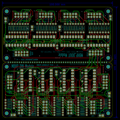

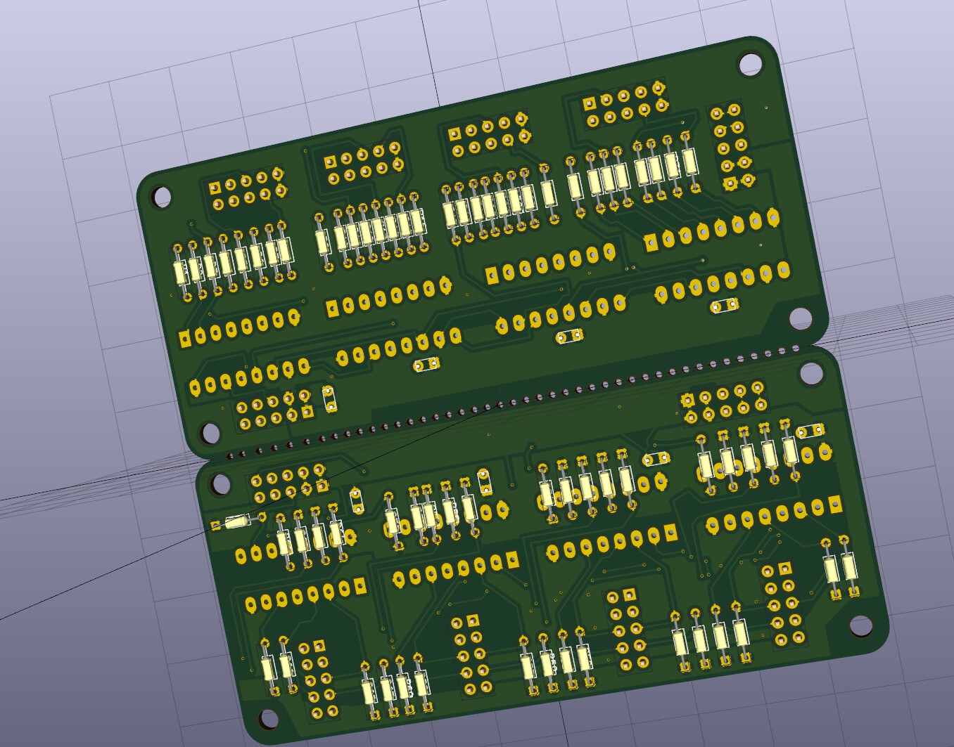

I designed a PCB that combines a DIN x4 and a DOUT x4 on one small PCB.  The modules are connected by traces, so they’ll work together in series using the PCB connection, or the board can be split in half so the modules can be used separately.  The board is less than 10x10cm, so it can be printed extremely cheaply at places like DirtyPCBs (~$16 for 10 boards) (I think SEED is offering even cheaper 10 packs of 10x10 boards as well now, but I haven’t tried them yet.)  Resistors are mounted on the back of the board.  Ground planes on the front and back of the board, back of the board has a VCC plane zone as well.  Mounting holes match, so modules can be mounted on top of each other if desired.
Anyway, I haven’t done much PCB designing, so if anyone happens to notice any errors in this thing before I get them printed, your comments or suggestions would be appreciated.  Once I’ve done a print run and have tested them, I’ll publish the gerbers/brd files, etc. for anyone to use.

few things…
-try to avoid 90° angled traces
-try to place capacitor as close as possible to VCC pin of each chips
-why don’t you use resistor network to gain space an make routing easier ?
-a common basic practice is to use one side H traces and other V traces, you mix a lot at both side, I’m sure you can optimize a lot of unnecessary via with this simple rule
-dual sided TH component will be a pain to assemble when component hide other side hole, you can place resistor vertically at same side with a 2.54 pitch…
Best
Zam

Just noticed your first comment - thanks, those points are totally useful, particularly the H traces on one side and V traces on the other thing…
I guess 90 degree traces are bad because they’re more likely to be screwed up in the board manufacturing process?
I didn’t use R networks because regular resistors are cheap and I always have lots around, whereas I generally wind up having to order R networks.   I figure all of the parts on these boards are common enough that people often would have them at home already rather than always having to make a special order to make these boards.

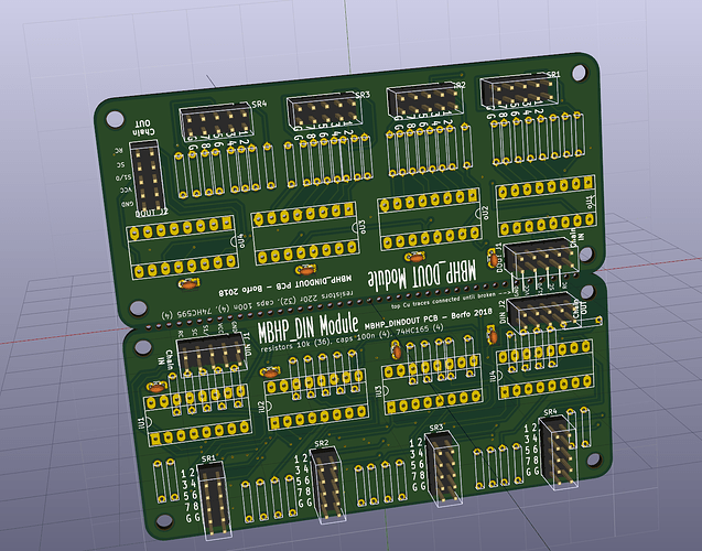

OK - I rerouted the board, it’s laid out better now.  All components are on top, traces are a bit less of a mess, I added a few 5v/ground headers on each board, and I connected S1/S0 properly so the boards will (or should at least) work in a single chain.
Can someone please confirm it is ok for me to bridge (1) pin 7 to pin 8; and (2) pin 9 to pin 10 (the serial and latch clocks)  on the J1/J2 headers?  Looking at the MBHP_DIO_Matrix schematic, it looks like this should be ok.
I’ve printed a first batch of these boards, and have assembled a couple.  Haven’t had time to test them thoroughly, but I figure I may as well post the Gerbers anyway in case anyone wants to print some.  Let me know if they work for you, or if you find any issues.
