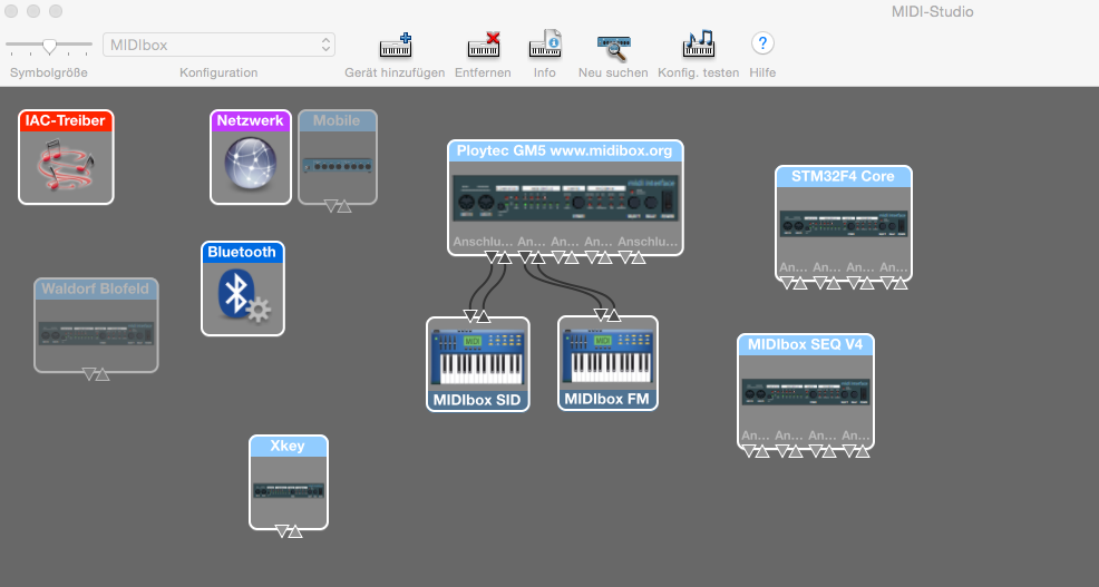

No problems at my side, I’m using MacOS 10.10 as well:
If MacOS shows the wrong number of MIDI ports, it could be related to your Audio MIDI Setup.
See also the bottom of this page how to fix this:
http://www.ucapps.de/mios32_bootstrap_newbies.html
Best Regards, Thorsten.
Thanks TK!
I tried that multiple times yesterday without sucess, but I did that just now and it worked. Not sure what to make of that, but it works now! Maybe I needed to reboot a few times or something? *shrug*
Either way, I’m up and running now! Thanks again for the help!
