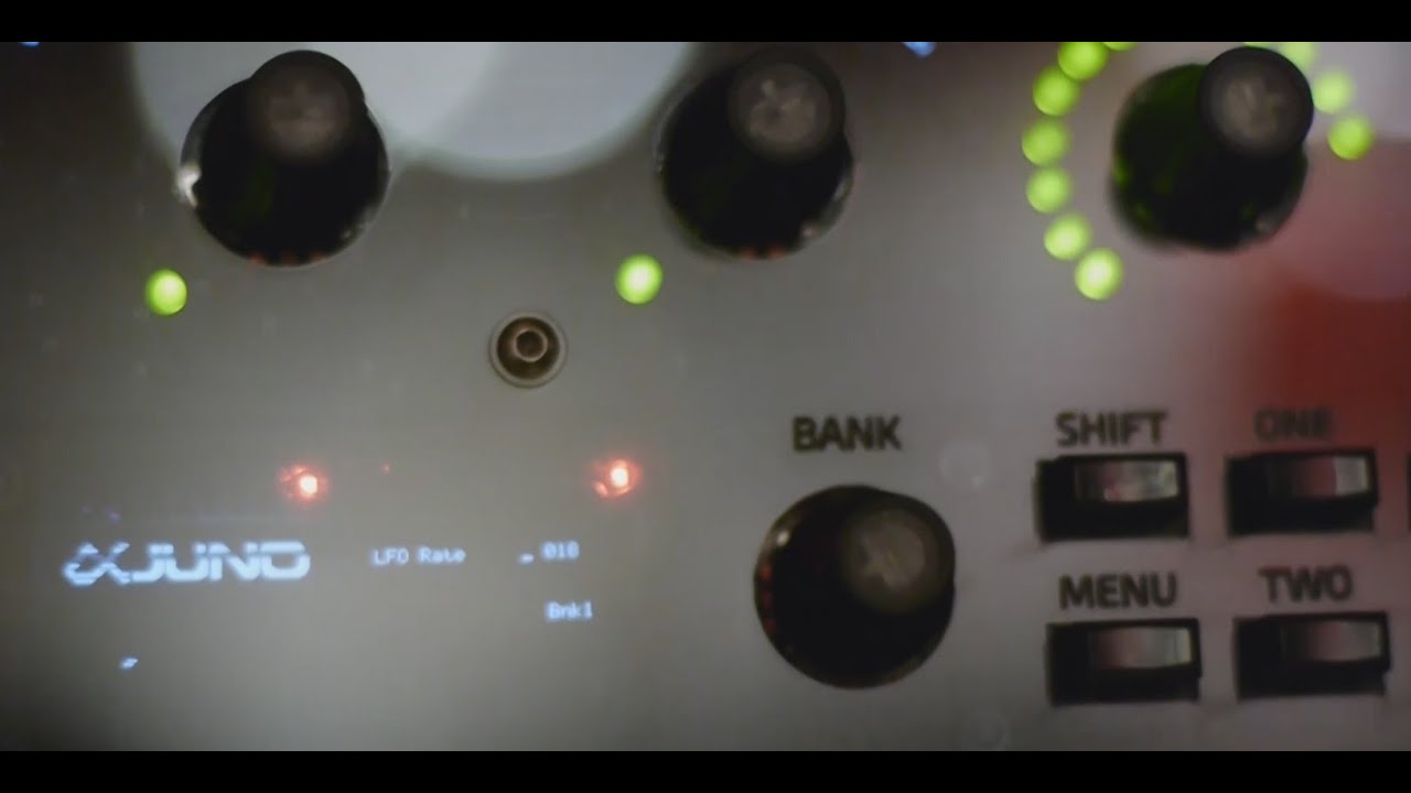

 MB-Programma V0.1 setup at work:

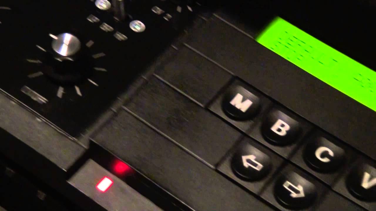

Also See MB-CV V2 demo:
Thanks, but i see no SCS in action :wink:
Is there no video of Hawkeye’s Programma v0.1 monster? I would like to see the bottom section in action.

Ok, regarding “MS-20 filter clones x 2 - MIDIbox CV V2” i see 4 OLEDs and one LCD. So its possible to mix displays after all? Is this only available for Midibox CV V2 or custom code?
