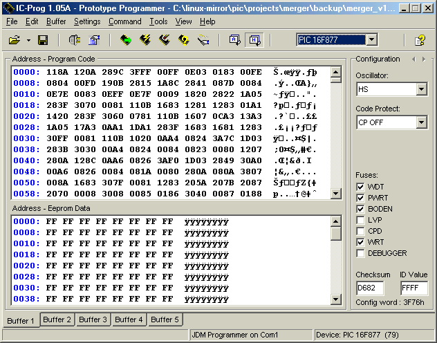

Question: what must the CONFIG header (fuses) be set to in my programmer?
It being a hex file I don’t know what the CONFIG should be, apart from high speed crystal.

Hi,
here are the fuse settings:
They are also part of the .hex file.
This means that some programmers automatically will get the correct settings if they extract the information from the .hex file
Best Regards, Thorsten.
