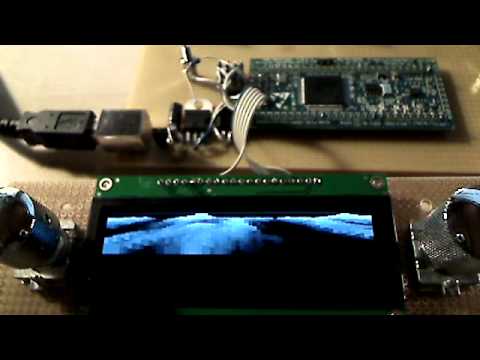

I did a fair bit of Newhaven OLED display hacking in the last years, and sometimes it works out of the box, sometimes it is a mess because of messy documentation :slight_smile: :
