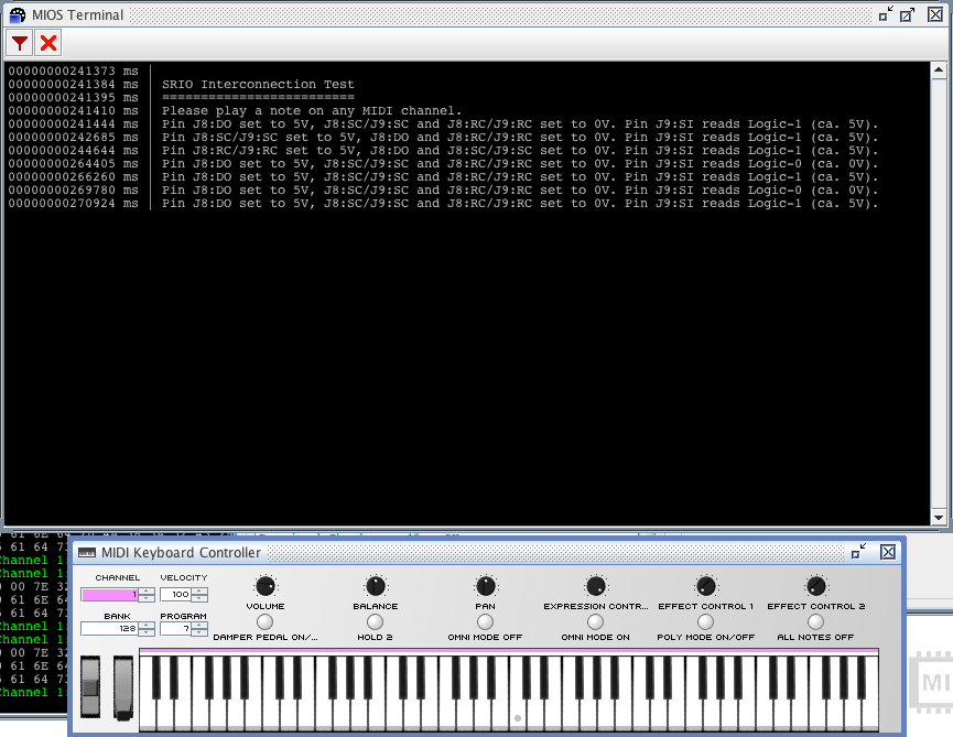

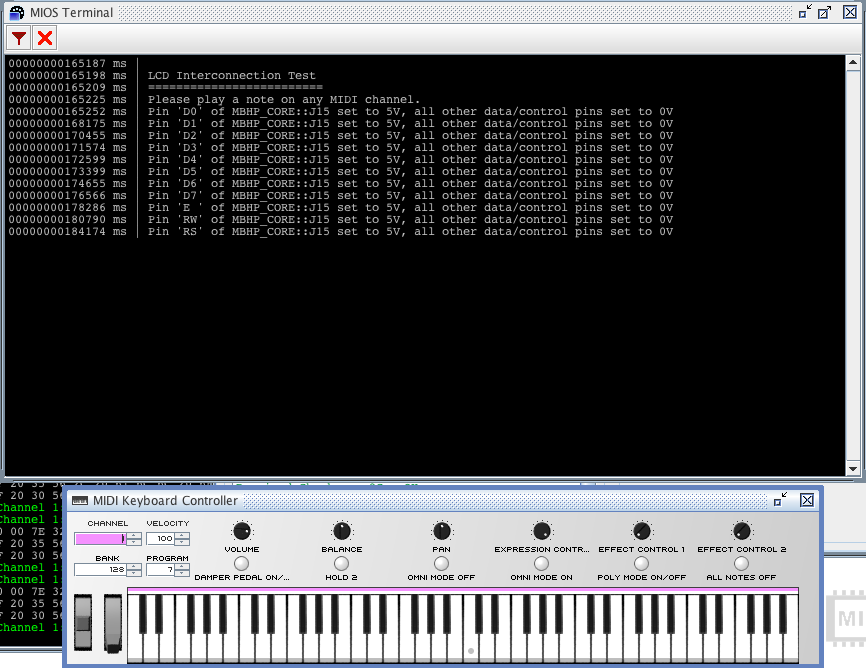

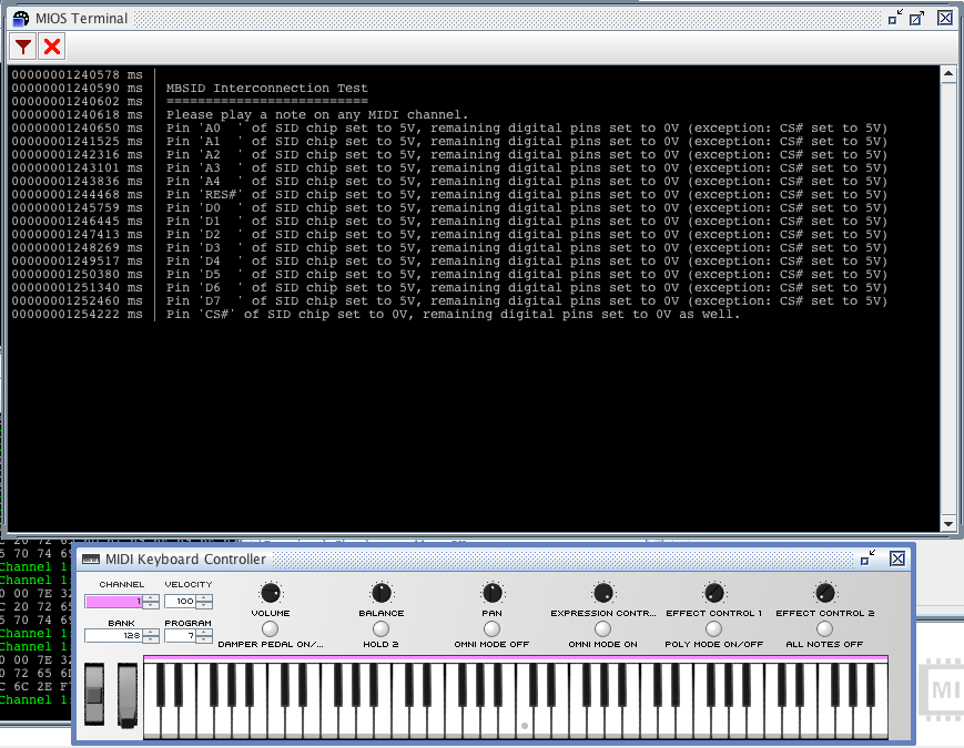

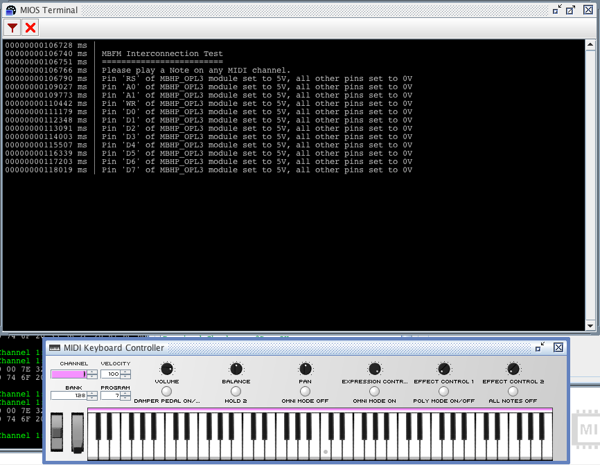

I overworked the four existing interconnection tests for more comfortable usage, especially in conjunction with MIOS Studio.
Instead of controlling the pins with the Modulation Wheel, they are now set with Note On events, which can be sent from the virtual keyboard.
And a message about the current pin states is sent to the MIOS Terminal whenever a Note has been received to give you a clear hint about the voltage level you should read with a multimeter. Accordingly, no LCD is required for these checks anymore.
