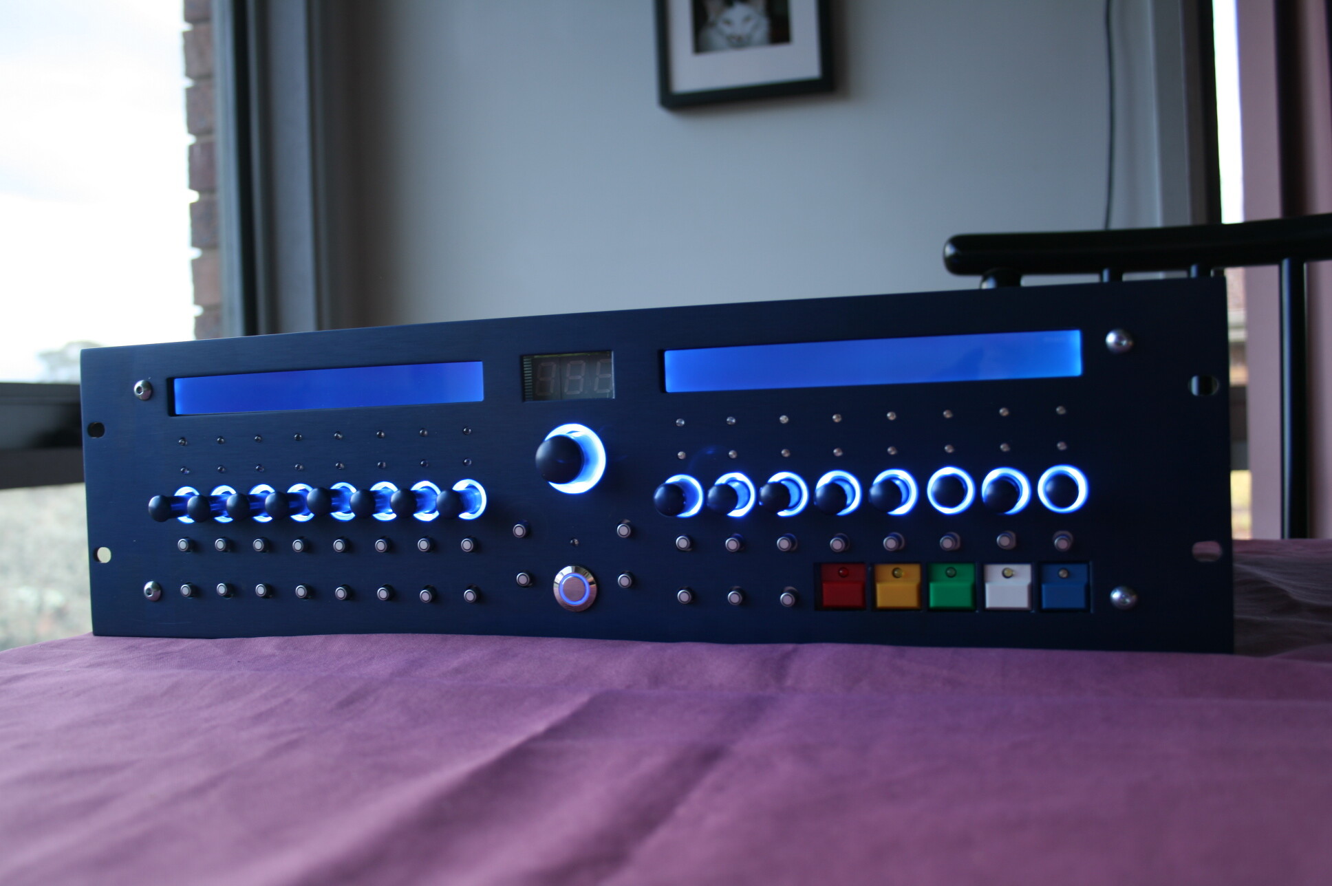

Making good progress so far havent come across anything i couldn’t figure out eventually myself :slight_smile:
so i thought i would share some pictures with any who are interested

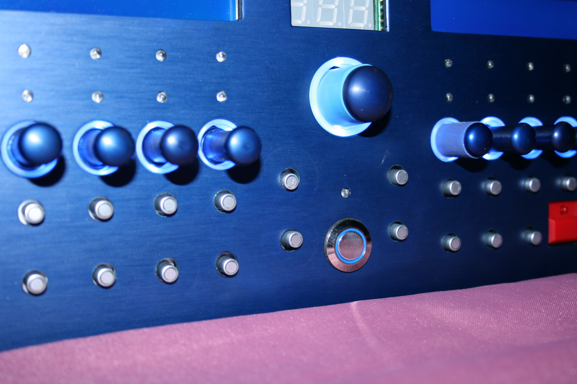

The knobs i made myself from some 12mm ally round stock and anodised blue i still have to provide a soft grip on them
and will probably try some silicone tube in a bright blue colour
Looks very nice!  I’d love to see some closer details of your knobs and light rings.
Cool! Looks sharp!
I recognise those buttons, I was looking at those in Jaycar (A electronics store in Australia) the other day.
Also, the centre button, I was looking at getting some of those, but was unsure about it specs etc..
How hard is it to press the centre button? Is the LED 12volt? (does it have a limiting resistor in it?)

That’s one pretty seq! Awesome work ;D
Hi diablojoy, congratulations on your sequencer and welcome aboard. It looks very, very good by now! I appreciate DIY-ing of those knobs! Illumination looks very even (no spotlights). Can you please post more internal pictures?
Yeh, nice! Can you tell me about the LCDs too? Blue 2x40, that’s rare as… Only one I know of is the optrex and those aren’t them…
Seriously? I’m having more trouble finding red [or orange] ones. Blue ones are in stock at reichelt for example.

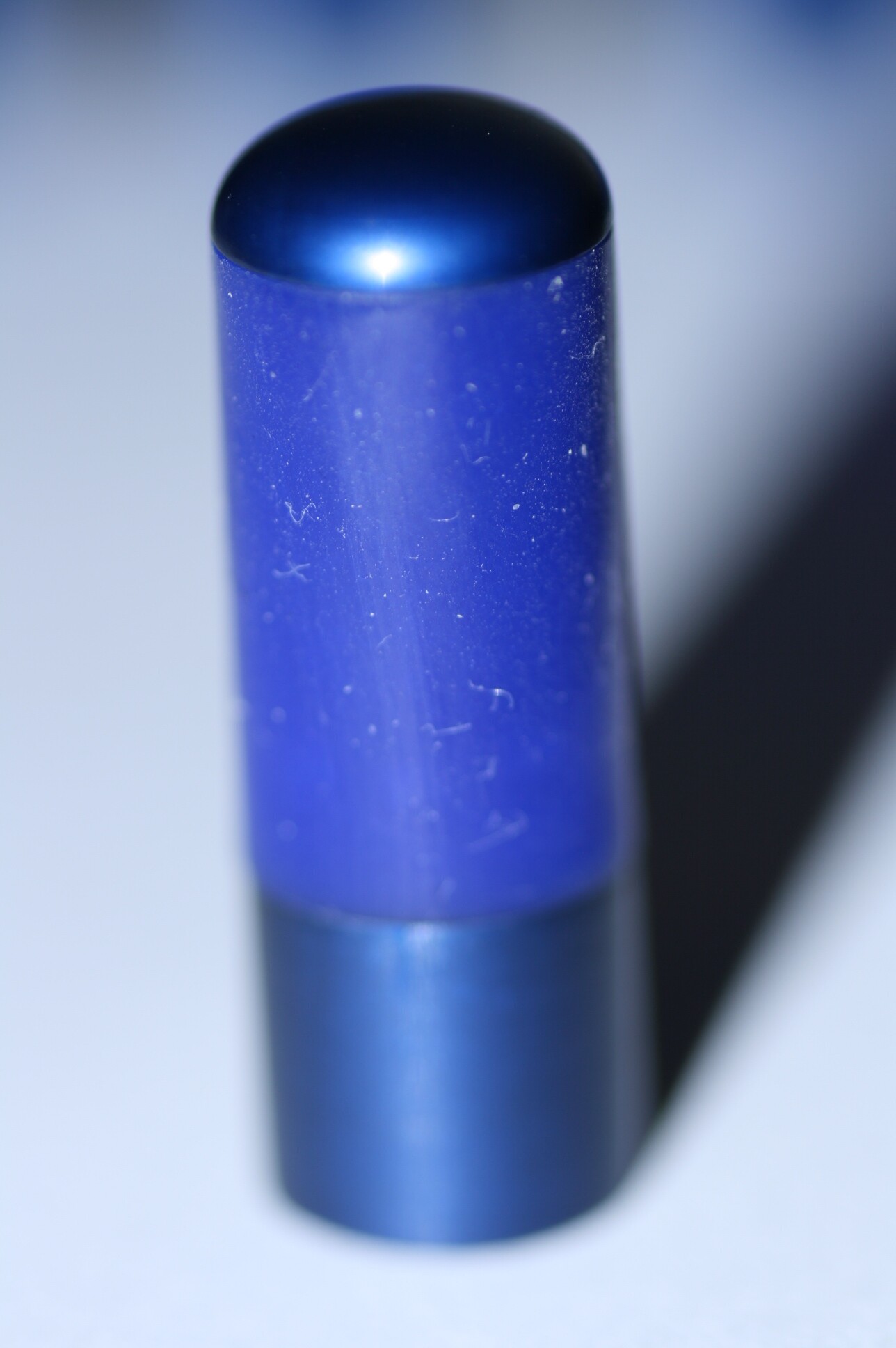

sorted the silicone grips for the knobs only taken me six months  ::)finally worked out car vacuum tubing from the local super cheap auto store would work
very nice feel very grippy see attached pics will be stripping the unit down completely next so i can powdercoat the chassis blue and white
will post more pics after i have finished and got it up and running.
Those knobs are AWESOME dude, way to DIY!!!
Edit: it was WELL worth the 6 months.

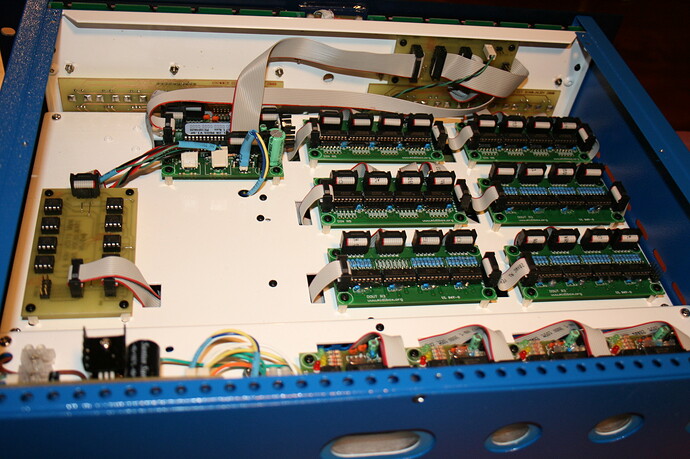

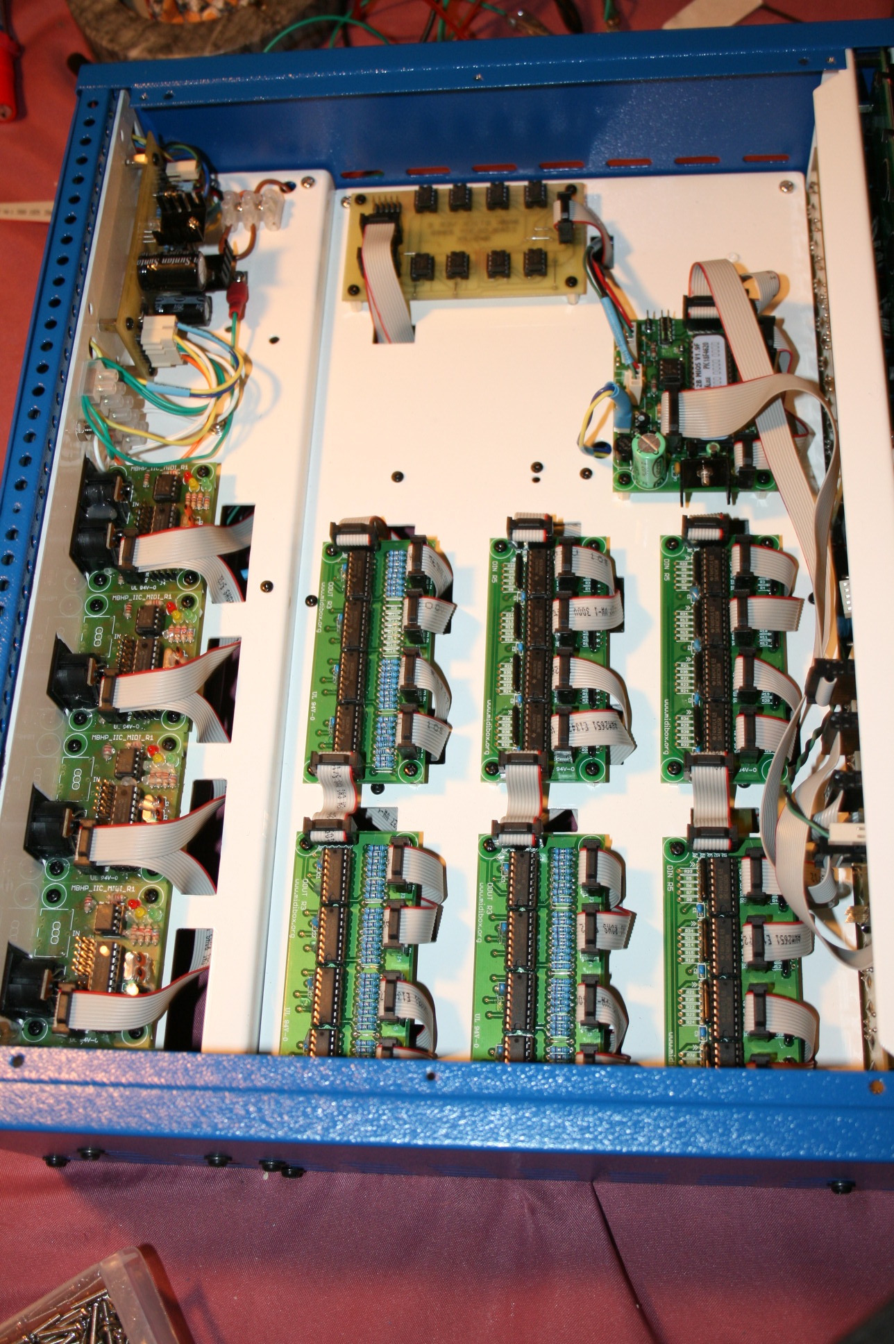

Not a lot of time lately but here is a couple of pics of the inside for those that requested them
and
Wow look how tidy it is! fantastic!
Good work!
Looks like there is heaps of hot glue on the IIC modules - what for?
