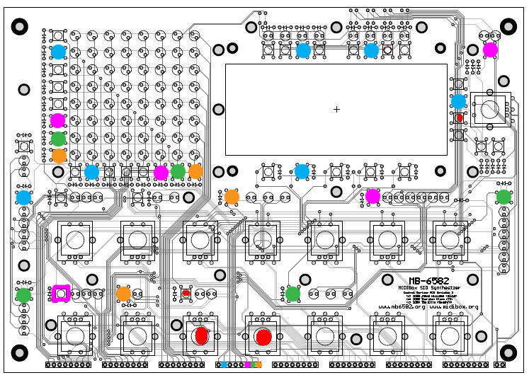

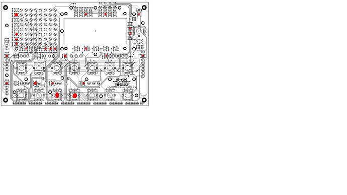

Can someone point out some good tips how to determine the cause why lots of buttons don’t respond on the CS. I attached a file where i marked the buttons that don’t work.

There is a wiring diagram in the wiki pages, scroll down to “Control Surface Wiring” and note the errors in my diagram (was too lazy to fix this at the time, sorry).
Measuring voltages is probably hard to do because the switches are in a 8x8 matrix, so the voltage at the 75HC165 input is going to be either 5V for unpressed switches or ~1V for pressed switches, but only for 1 ms in every 8ms (guessing at the actual duration, could be 0.5ms every 4ms. It’s 1/8 duty cycle though).
Since I have the PCB layout and can highlight the connected tracks, I can see that some of the the non-working switches have common tracks. So it would be more likely that the cause is due to something wrong with that track (short, break, etc). I’ve uploaded some annotations to your picture, showing which switches are connected… the “input” side of the switch, with the input going into the 74HC165. It can’t be coincidence that ALL switches on those common tracks don’t work… so it’s either something wrong with the cable or the IC pads or something at JD5…
It doesn’t explain some of the faulty switches, they must be a separate issue.

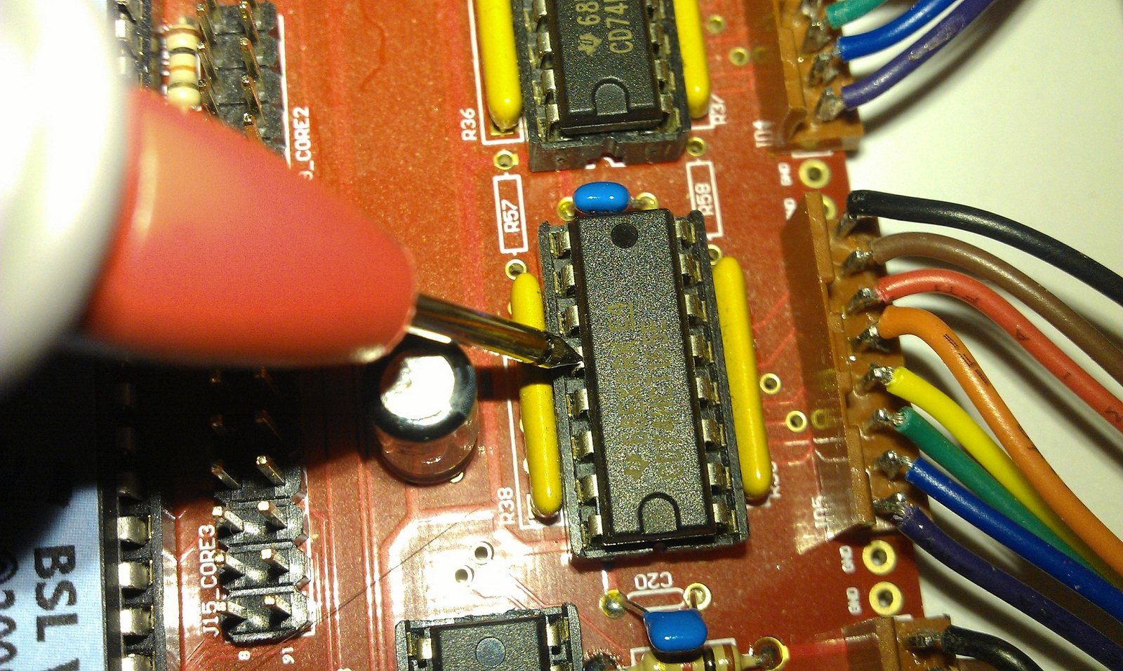

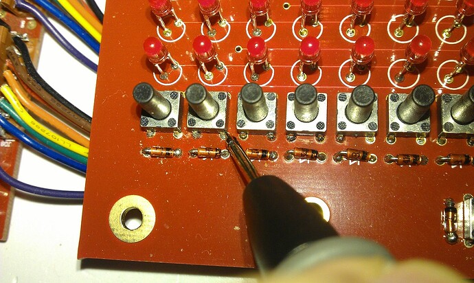

@wiba: Attached 2 pictures how i measured. I followed the buttons wiba marked blue.
I only measured for connection (beep, or no beep) for now. Measured as close as possible on the button on one side and on the other side on the connection of the input of the 165 on JD5. This is in the not pressed state i hear beep. Then i pressed in the switch and measured the other pins of the switch and also beep is heard. :shocked: This is repeated for all the buttons you marked blue. All beep the same.
@smashtv: I allready swapped the 165’s and nothing changes. you mentioned the r57 r58 these are only needed when you have 5 pin resistor network right? I use 6 pins resistor network. How can i best measure the resistor network? Cause it should be 10k but probally due to bad measuring i sometimes measure 20k.
