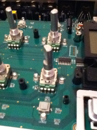

Lately my Kore 1 Controller’s encoders started behaving oddly, and I am thinking about replacing them myself since NI’s technical support does not reply my queries, maybe because the whole Kore think is being discontinued anyway.
Does anybody know what brand / type of encoders are used in Kore controllers? I opened mine and each encoder has 4 pins. I wonder if it is a special type of encoder since they are all touch sensitive (never liked this feature though)
I can post some pictures later.

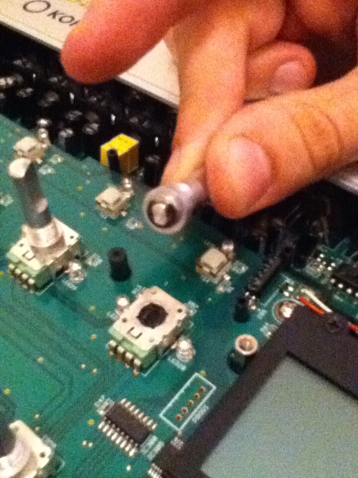

I found out one of the encoder shafts actually broke loose. I pressed it back into its base and it worked normally. Didn’t stop the original problem though, which is epileptic encoder behavior.
I glued the broken shaft back on, works like new!

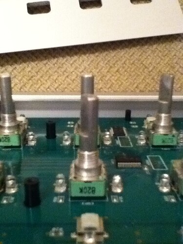

It actually looks like under the shafts there are analog trimmer-like potentiometers (also the text reading “B80K” on the encoders gives a hint). Maybe the firmware of the controller measures increase/decrease in resistance and ignores jumps from zero to full (and vice versa)?
they are very similar to ones used in x0xb0xes (VR4, VR6), made by Taiwan Alpha Electronics.
