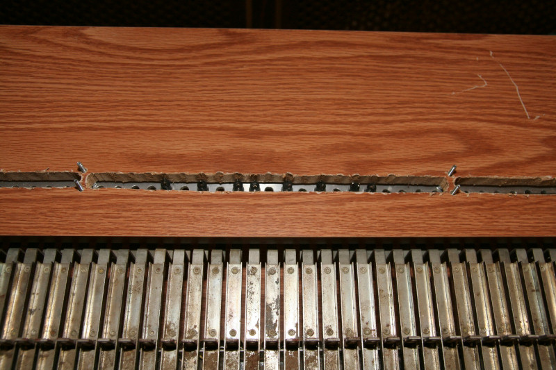

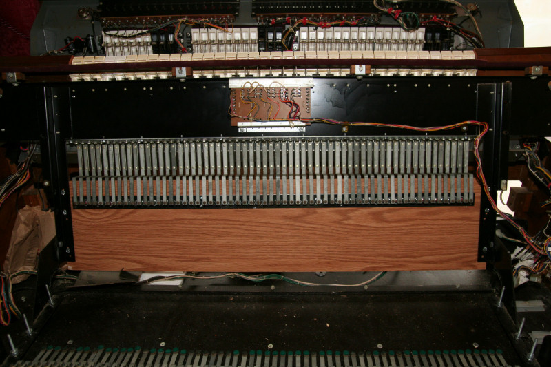

The second picture is of the old contact boards and old keyboard electronics.

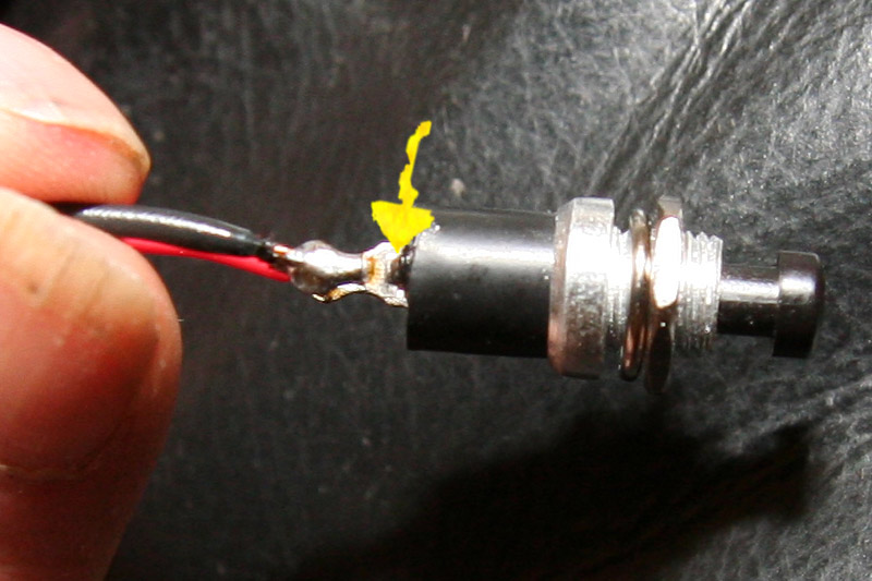

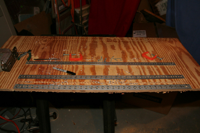

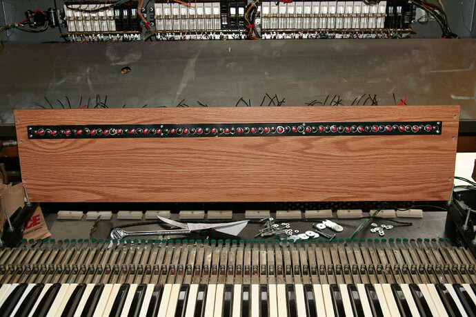

The third and forth pictures show how I made the new push button boards.
These new boards only have one octive of switches installed right now.
Plus I will need to solder wires onto the switches and add terminals.
So they aren’t complete yet.
The midi dins and cores will mount to these boards too.
I had to test it out to make sure it worked before buying 122 switches.
The board is full adjustable for height by washers.
The boards don’t destroy any of the orgional integrety of the organ.
No new holes were drilled into the origional organ.
I just used the old mounting holes from old contact boards.
The push buttons have a bit more firmness than if I used smaller micro switches or touch switches,
but so little from the origional feel of the organ keys(the old contact board also had springs so it had a bit of firmness too),
that it was worth the higher quality of push buttons.
Plus with micro or touch switches I would have to be more exact on the height, etc.,
since they would have a minute distance to activate the switches.
They eventually would get out of aligment, etc., and require constant fixing.

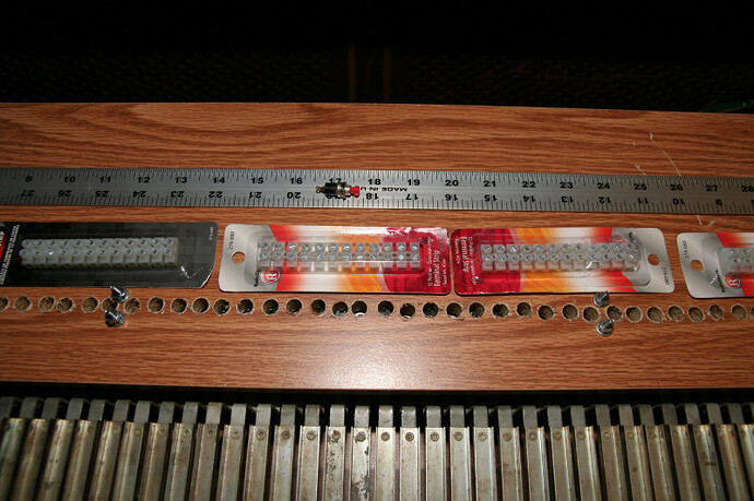

As you can see these boards look like shelfs!
Well they are!
I initially used 1/4 inch hard baord and manually cut them.
But I needed to go up to 5/8 inch since 1/4 inch was too flexible.
I am using hand tools so my accuracy isn’t exact.
So I found these 36 inch x 8 inch shelves at Menards, and they were exactly the sizes I wanted!
For $4 each it was worth it, and while I was at it I got woodgraned laminite, plus it saved me some cutting.
You won’t see them from outside of the organ, but it was a free added touch.
The metal strip that the switches mount into is 1 inch aluminum that I had laying around.
Those holes were also hand drilled but they are accurate enough.

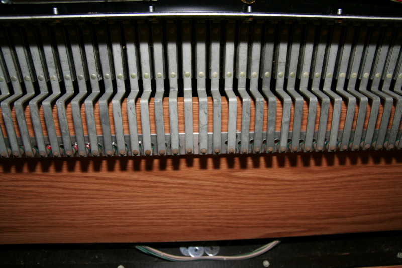

The metal on the back of the keys, where the hammers strike the push button switches,
can be bent to align them perfectly with the buttons(soft metal so need to be careful not to stress it out though).
The height of the boards can be adjusted with washers.
The distance from front to back can be adjusted with moving the outside mounting screws(Baldwin designed this part in,
the holes allow front to back movement of 1/2 inch , so I am just taking advantage of what they already took into account).

Here is what I found out and am trying to come up with solutions:
Since those holes in the 5/8" board are not quite perfect,
and just slightly bigger than the outside of the switches,
when I attach the metal strip with the 8 screws the switch bodies are too tight and the switches may break.
So I need to ream out the holes in the board some more.
My other delema is that the metal strip is a bit too thick to allow the O ring lock washers that came with the push buttons
to mount and lock the switches to the metal strips.
Since these switches will see a lot of hammering and vibrations they could come loose.

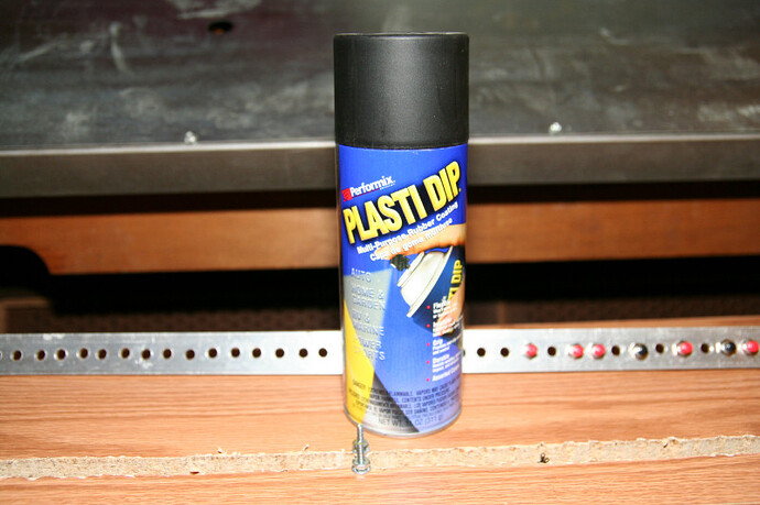

So I am considering Loctite Blue 242(locks nuts but can be removed later, it’s semi permanent).
Then as an extra I may use some liquid rubber around where the switches mount to the metal strip to not only dampen the metalic sound but to keep them from further movement in and out.
Rubber and loctite blue 242 will allow disassembly later(rubber can be cut, or broke, the loctite blue loosens with applied heat if needed).

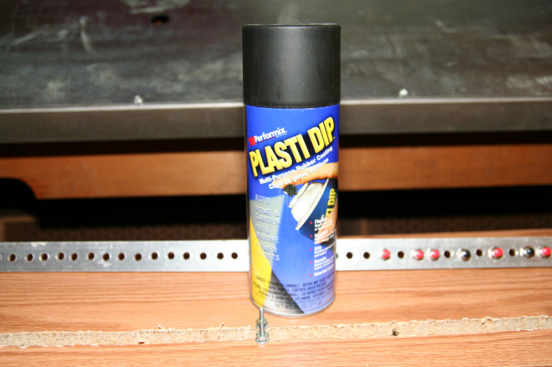

The last concern is that when the key hammers strike the switches you hear a metalic sound resonating from either the metal strip or vibrations from it to the board.
So I need to quiet that.
Possibly by using either liquid rubber as gaskets or black silicone between the metal strip and board and possibly around the switch bodies(painted around inside of holes in board to dampen and vibration from switch body to board).
OK.
I think I came up with a couple of solutions.
I will ream out the holes in the wood boards slighty so there isn’t any tension when trying to insert the switch strip.
Optionally I will coat the inside of those holes with a rubber coating to dampen any noise from vibrations of switches to board.

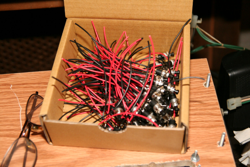

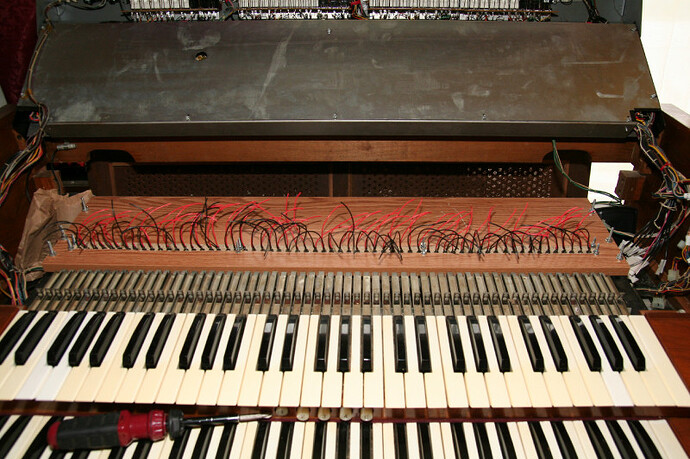

The way I am assembling the switches will be:
First each switch needs wires - so I will be soldering black and red 18-22 gauge 2-3 inch wires onto the switches before inserting.
(These wires will come up through the holes and attach to screw terminals).
I will ream out the holes in the metal strip slightly and coat the metal strip with rubber including the inside of the holes.

I just purchased the rest of my switches, and while I was at Radio Shack,
I found some ready made terminal strips at Radio Shack that will work and save me time.
The guy at radio shack also suggested that I buy a couple of metal yard sticks, which are aluminum and thinner than my metal strips.
They will work better and allow lock washers!
I just have to drill 122 more holes that’s all.
Coat the yard sticks with rubber and I am good.
Instead of reaming out the holes in the board I am considering just routing out a channel.
It’s late at night.
Usually when I work on projects,
the day time is mostly spent running all over the place to get the materials.
I always make sure I have everthing I need before I start a project.
I hate running out of something in the middle of a project.
Unfortunetely when using power tools at night I can disturb the neighbours.
So all I can do now is plan for tomarrow.
But here’s a picture of what I plan on doing.
Yes, my holes are off slightly.
This is because I started out with drilling the metal holes and the drill bits slid a bit.
Then I used the metal strips as templates to drill the holes in the wood so at least they aligned with the switches.
I hope to fix this now with routing out the holes in the wood for a nice channel and centerpunching the metal yard sticks for exact alignment.
You can see the metal yard stick.
These were $3 ea, $6 total for 2.
The terminal strips are for the hot side of the switches.
They come in strips of 12, so I’ll need 6 per keyboard((3 x 12 +8(4 cut off)) = 32) x 2 = 64 with 3 left over, at $3 ea for a total of $18 per keyboard.
If I tried to make my own terminal strips with screws nuts, etc. I am sure they would cost more and be a lot more work.
These terminals will be towards the rear where the dins will mount, in front I will need grounding strips.
I haven’t figured out what to use for that yet.

Another picture for you guys.
I cut out the channels so if the switches are off they will fit fine.
I used a jig saw instead of a router.
It was easy and fast(just connect the dots so to speak).

Here’s a picture of what I just finished:
Drilling the holes into the metal yard sticks!
You can see my makeshift workbench I am using.
Now you know why I am slightly off.
I used the old metal strip as a template to make it easier.
I did both yard sticks at once.
Yes I could have made it more precise in this drilling,
but it was just easier to use the old metal holes instead of worring about bit slipage(I may have done worse).
These holes are close enough and it saved me time.

Anyway in case you guys are wondering what I was refering to for a rubber coating.
It’s called Plasti Dip and is used for coating tools and other things.
It comes in a spray can or as a dip.
It comes in 4 colors(red, black, yellow, and blue).
I got black.
Here’s a picture of it.

Now onto soldering wires to them.
Well it took me about 5-6 hours to do it right.
But I have finished soldering the wires onto half of the switches.
62 actually.
The rest will be done tonight.
I decided on 4 inch lengths of wire, since that should be more than long enough.
After the swithces are installed, I will measure distance to terminals and cut and strip those ends.
Here’s a picture of my progress:

Note: While I was doing my QC testing of these switches,
I was able to fix a few that were not completely assembled right.
There are little lock tabs on the terminals on the back of the switches that need to be locked.
If you have a switch like this(I don’t know the real manufacturer, but they were bought at Radio Shack, made in China).
With no continuity when button is pushed, it maybe due to a loose terminal on back of switch.
Just pull the loose terminal out until it locks.
Here’s a picture of one of the switches with an arrow pointing to the lock tab of the terminal.
OK.
I just installed all of the switches for the top keyboard.
This is the first time I was able to feel what the WHOLE keyboard feels like with these switches
The feel is great!
Nice and solid(better than cheap portable keyboards), and just right(not too firm nor too soft).
That rubber coating dampened all noise and also will help keep the switches and screws from coming loose from vibrations, etc.
Right now the switches make full contact when the keys are within 1/8 inch of all of the way pushed down.
But I can always adjust the height for ore exact contact height a little with washers.
Like I origionally planne:
I took into account to the ability for minor adjustments if needed.
Plus, if a repair tech needs to do any repair it’s easy.
Each switch can easily be removed and replaced.
Switches do go bad, so this should be easy.
Now it’s installing terminal strips and attaching the wires from the switches to them.
Here’s a few pictures for you:
