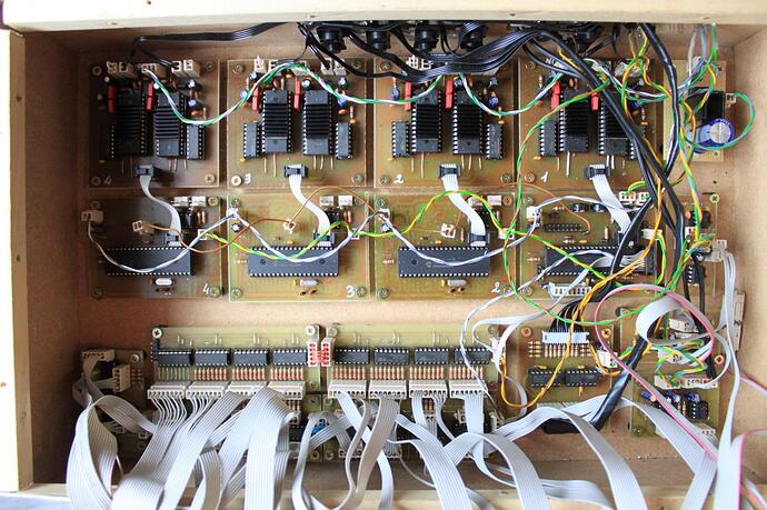

I’ve build my midibox SID in an all diy way, in order to learn and understand everything in the box, and make some modifications to the original project.
here is some pictures:

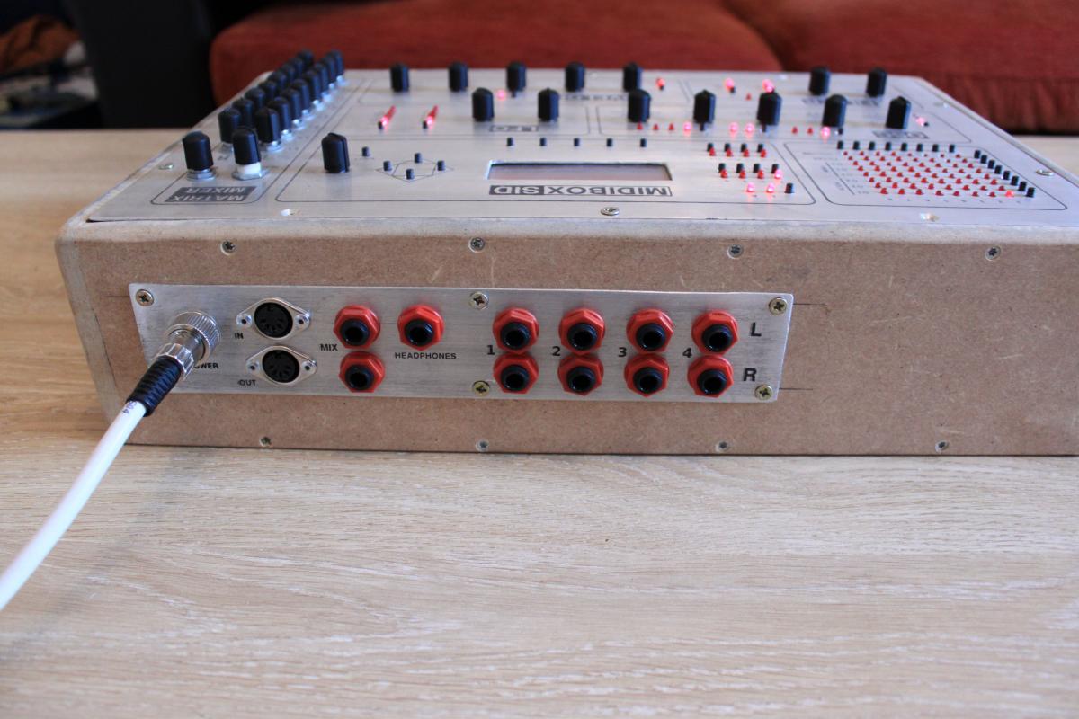

I have modified the original layout of the mbhp_core_v3 and mbhp_sid_v3 in order to remove the power components (I wanted to build an external power supply), and to make a stereo version of the mbhp_sid.
I integrate a matrix mixer and an headphone amplifier, I also add a buffer to the separate output.
The design of the mixer is based on the Ken Stone’s matrix mixer CGS33 http://www.cgs.synth.net/
The amplifier is from sonelec-musique.com http://www.sonelec-musique.com/electronique_realisations_ampli_casque_005.html

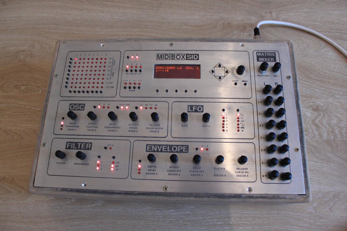

For the front panel I have used the aluminium etching process with ferric chloride for nameplate engraving.
The box is made from medium density fibreboard.
For the pic programming, I used my old pic programmer that I build 17 years ago. I had to modify the firmware of the MB6582 in order to get the control surface working without the multiplexed DIN & DOUT.
If you want, I can share my PCB layout of the stereo sid and core.

Excellent! How have you mounted the front panel components? MBOTW candidate :wink:
Thank you!
The front panel components are mounted on breadboards, witch are screwed on spacer, and fixed on the panel with epoxy glue…

Hint: if you set the DEFAULT_LCD_LINES parameter to 4 in your setup_*.asm file, and rebuild the application, the 4x20 display will show more informations.
Best Regards, Thorsten.
I have already set this parameter and the display works fine with the 4 lines on the other menus, the first page normaly display more informations?
