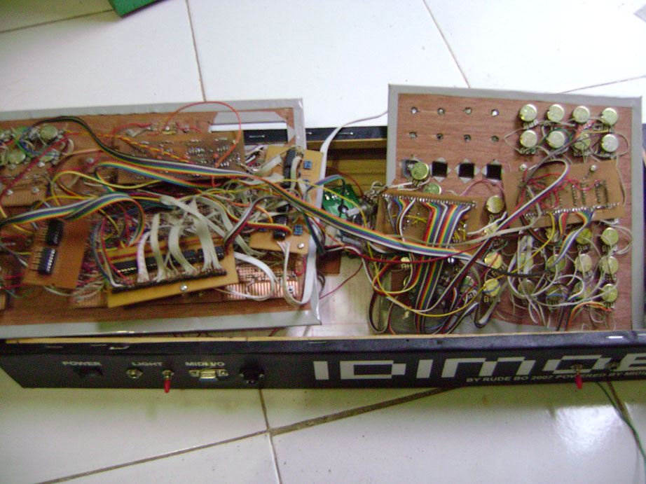

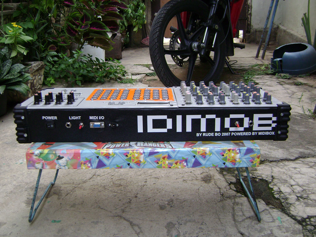

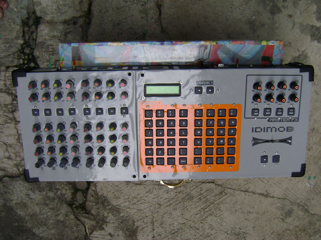

This is some pictures of my 1st midibox based on midibox64.. I made this for ableton live controller.. & i named it IDIMOB v1. After several month reading some post on this forum, Finaly I did it… ;D

Its my cousin’s table.. i borrow it for taking pictures.. ;D

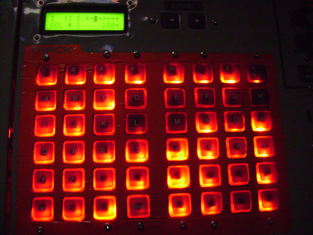

i am VERY interested to know more about your keyboard like buttons, especially the light into.

I made the button from flexible keyboard. see here http://the-gadgeteer.com/assets/brando-flexible-keyboard8.jpg
I cut it per button and glued to front panel…

Looking good! I like what youve done with that keyboard. I wanted to do the same but I really didnt like it to be blue so that is why I gave up. Your buttons looks gray and lit red… are they gray? I guess button contacts are for graphite type buttons… did you made new PCBs for button and how did you protect contact surface from corroding?

i was wondering … what have you used for the graphics of the front panel? looks like some kind of vinyl, ??

Yes the button are grey. i mount the button to stripboard.

Its a custom cutting sticker. i ordered it from local car’s cutting sticker.
