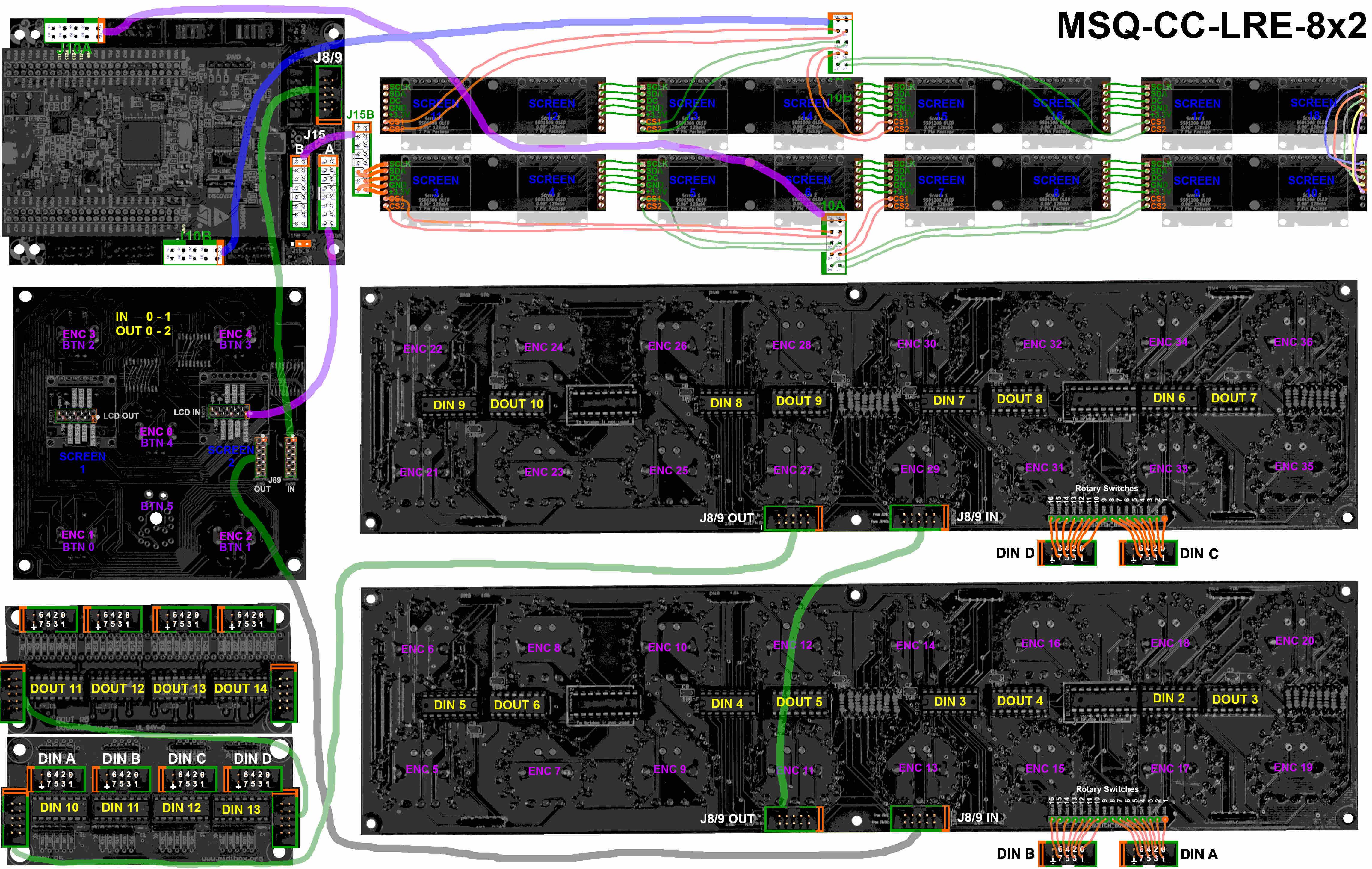

more info @ wiki: http://wiki.midibox.org/doku.php?id=msq-cc-lre&s[]=msq
MSQ_CC_LRE stands for
Motion Sequencer for Midi-Control-Change  with the LRE8x2 Ledring-Userinterface
there are more varations of this tool, one is with a generic BCR2000… there is a wiki for all necessery stuff: http://wiki.midibox.org/doku.php?id=msq-cc-bcr&s[]=msq
this Variant is hardcodet for the Nordrum2 , but since the CC-Maping is arranged in an Maping-Routing-Array, it can be changed via SourceCode - which is easy done when you know a bit C-Programming.
there will be also a simple MSQ_REC - which is reduced to 4Channels, which only Records and Playbacks CC of 4 MidiChannels x 128CC - a CC-Looper, without the functionality of Storing CCs itself … i will build it for the clavia Nord Rack III - since it has ledrings and encoders - its the berfect synth for that. 8Pushbuttons, 4Ledbars, 4 encoders and done.
so this is what have done, and what will be done :wink:

This automate functions you write are pretty cool, I don’t imagine what you will be able to do on a OLRE16 ! I like that, I keep it somewhere in my mind…
if i had, i would, i could … program something for it  - the code is pretty much done, on one place there is this “MIOS no FPU” float point math problem till now  (Velocity Offset Controller “0effekt - full effekt -scale”)
the 4row x 8 Format, i like, because in Overview-Map Mode/mixer-mode, i have 8Channels a 4 Controlls, which is pretty standart for many cases. when using 16x2 for example having only 2 Controls on 16 Channels - 8 are enough… 16channels are a bit to much… when thinking of the arrays in the background… a motionsequencer array for example [16][32][256] or [8][32][256]  - (channel, cc, steps) makes some difference in ram. - i had longer sequences with 512 steps - but ram say no… - so for me a olre8 make more sense.
multicolor with much more segments led-rings, i would show the actual Velocity/MSQ Effect on CC in different color in realtime,
also would give the different maping-modes different Ledringcolors (deep-edit/overview-mode), would also add oled display to describe the function of encoder - because when affort a  olre16 it makes sense to take a bit more money in hand to give them displays…
but i have some finance crisis, because driving south with my girlfriend - eating my last money , dont think i can effort a olre16
currently working on V2 (now with Displays), wiki and programming currently on development… http://wiki.midibox.org/doku.php?id=msq-cc-lre-v2
much to programm… but it combines the last modules i designed - to get it into Eurorack…
