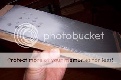

Started with a sheet of 1/4" Plexiglas with 3/8" holes drilled in it, and hot-melt-glued it to a sheet of MDF (medium density fiberboard):
Before they were glued together, I held them together, sprayed some puffs of paint on the top to mark the circle locations on the MDF, and tapped some small finish nails through the centers of all the circles. The heads were chopped off by a Dremel tool, so they wouldn’t get stuck in the caps, and the nails were all sunk into the MDF so they sat up about an eighth of an inch. Then the plexi was re-centered and glued onto the MDF:
I sprayed it with some WD-40 (only thing I had on hand) and filled it with a mix of fiberglass resin, hardener, and a couple drops of white enamel paint (didn’t know if they’d be painted later). When dry, I hit it with a belt sander to remove the excess:
