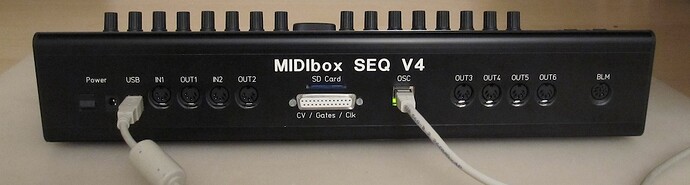

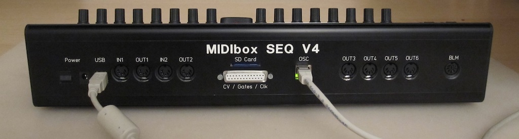

It is possible to separate the BLM from MBSEQ with a plug, I’m doing this as well! :slight_smile:
See the socket at the right side of the rear panel:
Here the schematic for the 8-pin connector:
http://www.ucapps.de/midibox_blm/blm_connector_mbseq.pdf
The BLM can be connected/disconnected during runtime and will be automatically detected, no need to reboot the sequencer.
