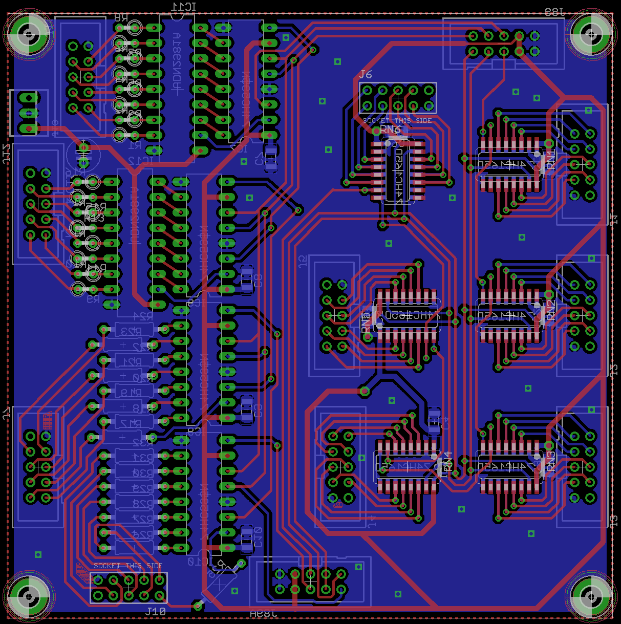

Mixed DIN/DOUT board -- clock and latch chaining?
I’m working on a sort of hybrid DINX6/DOUTX4 board and I have a question on how to treat SC and RC. The BLM is proof that chaining the clock works even when the DIN/DOUT parts are not equal in length. But on DIN/OUTX4 boards sold by SmashTV normally one splits the J8/9 ribbon with an intermediate header. On this board I have the choice to go serial or parallel, so I wonder what the best way is, or if it really matters.

It does matter! It’s important that DINs and DOUTs are chained separately. At the “output port” (J2) the SC line of the longest chain (in your case: DINX6) should be available, RCs are separate anyhow.
Best Regards, Thorsten.
Good to know, thanks again. But RCs on J8/9 are common, perhaps you’re thinking of J19?
Interesting to note that the SEQ PCB doesn’t follow this practice. SC and RC are directly connected from header to header.
Hm, that (and the lack of sleep ;-)) explains my confusion a few weeks back :-). RCs on J8/J9 do come from different 74HCT541 pins, but…
while “beeping through” connections from the core to the SEQ CS, only 6 connections (single RC line) were needed to wire up the SEQ CS, but 7 connections (two RC lines, that are common on the SEQ CS board, but I did not know that then) to wire up the TPD :-).
Does it have something to do with the maximum possible serial chain length? Wilba (SEQ CS PCB) connected the RCs, Ilmenator (TPD PCB) kept them separate… Does it make no difference or was it just a violation of well-established norms and standards? :slight_smile:
Many greets,
Peter
Interesting! I was referring to the SmashTV DIN/DOUT boards and the Core8 module, which I remixed for the BLM. It may be a good time to consider _NG modules for the 32-bit Cores.
No problem :-). Probably within software, the output pins 13/Y5 (RC1 on J8/9 the STM32F4 board) and 14/Y4 (RC2 on J8/J9 ofthe STM32F4 board) of the '541 are switched in unison/at the same time, but I also have the strong feeling, one should not connect the RCs in the serial chain :-).
Many greets,
Peter
In the past J8/9 RC1/RC2 was a common line at the core (MBHP_CORE_PIC, MBHP_CORE_STM32), but always routed as separate lines at DIN/DOUT PCBs.
With MBHP_CORE_LPC17 and MBHP_CORE_STM32F4 I introduced separate RC1/RC2 lines at J8/9 core side for future enhancements.
This feature isn’t used by MIOS32 yet (it just sets both pins at once), but it could be used in future for whatever reason.
Okay, actually the r5 boards I’ve got both share RC (bottom pins on the 2*5 connector) but it makes sense to change the convention.
Here we go:
This was my best solution to routing up the DINs. Looks like it will be possible to make a “mini-DINX4” at around 50*50mm in the future.

Is that a work in progress? because i’m not sure about your ground plane (bottom?)

Could you be a bit more specific about what you don’t like about it? It should be possible to mirror the 5V trace to allow a  a solid connection back to the supply, but it’s always a toss-up between as few vias/layer changes as possible.
I think I just understand…74HC165 and pull-up resistor in smd package (which I completely miss)  are superimposed.
It looks better then

Well, it’s still not too clear what you were proposing about the ground plane, but I changed it anyway .
Hi
yes I was not clear because I don’t clearly get the layer :slight_smile: My first thinking was top layer=ground plane
Some observation:
-At hc595 power distribution, maybe it’s better to connect first to caps, then to pin 16
-The remaining 5V trace at bottom layer between the two 165 can bee traced easy at top layer, like you do for other with half din trace at bottom layer
-You can simplify rc/sc/so chain at 595. All trace have angle at some point, most of them can be axed X at bottom and Y at top. Also you have some room to move digital trace more left by one or two steps, this will reduce the bottom trace at ground plane
-RC line at lower 595 to J8/9 can maybe use the same “pattern” as other ones with X bottom trace, an then top trace (via) // all other digital line. This will reduce a lot the long trace cutting ground plane

Thanks for your feedback. Some thoughts in reply:
I see what you mean, but that would involve a layer change of either +5V or the caps. At the moment the IC pin/socket acts as a conduit.
It adds a few vias, but I think you’re right. I was wondering whether a plane break would actually help to decouple the longer signals running to J8/9A
Not a biggie, but I straightened them. But moving the traces to the left means SC starts to intercept the isolation for the caps = plane break.
This would have intercepted the +5V line, but I found another way around.
Again, I appreciate your input.
