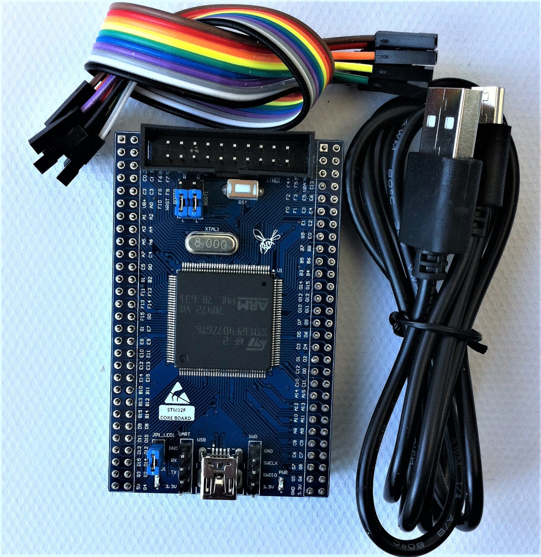

Luckily, I was able to find a few small STM32F407 boards available online, and ordered one.
The only thing is, I’m not sure where to find schematics to build an Audio out jack like the one on the discovery board.  I suppose I’ll post a new thread for that when it arrives (if I don’t find schematics before then).
