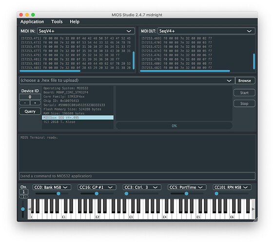

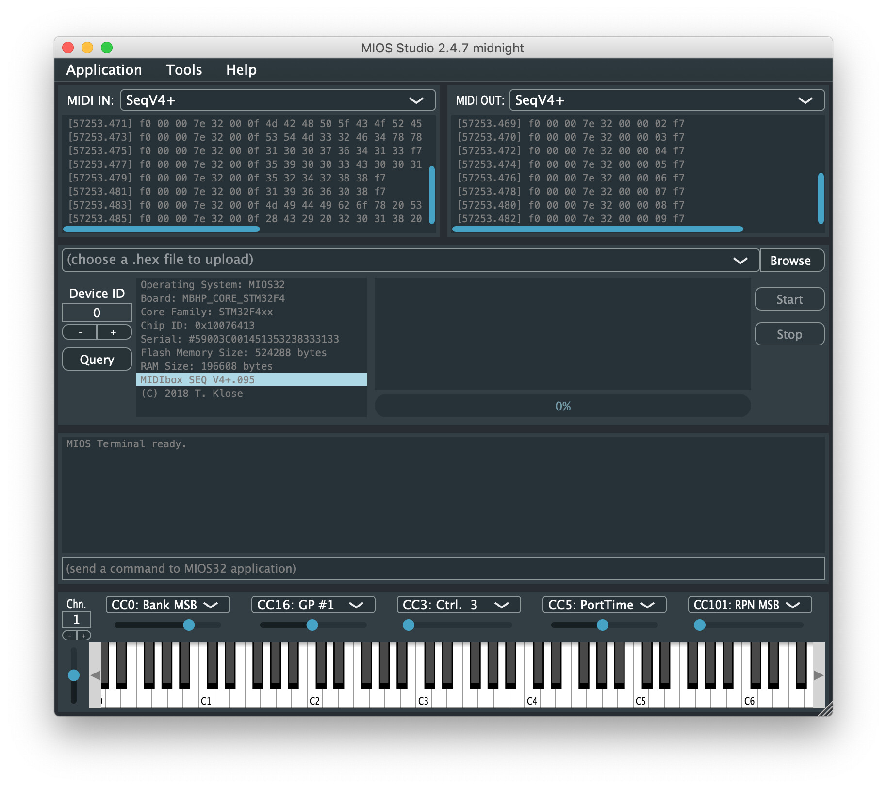

Hi TK,
I tested it under Win7 Ultimate SP1 64bit , it seems to work better, it has the same behavior as the OSX version.
When interface/midibox is connected after app launch The re-scan works, interfaces are seen but no comm, restart app then it’s ok, then same behavior as OS-X now for me.
2.4.7 was crashing or freezing when interface/midibox was disconnected and took a very long time to see the interface/midibox, it’s not the case anymore.
There’s some significant changes for me.
Tested with a MOTU Fastlane , SeqV4+ and internal MIDI SCOPE-PCI(Creamware Pulsar card)
Best regards
Bruno

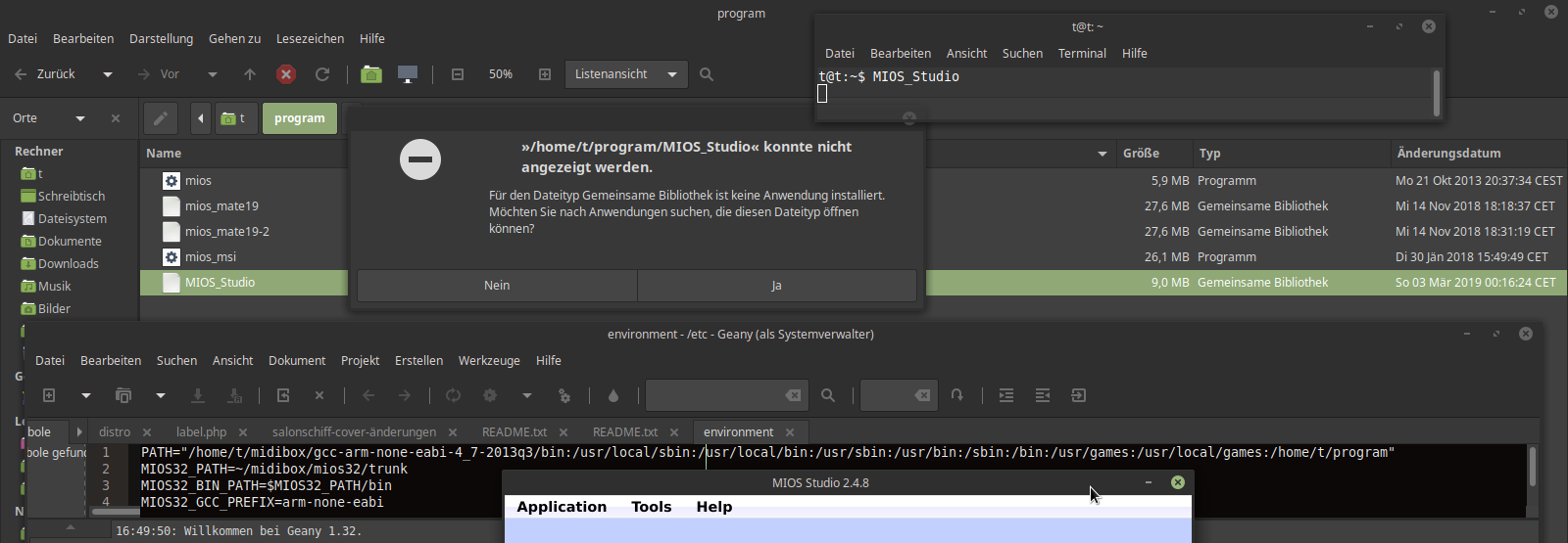

the new 2-4-8 Mios Studio “rar” file you posted, i unpacked it, i checked that it is standart marked as “als program ausführen” in the file-browser settings… but double click or try to run it from console says “keine anwendung zum öffnen von Mios Studio gefunden”
Do i have to install a Application first? which? thx.

well,
problem-solution:
problem:
the providet file “MIOS_Studio” is marked as Type “gemeinsame Bibliothek”,
while “mios_msi” (see screenswhot filebrowser) is marked as Type “Programm”,
“Programm” is executable with double click,
while “Gemeinsame Bibliothek” is not.
— booth “MIOS_Studio” (which i got from ucapps) and “mios_msi” (Built from src on my machine) are marked as “als Programm ausführen” in the Preferencys.
solution:
create a program-folder, (in for example your home folder), and add its path to your environment variables (root/etc/environment) (PATH=“/home/t/program” for example)
put the MIOS_Studio File (from ucapps), into the program-folder
then restart system.
after that its still not possible to start Mios_Studio with double click,
but you can start it with a console by Typing “MIOS_Studio”
