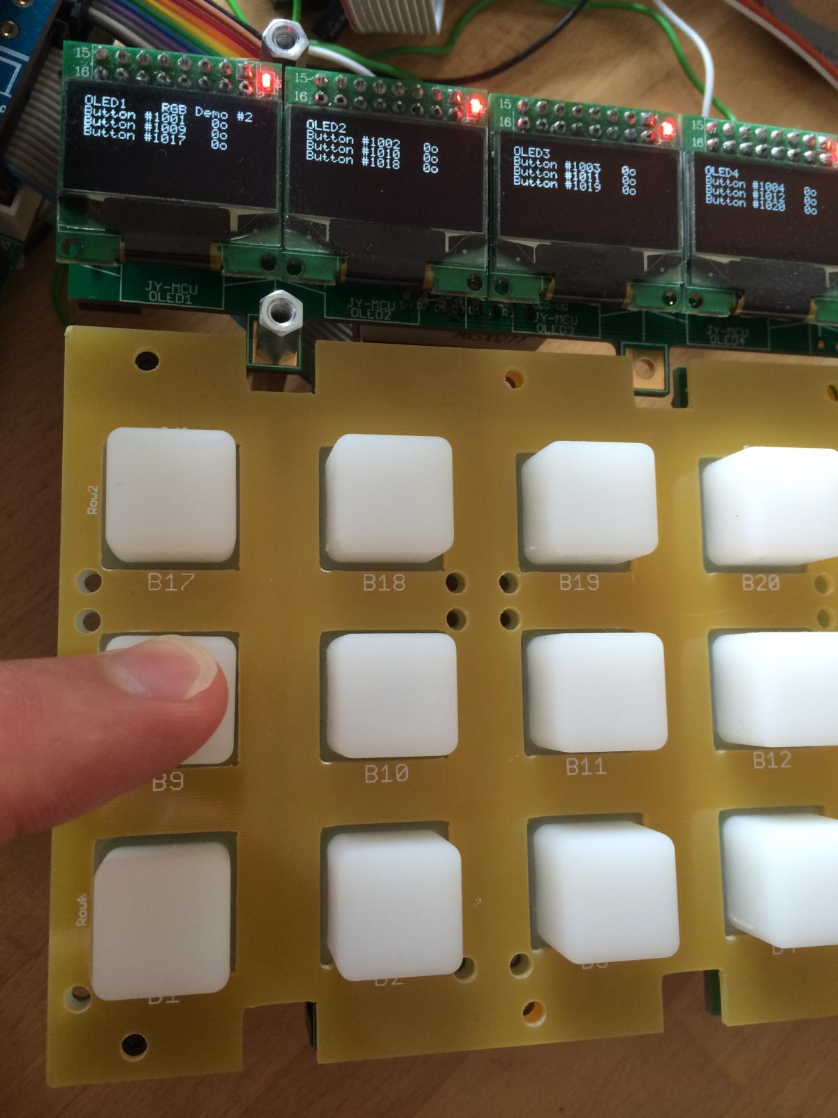

Hi

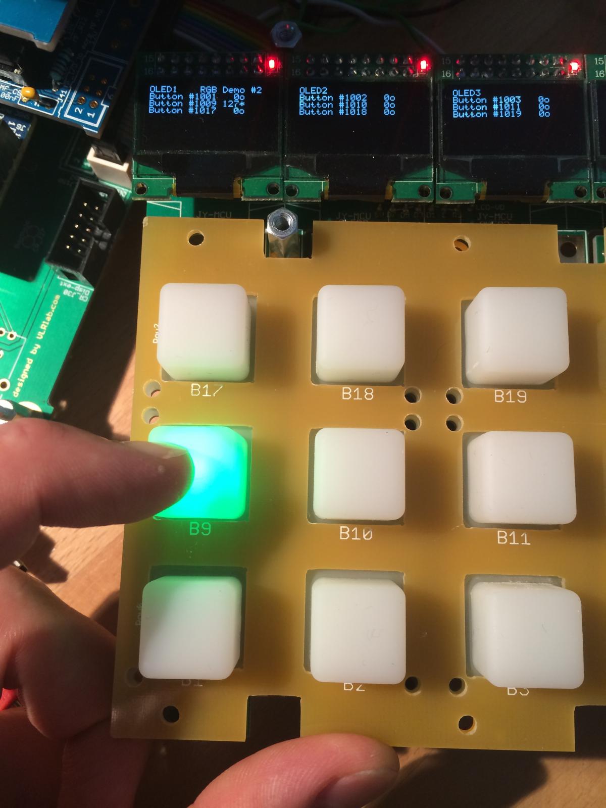

Im Trying to get my Matrix working but have some problems with the commands.

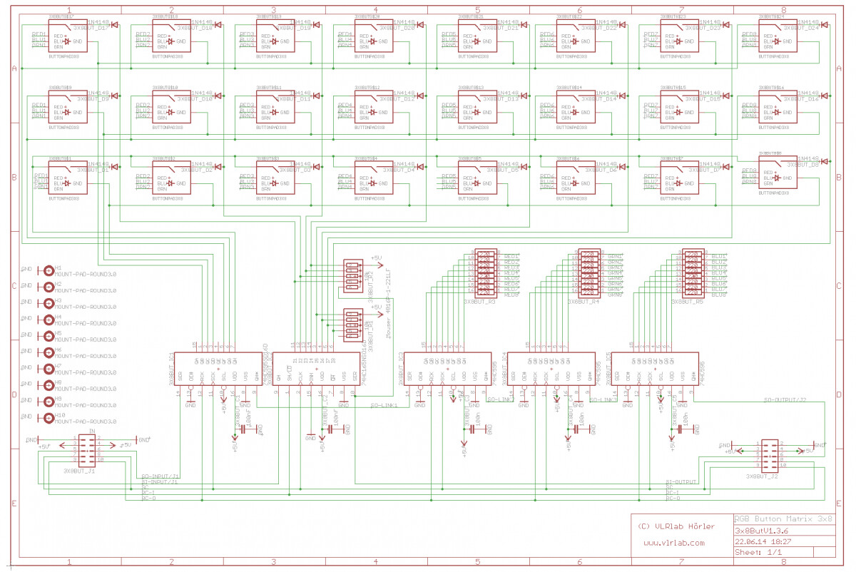

Getting back to this in my Vacation im now testing the self-made board of this Schematic:
Im trying to program it in MIOS but i can’t find out why the second and third button row doesn’t react. And instead the First row shows all three Values by pressing the corresponding button of the first row.
The LEDs don’t light up at all…
Based on the Testfiles i added some helpful code to display the pressed Value but in main its from repository:

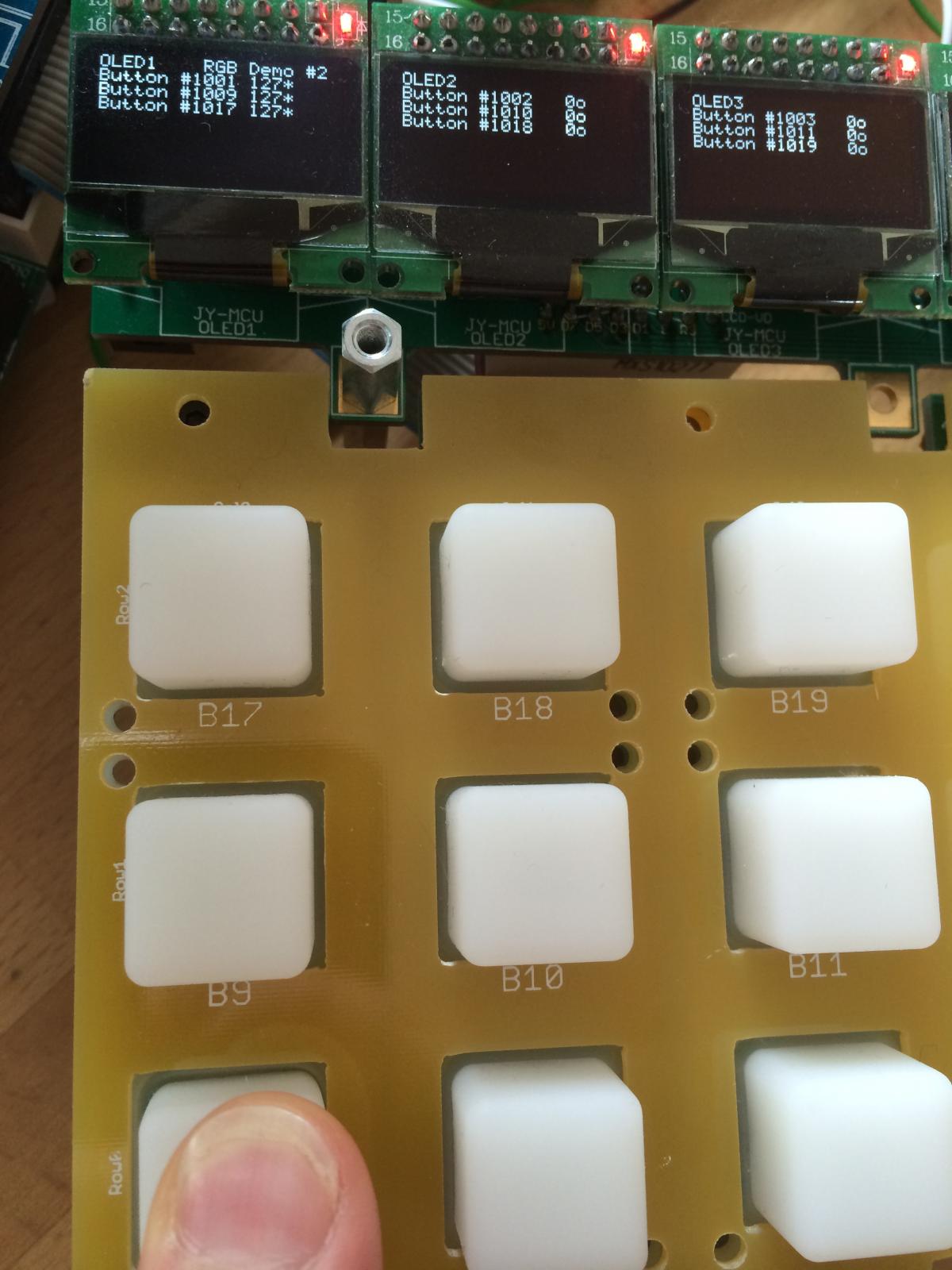

While the Midimoitor shows this while pressing and depressing button 1 row 0:
[13821.564] 90 24 7f Chn# 1 Note On C-1 Vel:127
[13821.567] 90 44 7f Chn# 1 Note On G#3 Vel:127
[13821.578] 90 34 7f Chn# 1 Note On E-2 Vel:127
[13821.760] 90 24 00 Chn# 1 Note Off C-1 (optimized)
[13821.763] 90 44 00 Chn# 1 Note Off G#3 (optimized)
[13821.774] 90 34 00 Chn# 1 Note Off E-2 (optimized)
Can somebody help me with that?

I had a quick look into the schematic.
It looks like you are using 3 rows for the LEDs, and 3 for the buttons, right?
In this case I would use row=4 for both matrices (DIN_MATRIX and DOUT_MATRIX), so that the row selection signals will be duplicated (visible at D0..D3 and D4..D7)
This doesn’t explain why the buttons trigger the events of 3 rows at once, but it might be a good starting point for debugging.
Best Regards, Thorsten.

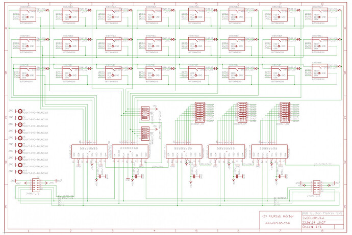

Hi TK.
Yes thats correct i use 3 Rows for LEDs and 3 Rows for Buttons from the same Shift Register.
I just tryed to change the rows=8 to rows=4 but that didn’t change any of the behaviors. I also noticed that the DIN_Matrix line was inverting=1 what i now changed to inverting=0.
Is the schematic done right?
Thank you
best regards, novski

The schematic looks correct.
Maybe an electrical problem?
Are you able to remove the button matrix from the remaining circuit?
Then just connect the row selection signals (IC1 Pin 7, 6, 5) with the column inputs at IC2 with a cable, one after another.
Each connection should trigger an individual MIDI event.
If this doesn’t work, connect an alternative DIN and DOUT module (or a MBHP_DIO_MATRIX if available) and check the same.
This ensures that the matrix configuration is correct, and that you know where to continue debugging…

Hi TK.
Thanks for your reply
I can’t swap anything because of the rubber buttons i made all in surface mount on the Bottomside of the PCB…
To me it looks like the column are short but if i measure B1 to B9 its a open line in both sides. also if i push the button B1 while i measure, B1 and B9 are not short connected…
I changed both SR 1&2 but it stays the same. If i press B1 the Value of B1,9,17 goes to Value 127 and all three LEDs lit up. as they should but if they get V127 but i don’t know from where they get the V127 because im pressing just B1.
no clue.
i need a beer. :mad:

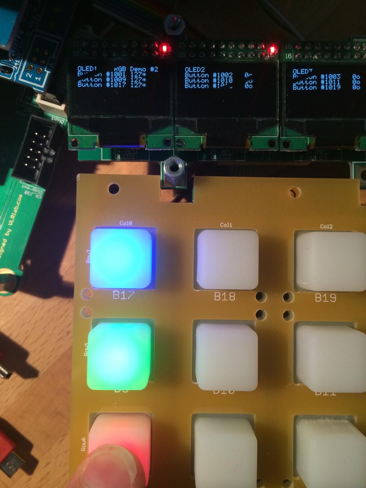

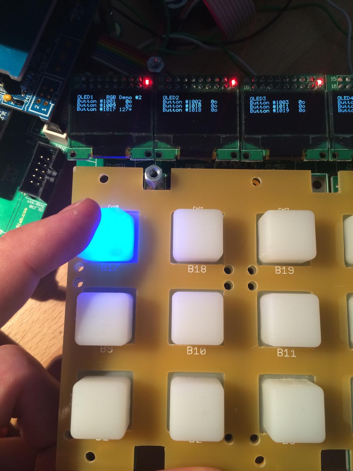

but as soon as i have this:
EVENT_BUTTON id=1024 fwd_id=LED:1048 type=NoteOn key=75 chn=1 rgb=0:0:15 lcd_pos=8:1:4 label="^std_btn"
EVENT_LED hw_id=1
At the bottom of my .NGC it sets every Value in the Collum to 127.
Now it works.
Wow. im so glad i found that…
It took me an entire day!
novski
July 27, 2014, 10:23pm
9
The tiny line on the end of my script was evil to me today…
EVENT_LED hw_id=1
Made that when pressing a single button in the first row then all LEDs in that column went on.
You might think its not possible, but it took me a day to realize that… :sad:

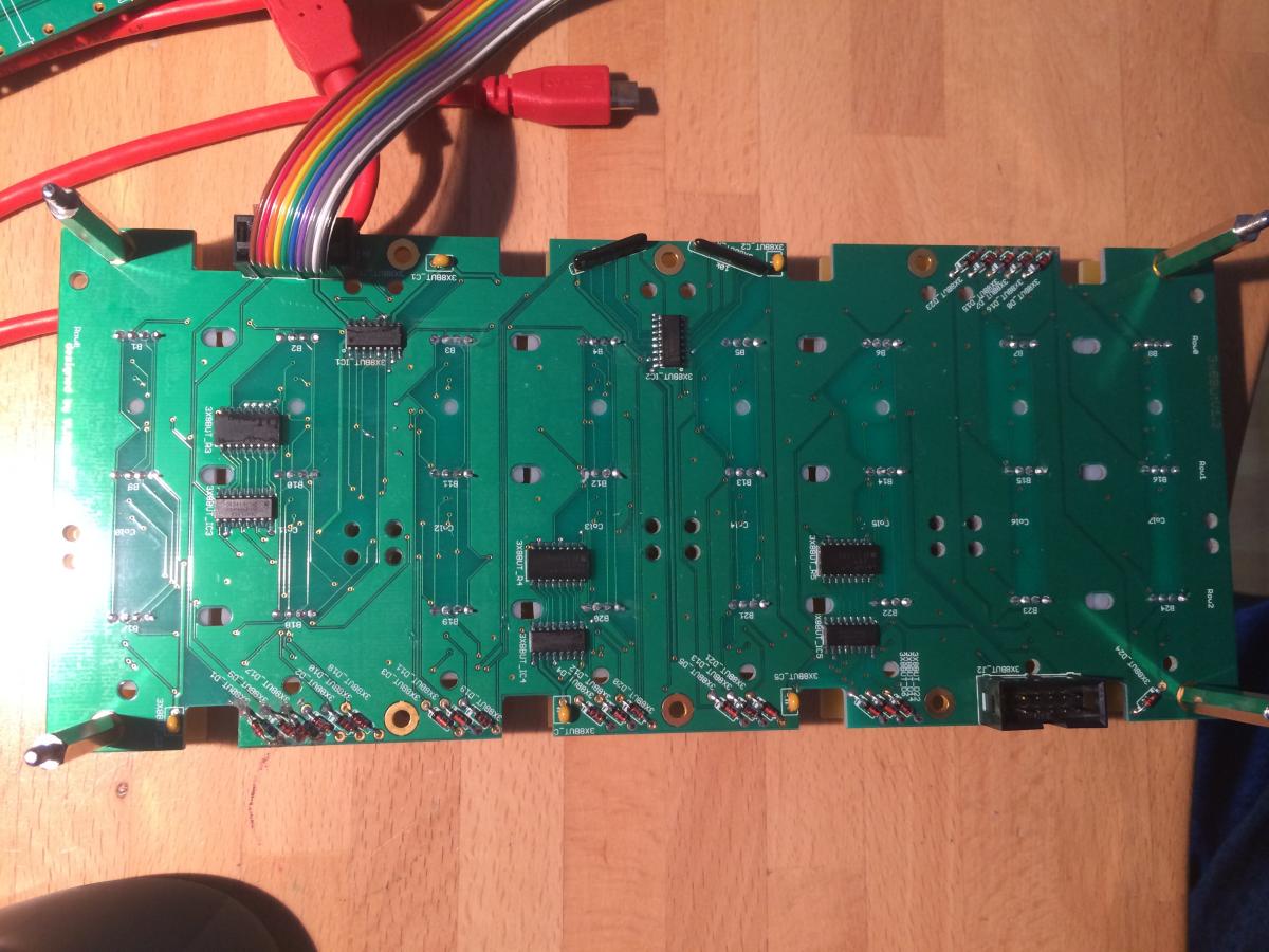

Today i tried a new part of my Fadercore, its a Matrix of 8 rows and 16 LEDs. Purposed to be a LED Level-Meter.
To test, i connected just one Row and 16LEDs and hocked a Encoder to a DIN board. So by turning the Encoder i get a Value from 0 to 127.
Then i wanted to make a simple Test like it wold be LEDs around the Encoder. But somehow again, i don’t understand why my code doesn’t work.

I see the Value rising but the LEDs are always ON. Also if i turn “inverted_sel=1”
What am i doing wrong?
best regards
novski

im using a LPC1769 since my STM32F4Disco turned out to be the smal brother… :pinch: (its on the way to you now…)
I havent changed or Deleted the Files since a long time so the .NGR was never touched and is empty.
-> i just had to notice that there is a warning and it reports that there is no LED.NGR file.
