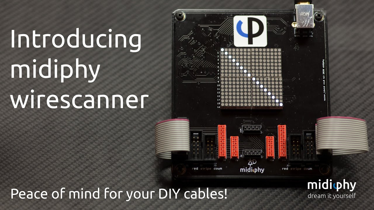

as cables are quite often problematic, Andy has developed a really cool tool, that allows to visualize the integrity of your cables - not only IDC cables, but also micromatch cables, as used in the upcoming MatriX :). Here’s a short introduction video:

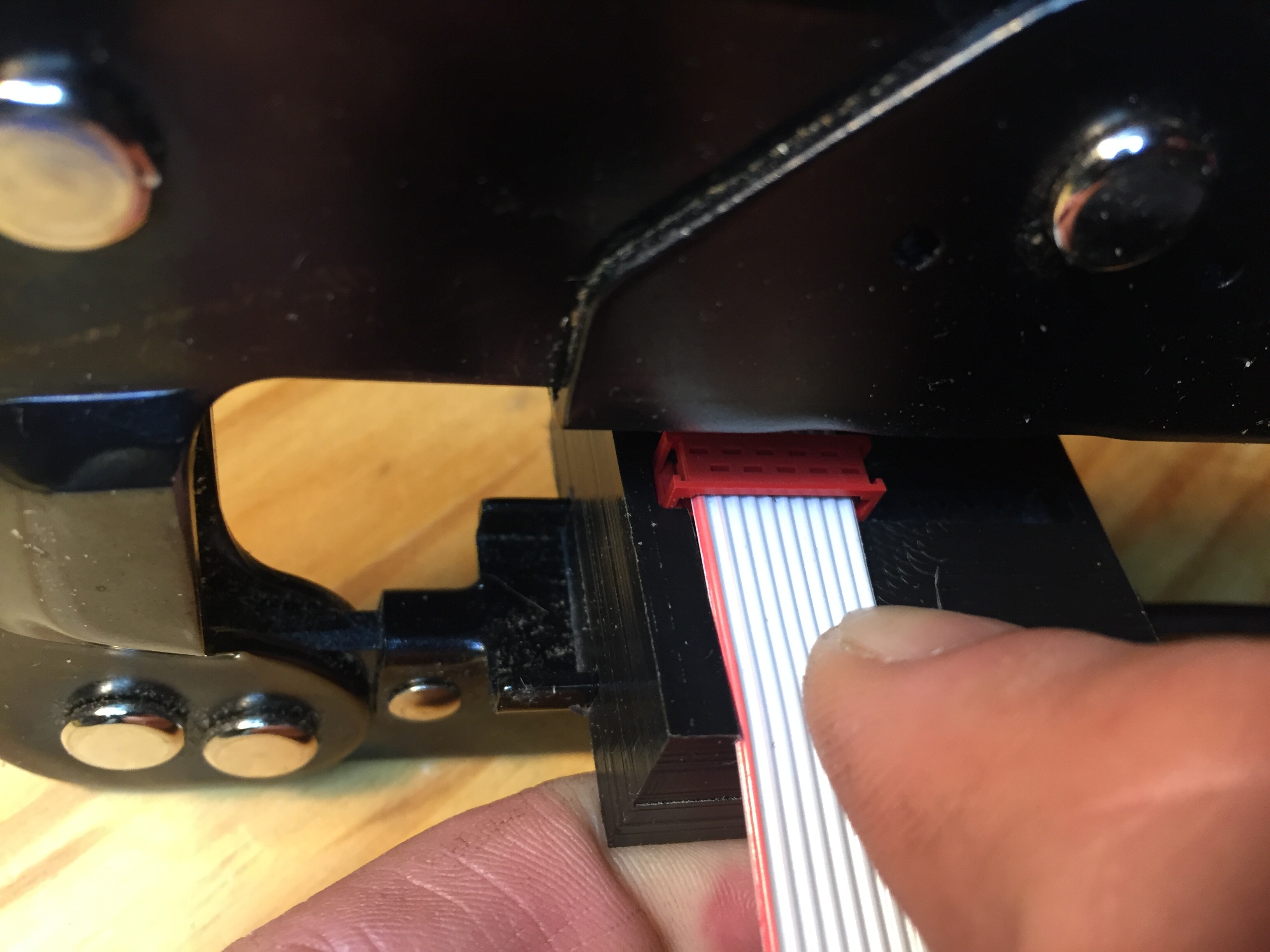

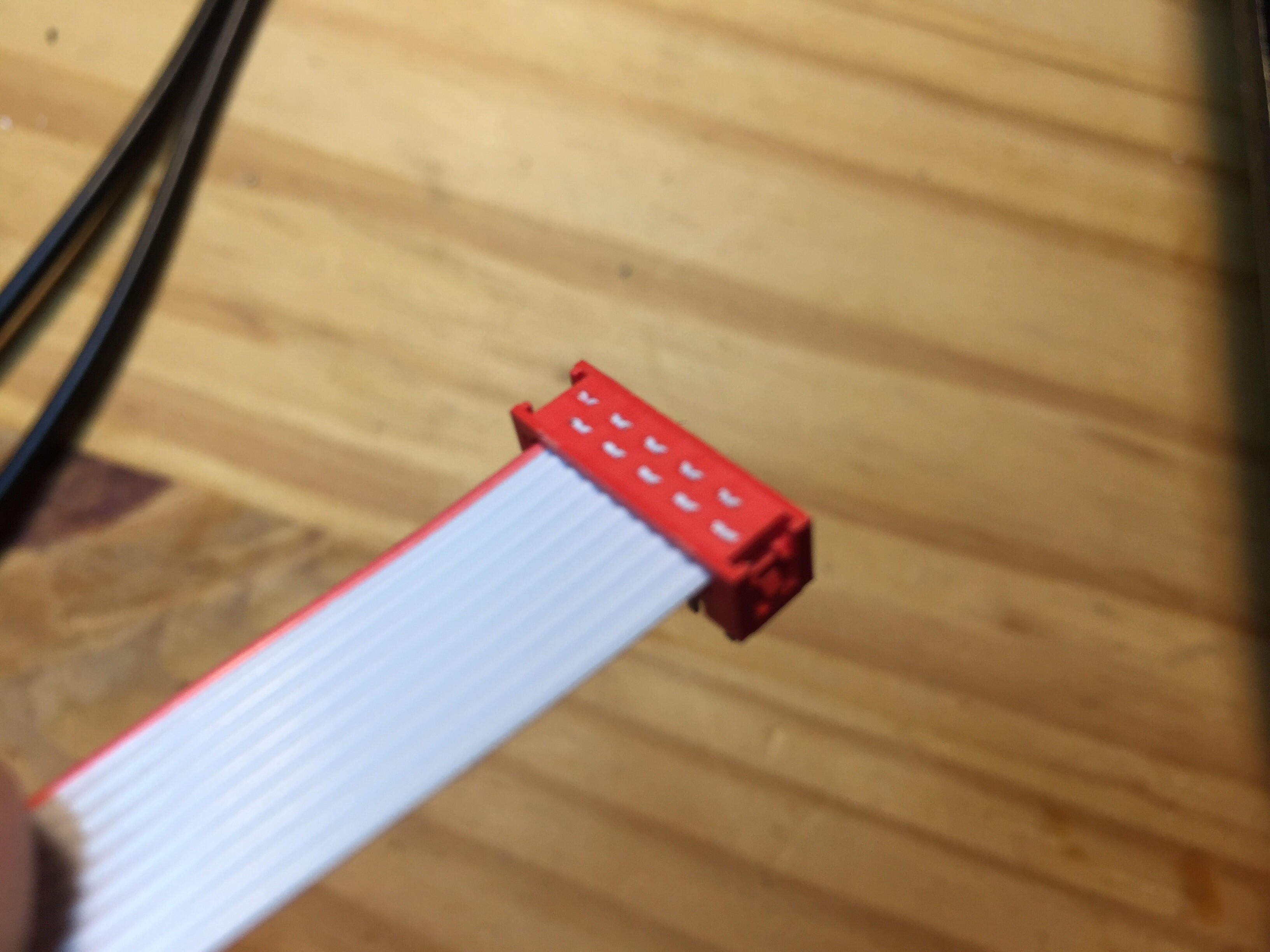

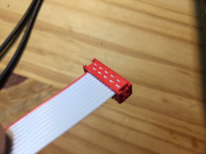

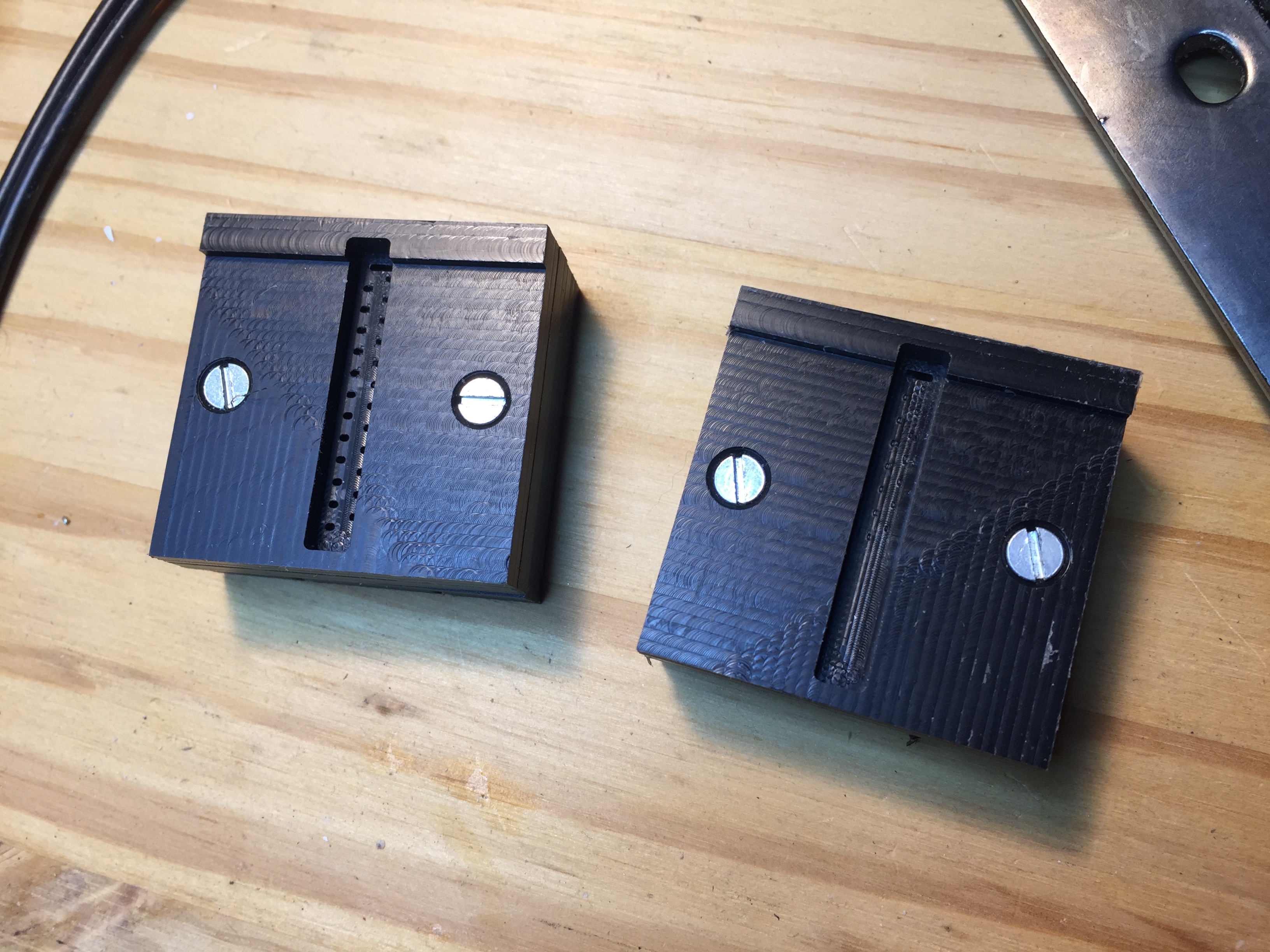

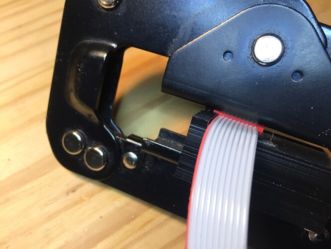

At the beginning I destroyed a lot of micromatch by wanting to crimp them with a vice or an unsuitable pliers.

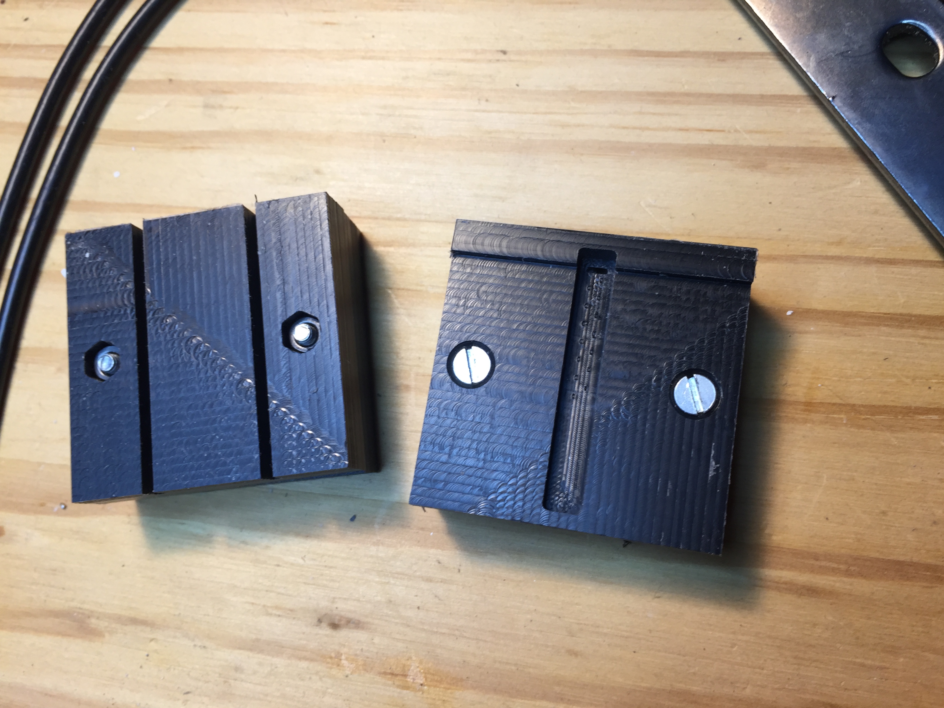

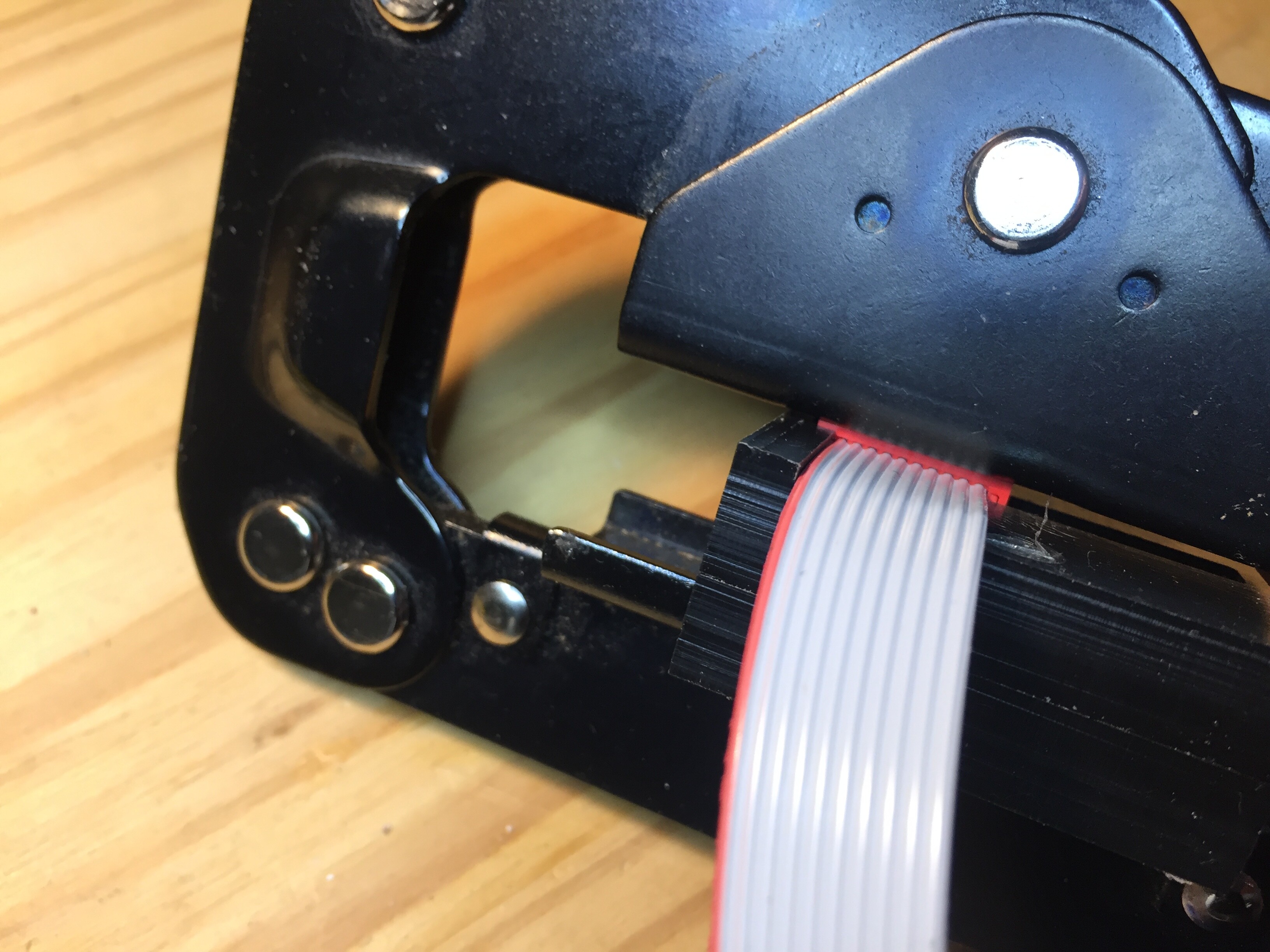

The official crimping pliers, probably solid gold, is extremely expensive, so I made adapters for the classic 10€ IDC crimping plier.
there’s a ribbon guide, a male and a female adapter. It works for all type and pin number.
result is very clean!
Here the drawing, it requires a small CNC to fab it.

Very good cause it tests continuity and short-cut, Great!

no worries, no harm done! A specialized crimp tool is also very good idea - everything that makes cables better! If you don’t have a crimp tool with replaceable insets, at least the wirescanner can test the built cables reliably…
In the early days of building MB6582 display cables, i tested every pin 1:1 with a digital multimeter and with that time-consuming method probably still missed out shorts to neighboring wires! :slight_smile:

I have the same “IDC crimping tool” but favour simply using a bench vise. For micromatch MOW cables I leave the polarising tab outside and it works well for me. If you have different tools that work for you, all good!
