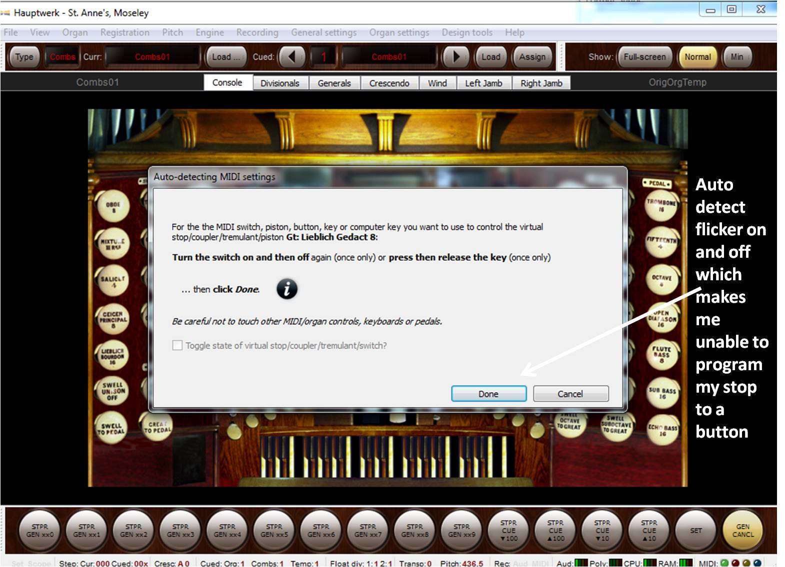

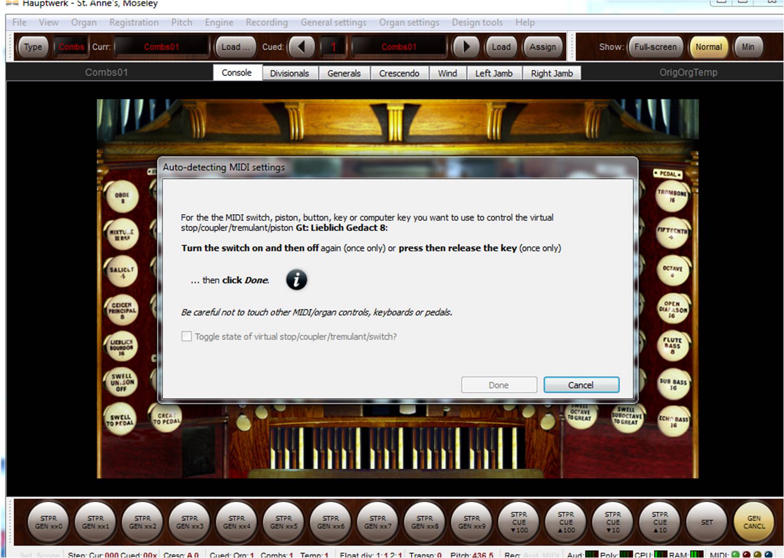

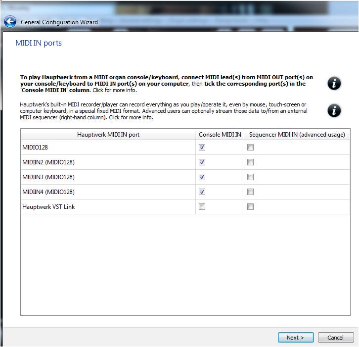

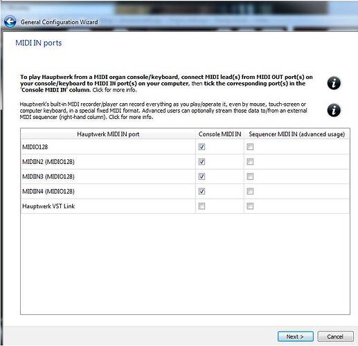

When Hauptwerk VPO is running on the midi configuration wizard screen I was able to see  Midi box devices ref picture.  when I loaded the organ and tried to configured my piston, I wasn’t able to auto-detect the piston.

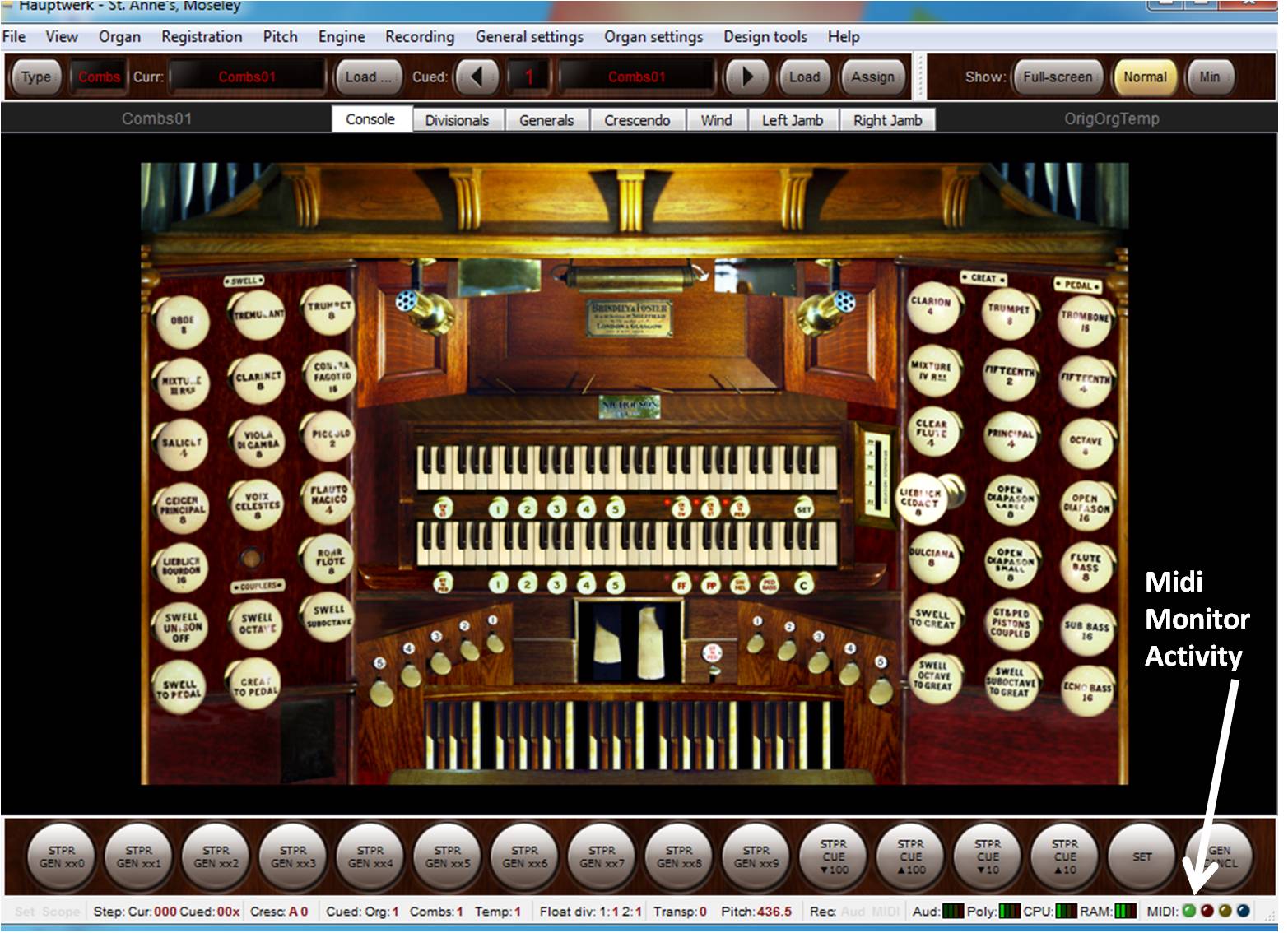

Thanks for responding latigid on. I followed the wiring direction for 8x8 buttons ( mbhp_din_8x8buttons.pdf ) I just realized that I never connected the required  “All Diodes: 1N4148” to the buttons. After rewiring the buttons and soldering the Diodes, I connected the controller to Hauprtwerk Virtual pipe organ sofware, and the stops on Hauptwerk kept turning on and off not allowing me to set each stop tab on Hauptwerk with my buttons. On the midi monitor at the bottom of the Hauptwerk main screen that shows midi activity. The midi light stays on. Normal operation, the light should come on and off when a button is depressed.  Any help
