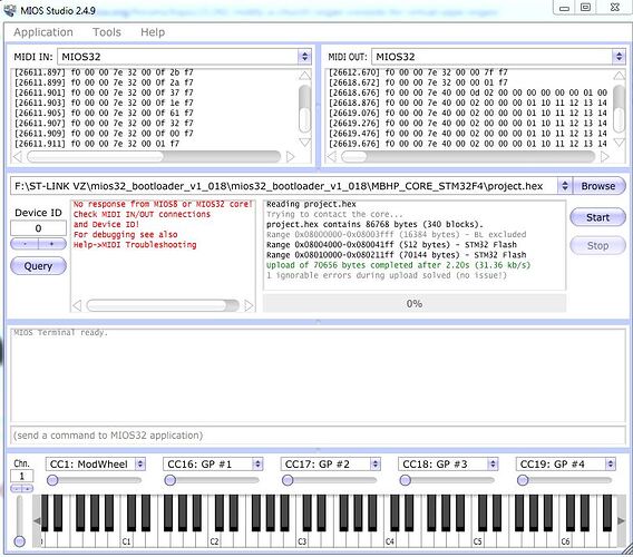

I have 4 DIN,  4 DOUT, Midi IO, and MBPH_DIO_MATRIX_V1; all fully assembled and a  MBHP_CORE_STM32F4 module for converting an old Church Organ to play Virtual Pipe Organ using Midi. I have Download all files such as MIOS_Studio_2_4_9, en.stsw-link004 Utility, en.stsw-link008usb drivers, mios32_bootloader_v1_018 and SetupSTM32CubeProgrammer-2.4.0 all of which are installed. I followed the direction on http://ucapps.de/mbhp_core_stm32f4.html. with success with the  exception of running MOIS Studio Please look at the picture below and I attempted to run Mios Studio

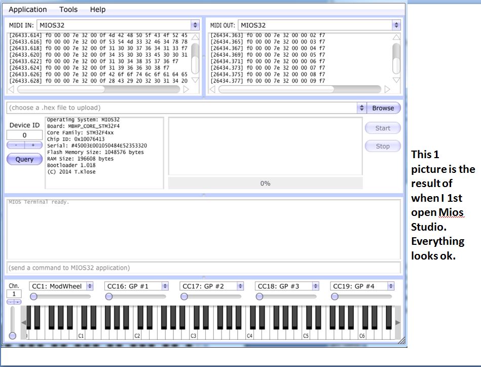

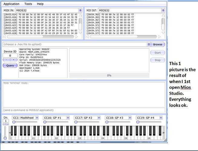

This 1 picture is the result of when I 1st open Mios Studio. Everything looks ok.

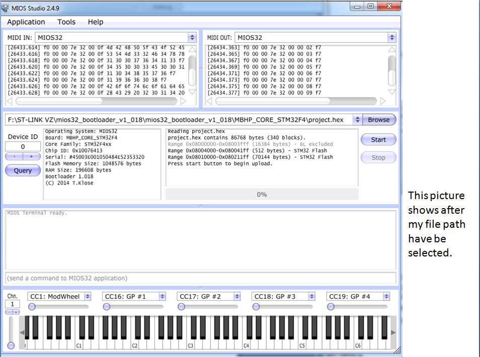

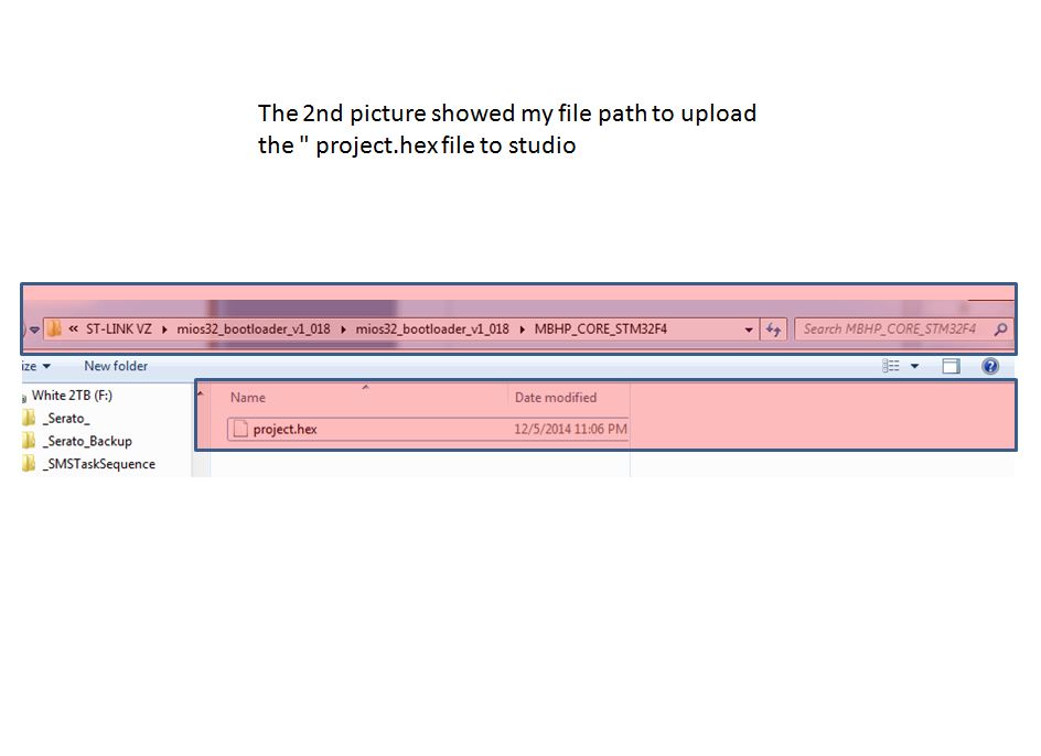

The 2nd picture showed my file path to upload the " project.hex file to  MIOS Studio
This picture shows after my file path has been selected.

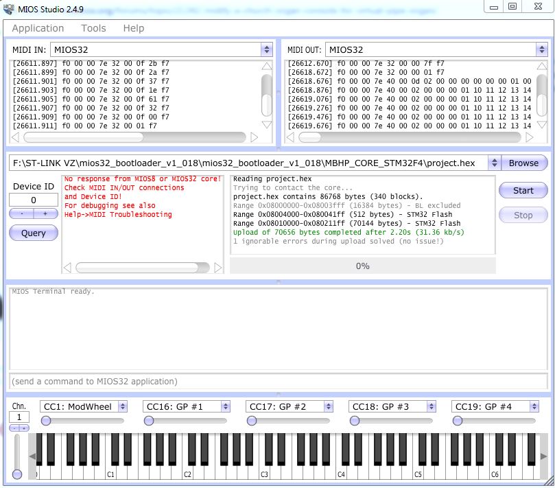

The final picture shows the result after starting the upload
The only device connected at this point was the MBHP_CORE_STM32F4 only. Please help me. I am completely new to this. Do have to  module connect the organ keyboard prior to monitor the midi msg.
