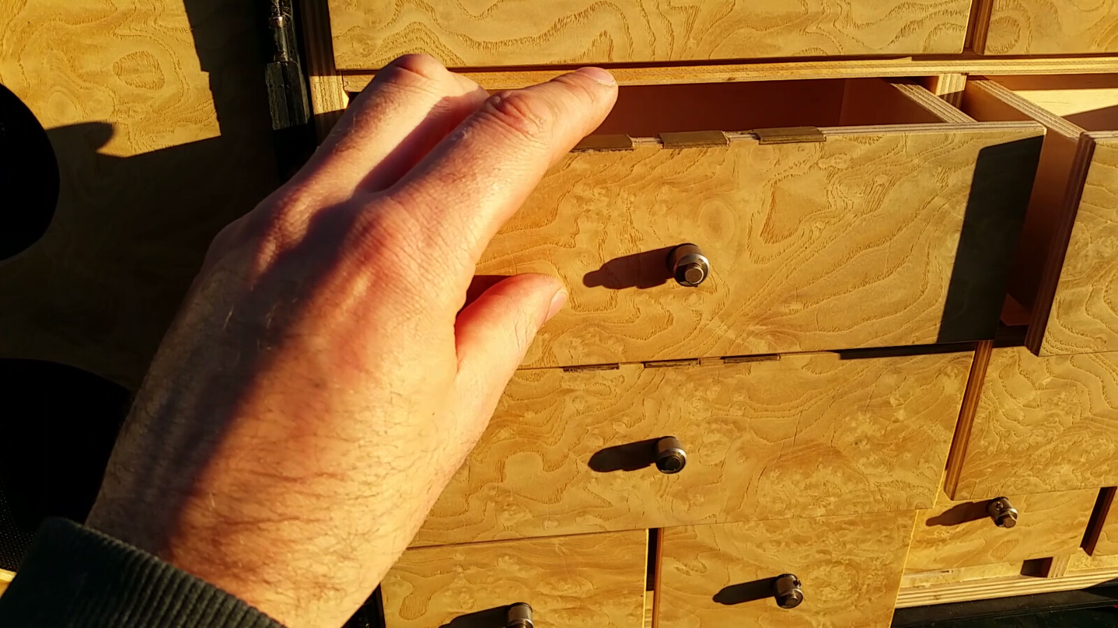

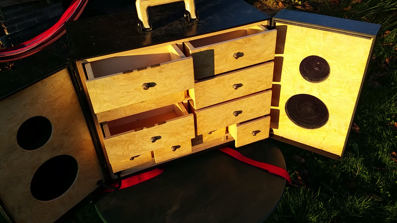

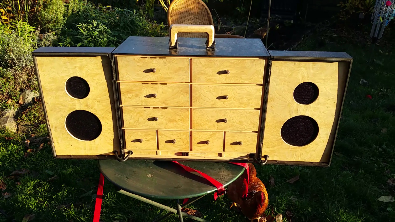

One of my biggest project so far: the Klankkast! (dutch for resonator box) It’s just a drawing cabinet with a simple HP computer in side, running Ableton with some Max4Live stuff controlled by Midibox!
It’s an educational instrument for schoolkids to start improvising. I builded it togher with Martijn Koomen (he did all the wonderfull woodwork) for an educational institute in the south of the Netherlands.
It’s a MIDIbox NG (stm32F4) for all analog input, sliders and pots, and the touch tips are connected to a Core8 running MIDIO128 V2. Special thanks again for TK for pointing me in this direction!!!

I’m curious about the speakers. Have you put much effort/moddeling into getting the design of the box right? If so, how did you go on about this? I’m asking as this is something that is on my to do list.

For the speakers I didn’t put any effort into the design. I just searched second hand sites for ‘flat-speakers’ and found Magnat S-10 speakers. They were flat, sounded good and had enough power to give the sound body. It worked out well, only some resonating thrills on low sounds, but that’s just the woodwork.

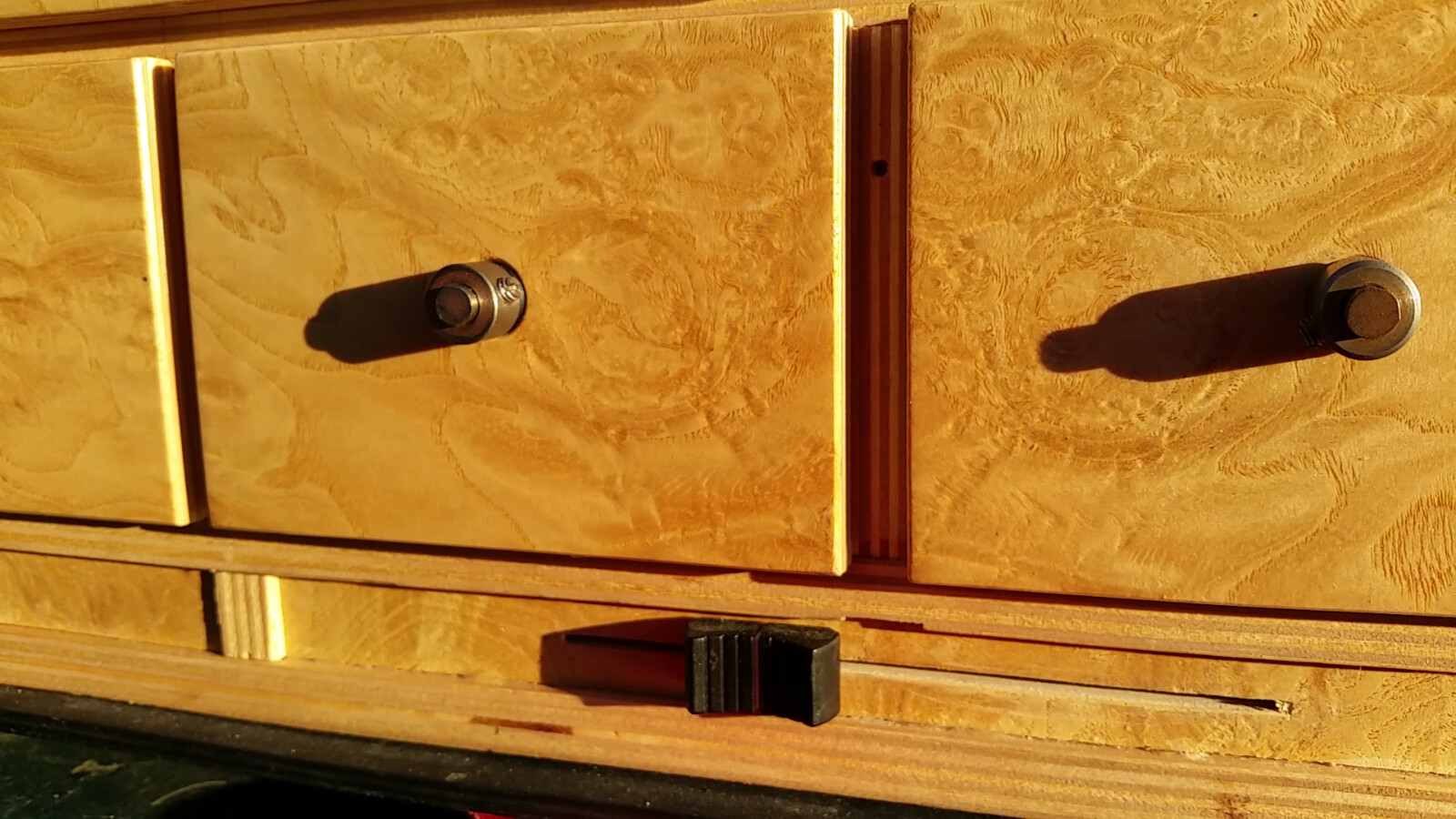

It just need a wood knob at the fader
