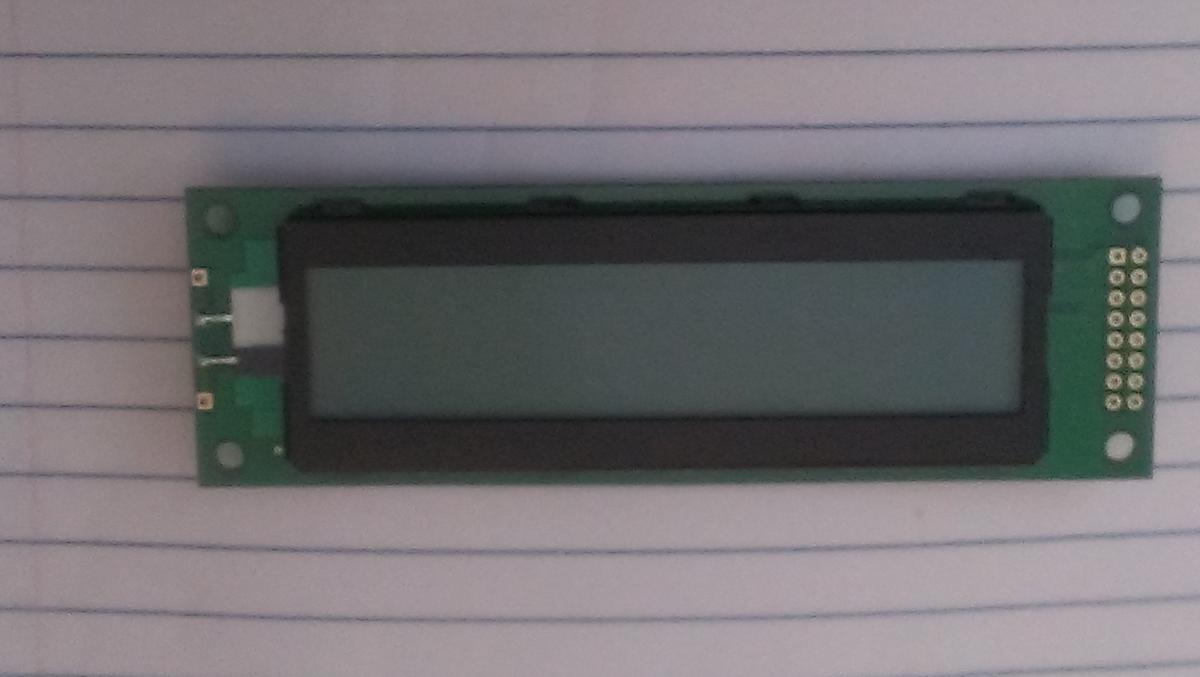

Hey everyone! I have been working on my SID synthesizer for the past couple months. I have the Core and SID modules (that I got from SmashTV) assembled, and my parts for the minimal control surface finally came in the mail.
I have attached images of the 2x20 LCD that I will be using. The problem I am having is that I do not know where to go to find documentation on how to wire this display up so that it will function with the rest of my modules. I bought it assuming that these universal displays have some sort of standardization. Given that you guys have set up an LCD display before what would you suggest?

Regarding the display: I´m having difficulties finding a proper datasheet for this one. It might help if you told us where you bought it or, better yet, you contact your suplier yourself and ask for a datasheet.

I ended up finding a datasheet for a 2x20 Densitron display with the same physical dimensions as the one I have. Even though the model number is not the same I plan on using it anyway.

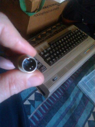

As far as the power supply goes I now realize there are no 7 pin C64 PSUs in circulation. Everything on ebay is the 4 pin type which will not match up with my port that I will get from my C64. I think using this solution will work best for me:

I just wanted to point out something you mentioned earlier in the thread. You said all the eBay power supplies are 4-pins – ALL C64 power supplies are 4pin, they just use a 7-pin connector. At least in North America this is true. The top 2 pins are +9VAC, the bottom is ground, and the one to the left or right of it is +5VDC.
See pics attached of mine!
I see. The pins are spaced so that even a 4 pin connector will fit into a 7 pin port.
