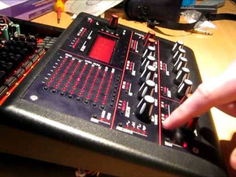

also, your MBSID drum demo still beats all of my youtube videos regarding views! :slight_smile:
Bad friend! :slight_smile:
Hehe!
Many greets, Peter
For some reason the channels cancel each other out, I used an iriver H340 to record that demo, so if you’re listening to it on a mono device like a phone speaker you hear nothing!
