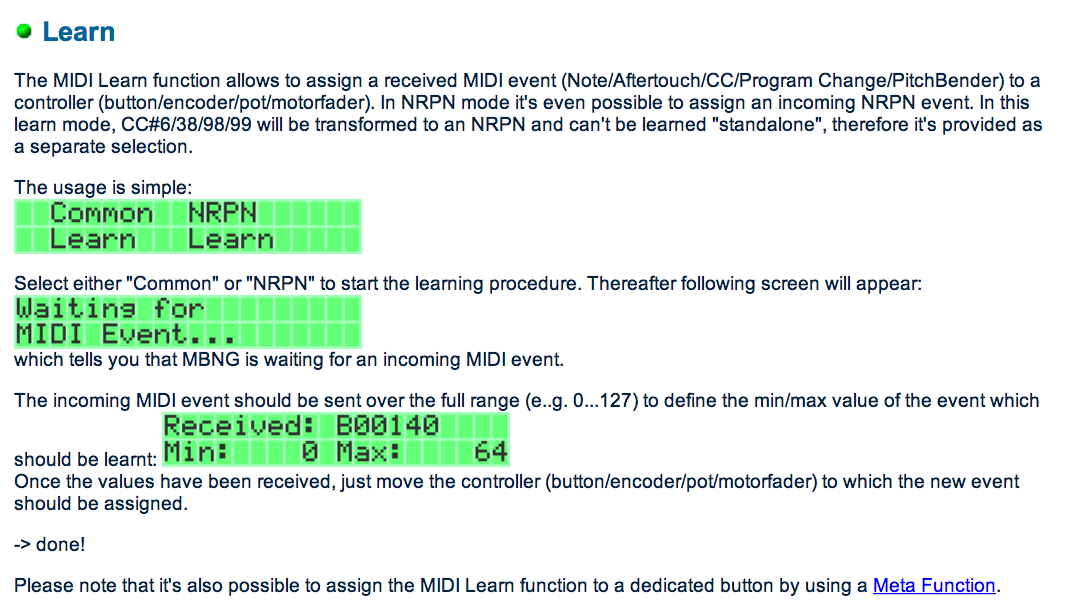

Anyway seem : Yes it can “Learn”
(unfortunately as for so many other more option no sufficient info for the not “Experts” )
ps:
“untested”
Seems fairly self explanatory to me and certainly not for “Experts”.
Whats so expert about turning a knob from left to right so the MIDIbox HUI receives it?
