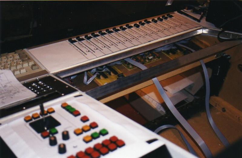

So I make some knobbox ,some midi merge,dismantle some cheap midi keyboard(to keep switchs midi note on),
and make and test a lot of different audio circuits.

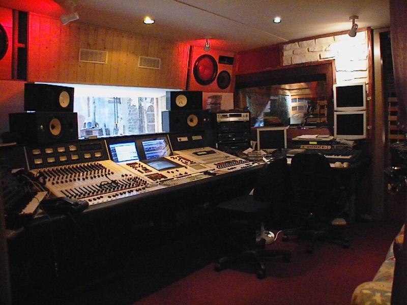

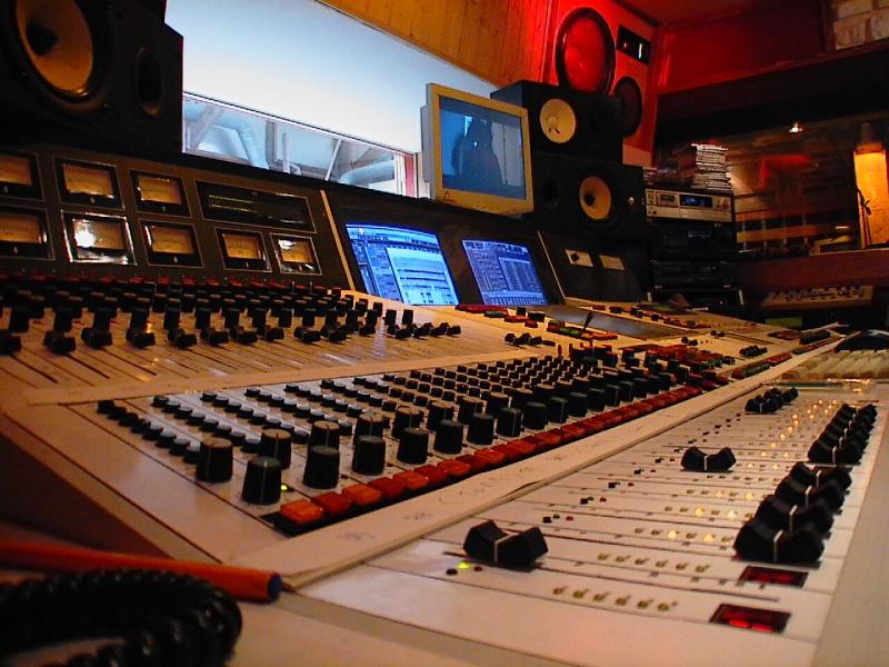

The Zconsole contents:
    32 monitoring faders
    32 mutes
    32 solo
    32 EQ in
    32 Dynanic in
    32 selection chanel
    16 input mic/line
    16 motorized faders (for eq/dyn/aux/and other controls)
    4 fader group    (you can virtually group faders you want by selecting on each channel)
    1 fader master
    talk-back manual or auto (switch when the multitrack stops)
    monitoring with differents inputs for HP and headphones independant.
    oscillator
    a lot of fonction switchs…
    etc…
