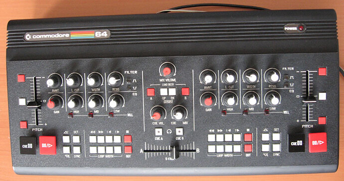

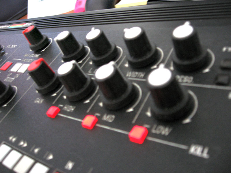

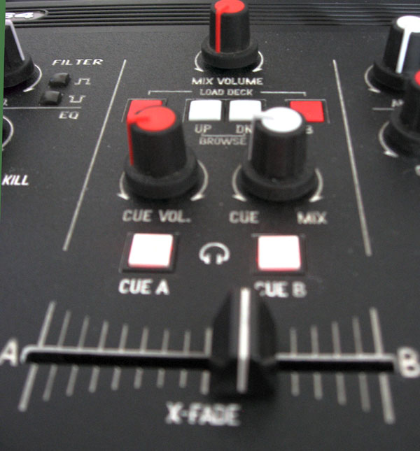

If you want to make your panels easy and inexpensive pay atantion on this great marterial I used for my panel. In Serbia, I payed 65x65mm sheet about 20 Euros and cutting/engraving in 500 lpi resolution cost me about 12 Euros including cutting the base 3mm acrylic. http://www.rowmark.com/laser/Textures/textures.asp
It is local engraving service, one of the tens existing in Belgrade. Evry express stamp service use that kind of laser cutter/engraver. Check any of these in your city.
Really lovely box, especially big respect for *ALL* those little details, excellent and very very very nice work (you can feel the effort behind it for sure)!!
Man your box is superb, very very very nice, am realy impressed, currently am working with your technique for the backlit buttons using round cast acrylic, and now am thinking instead of silkscreen it, I will go your way with that material, I hope you don’t mind.
thats a very tidy bit of work indeed.. and nice to see things other than sids in Commodore cases
Damn.. forget fiddling on with lasertran (for now..) ..next few project pannels are going to be done using a sign maker service.. the finish is so unbeleiveably professional
..now the mission is on to try to find a local place thats afforable in the uk midlands..
…that inspires me actually ..if i build a control surface for my mbsid+mbfm (those have been waiting for completion so long, its become a joke..) ..then im definately building it into one of these cases
